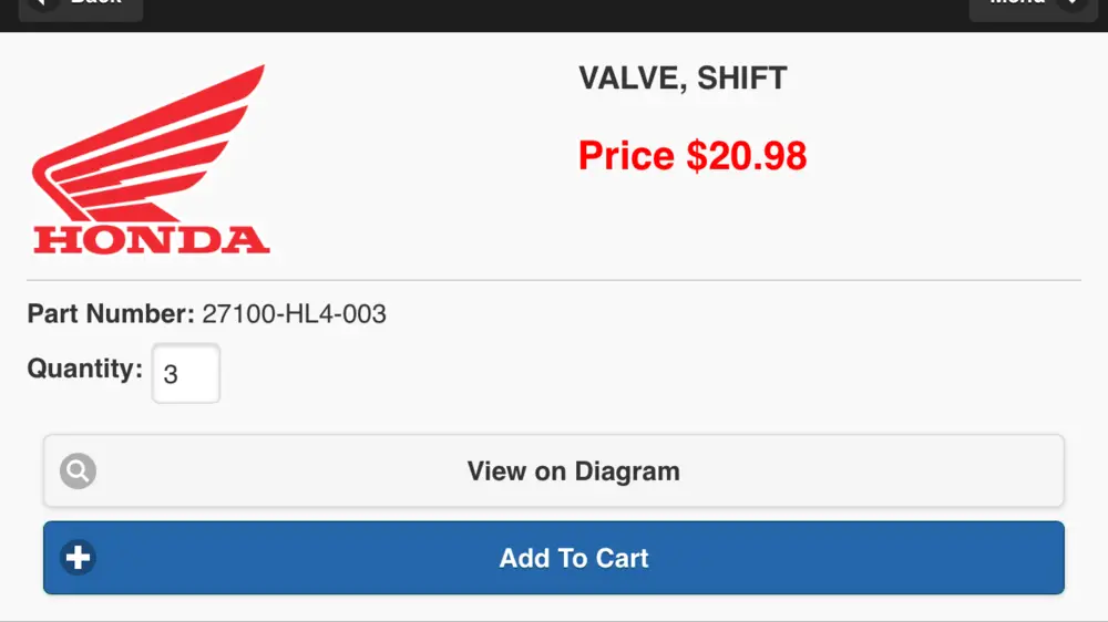

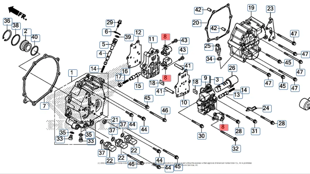

Looking for the oil relief valves and wondering if theses are the ones...

Wonder why theres three, instead of 2 or 4?
