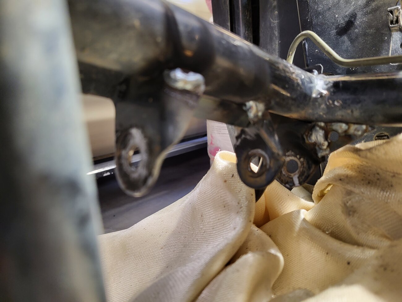

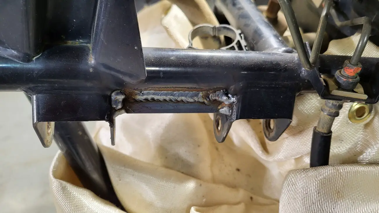

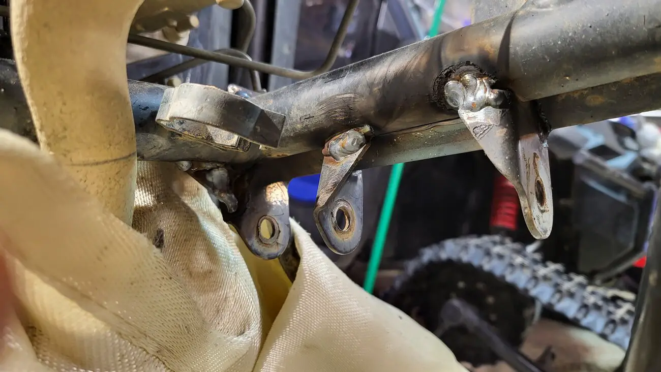

On the p5, are there any places that need gussets or strengthening on a arm mounts and such? Common problem areas?
Brother is a professional fabricator, I can cut on plasma table or handmade gussets.
@futzin could probably help you out with that question.
My short answer would be: probably not. @906UP is the better person to chime in.
Uh....yah, especially if Dammit Kevin is at the wheel!
20231203 122218
20231203 122200
20231203 112446
On @futzin Critter I welded the backside of the upper A-arm mounts, added a gusset to the rear and connected the F & R together. Much more stronger now :cool:

Well got to give Futzin some due here. Most P5 owners dont send it like he does
^^^^True Story!!!! ^^^^
In most cases reinforcing the front end isn't necessary, @futzin just hit something just right to bend his. In this case it was just the upper rear that got tweaked. Once I got it straight I added the gussets so it wouldn't bend again in the same spot.

My fab guy/ brother by choice/ best freind/ , works for free! I will probably gusset uppers.
Tires are here, almost got stuck rolling em into garage. What shallow tread, lmfao
SaweeeetView attachment 422337View attachment 422338
FYI, Honda doesn't weld the backside of the mounts. Once you get it apart you'll see what I mean, welding that alone will drastically increase the strength.
