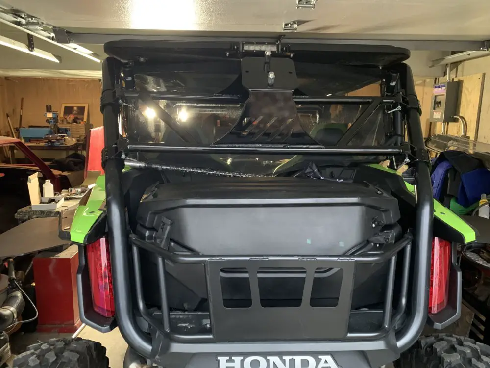

Although a bit cheesy, I'd just run a rope from the top of the ROPS behind the driver's head to the JEI so it couldn't open all the way. Another member recently added a gas strut to help with the lifting but I'm not sure if or where it stops the opened angle.
I’ll probably weld stops on the hinges and re powder it down the road, I think it will fit in my oven!

I just wish it had a stop in it so it didn’t open all the way that the tire sits on the fender.
Mine doesn't open all the way to the point that the tire hits the fender... maybe try adjusting the hinges towards the inside of the bed more?
Hmmm reverse the hinges to go under instead of over. Good idea

I looked at this system, I like the concept but don't like how it restricts rear visibility
On a SXS with restricted rear visibility as it is. It is a nice product though.

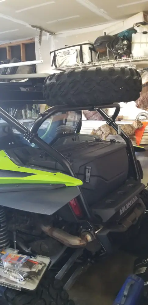

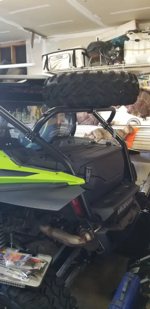

I went with the Tusk. Here are a couple pics. 32” tire. Rocks and trails RZR in the pic has 30” for comparison. The mount can be adjusted to set the tire flat or higher by 2-3” for more cargo clearance but I like it as low as possible and angled. So far my stuff fits fine.

How much clearance does it leave below the tire and or lowest bar? Looking to keep my current box and this may work but it may hit the lid? THANK YOU
Sure thing, let me know if you need more measurements.
From the lower bar on the mount it is 19” vertically to the bed. The bar is 17” horizontally from the seam behind the air box cover to the bar. Not the cover but the full length seam behind it. There is 24” from the lowest point on the tire vertically to the bed. If the tire was adjusted flat and all the way up it would allow 2” additional clearance..

I like this because it allows better access to whatever storage box/system you might have. But I don't see what keeps the tire from rotating backwards in rough riding. Is that a problem, has the weight of the tire caused the vertical piece to rotate?
I looked at the Factory UTV mount as well and decided to go with the Tusk as it is a lot beefier. It also lets me keep the tire a little lower and I plan to mount rear lights on the crossbar. With a 32” spare I was concerned about a single attachment that was only clamped. The Tusk also has 4 studs to secure the wheel and is adjustable for different offsets. I’m sure the Factory UTV mount works well and the selling point is it offers more bed clearance and rear view visibility but the single post and overall height was a concern for me.
I ordered the Factory UTV version because of the extra bed access it allows, still waiting for it to show up.

THANK YOU - that will help. Need to make some measurement tonight. I appreciate you taking the time!

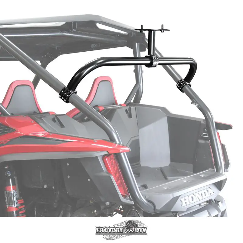

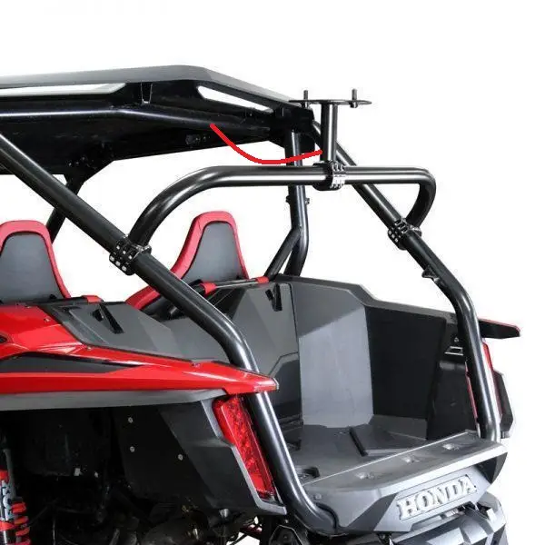

Help finding a spare tire carrier I swear I saw here and now I can't find it. There's little doubt that the JEI and Tusk are the most structurally sound but both limit access to my TSC storage box if not eliminate it completely. The JEI swings open but I'm not 20 anymore, getting that thing open would be a struggle at best.
So I'm looking for something with as much be clearance as possible, like this one by Factory UTV, with the addition of the brace to the ROPS I've added here in red. I know I saw one. It's my concern that this one will tend to let the tire rotate, forward or backward, when the going gets rough, maybe not but the additional brace would prevent that entirely.
Photo thanks to Factory UTV.
This mount is rock solid and mine has not moved a millimeter. After 300 miles of trails easy and extreme or spirited driving.
Thanks Nemo, that's good news. If one with the additional brace was only in my imagination, I'll get the Factory UTV piece and not worry about it anymore.
Be careful when mounting to cage it is easy to scratch the cage. So have someone help.
Thanks. 👍 Another question - since our cages taper in to the taillights, there's only one specific location it will fit - I can't move it up or down an inch or two?
Very specific due to very precise tight fit.

As I thought. Not a problem, just checking my geometry skills - thanks again.
