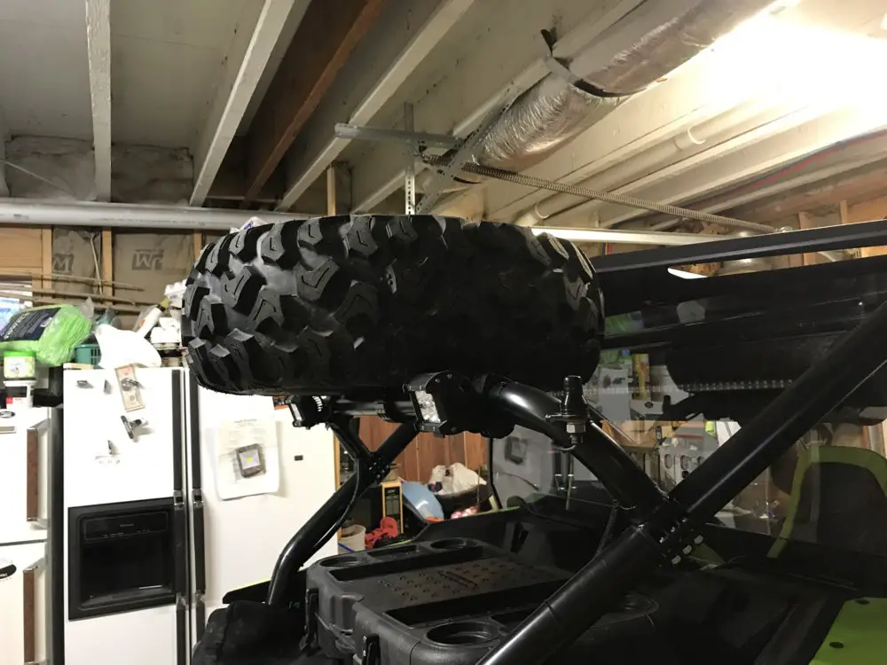

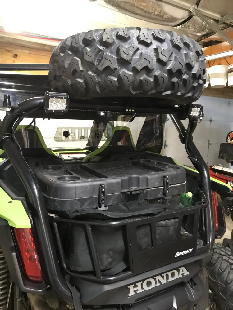

Thanks Mudd-man. I have a similar storage box and your second photo shows I'll have easy access. What rim and tire is that? If not the stock front, did you have to specify something different or is that off the shelf?

You will need the aftermarket lugs that are smaller for it

It’s not the same tire and rim in this picture but what they sent works

I used turn bucked to attach the box Straps kept breaking. And it’s easy to remove

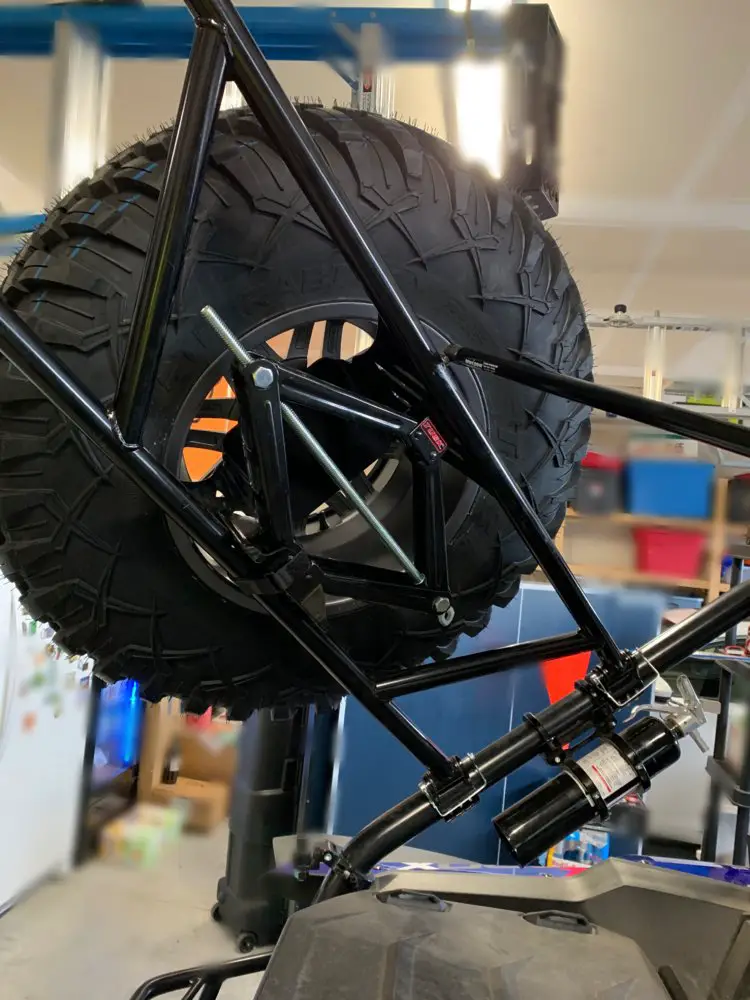

My Factory UTV carrier -

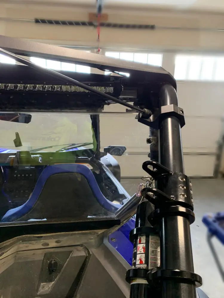

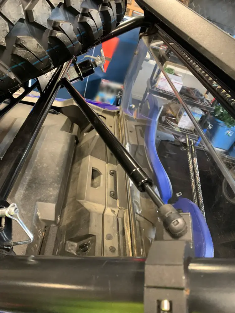

The TSC 32" storage box clears easily. I copied TerryH's install, all the details and video are in his build thread.
