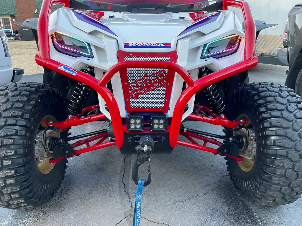

the heck with the cnc bender, tape measure, angle finder, tube bender, weld machine, drill press, beers, $100 in tubing, long Saturday at my buddy’s - poof - 1.75” - .120 wall tree kickers…..
powder coating took longer 😂
