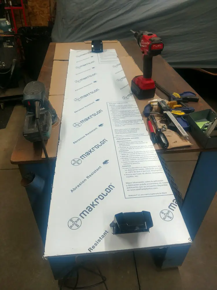

Call me crazy but I want a little more wind protection for ice riding but I don't want a full windshield or a cab. To me the next best thing is a tinted cab visor.

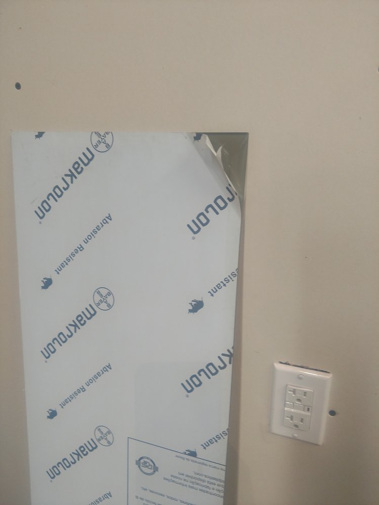

My Makrolon AR came today. The tint is exactly what I was hoping for. 62x12x 1/4"
Raw material

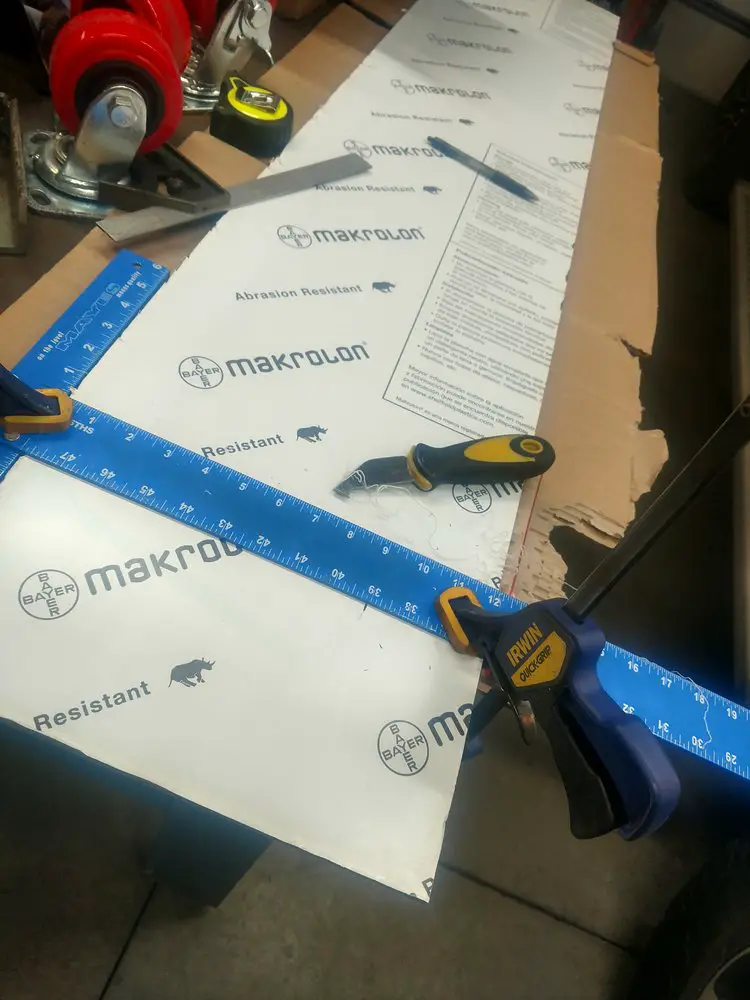

Layout work with cardboard
Material getting cut down to 54.25" wide

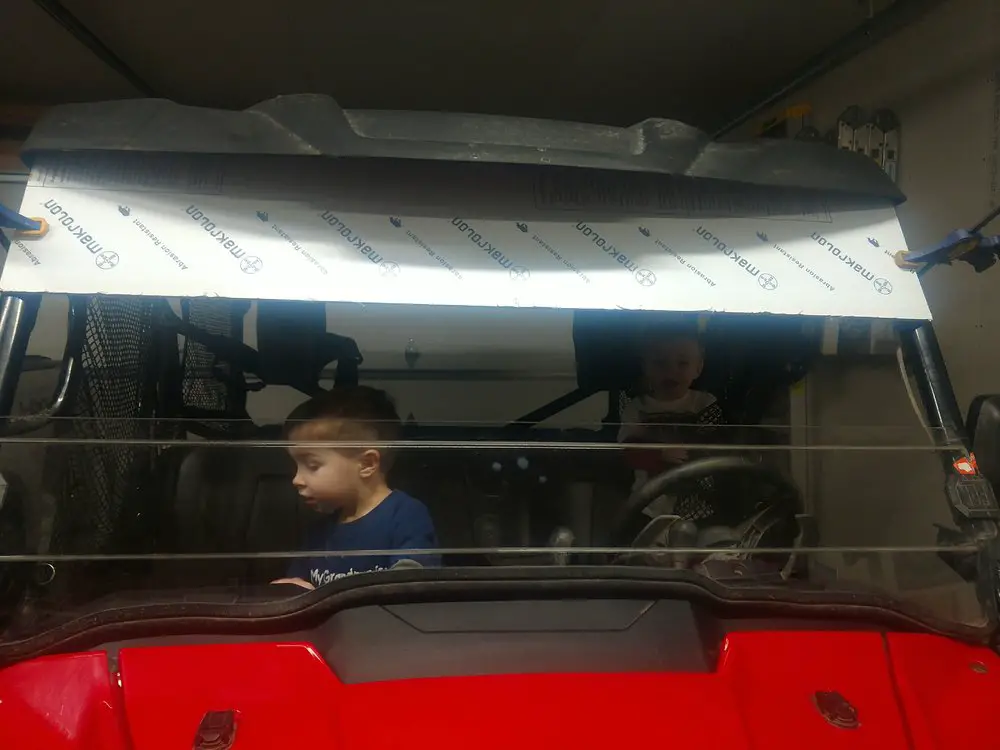

Material test fit. Visor will have 2 bolt on clamps across the top and 2 clamps on the side. Parts are still on order.

No. There's a small gap above the tube but the visor is even with the top of the roll cage

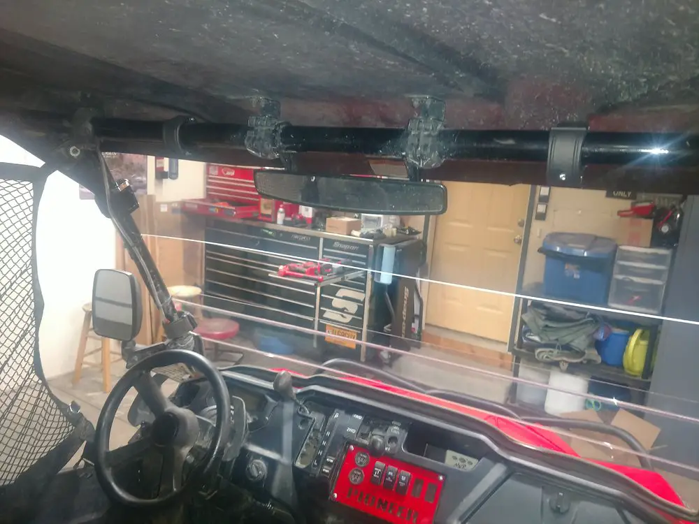

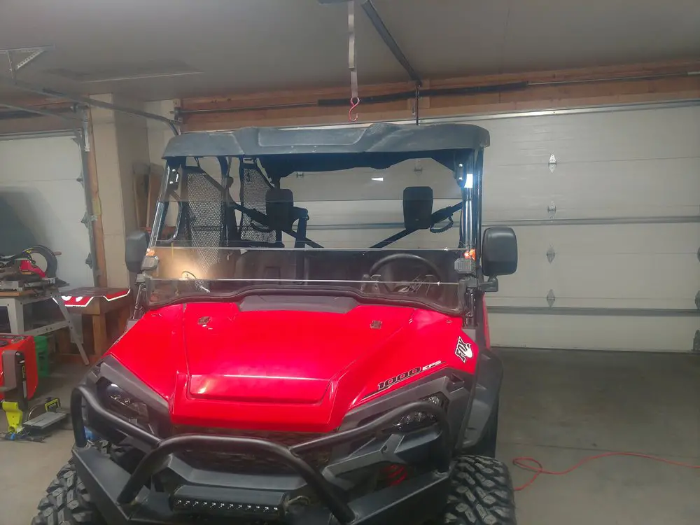

Here's an update on my windshield visor. I ended up with 2 Arctic Cat clamps (sides) and 2 Amazon clamps top. The AC clamps ratchet which allows the windshield to slide in from the side, clip the AC clamps and then install the top clamps.
Marking the mount holes for the Arctic Cat clamps. It's easy to be nervous working with clear plastic but it drills really easy once you're through the hard coat.
All mounted up
