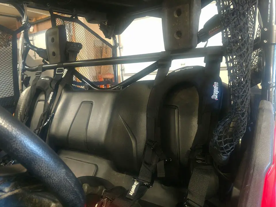

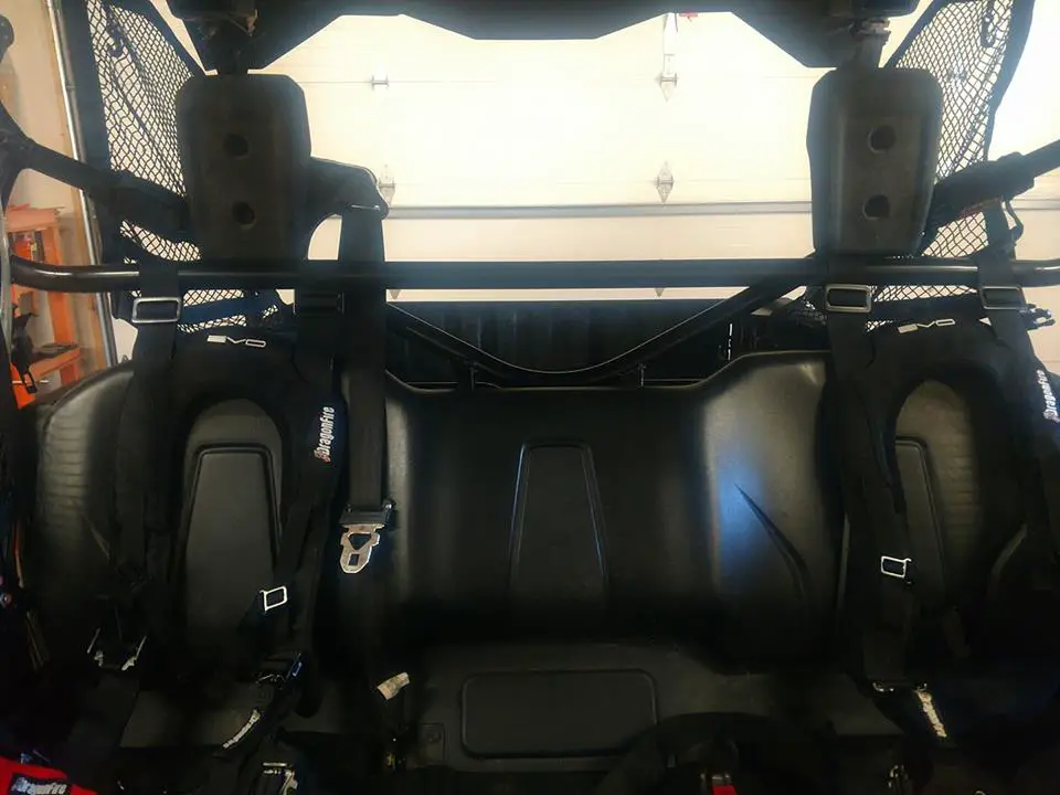

Now that BCF makes a 1 piece bolt in bar, I swapped out mine for a bit more head clearance on the bar. I do think the previous height was better but the BCF bar is further from your head and neck.

Not the "HEAD BANGING" type?
I didn't have an issue head banging on the other one but this won't require relocating the headrest right away. I may still move the headrest forward 1/2-3/4"
