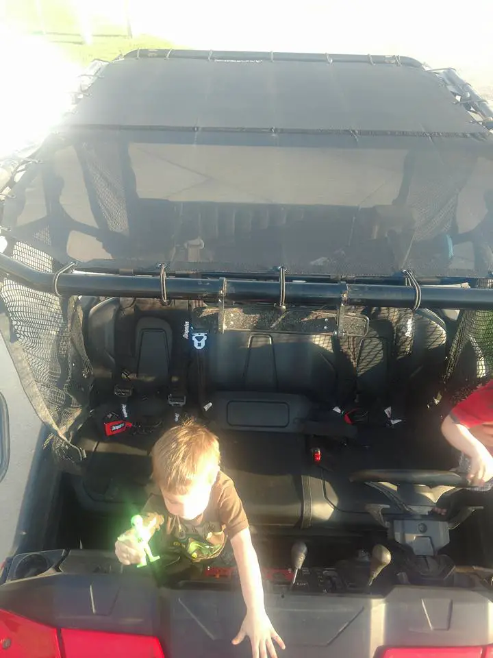

Latest upgrade for summer is the Alien Shade soft top. This thing rocks.
Tight fit and no flapping in the wind, lots of ventilation. It does let water through but it does a great job letting air through and blocking the sun

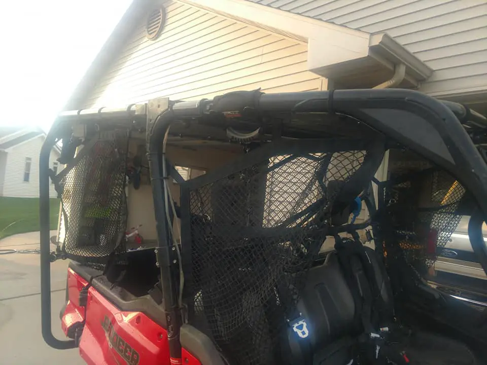

It fits tight to the top of the roll cage and installs with about 20 bungees

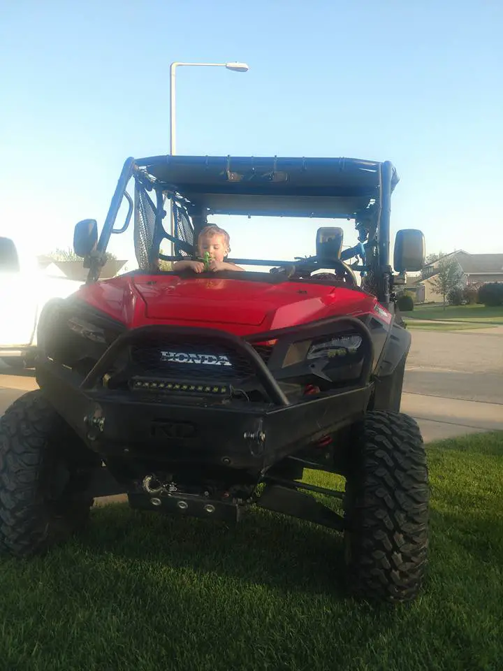

Review on the Alienshade after 200 miles is "Awesome, great purchase!"
Less wind noise and cooler in the cab. It also doesn't create the water fall effect when water splashes under the Honda hard roof.
The next few pictures show that in deep mud the Quadboss QBT 846s aren't quite as good as a pioneer on stock big horns for muddy traction. Otherwise I still love the new tires.

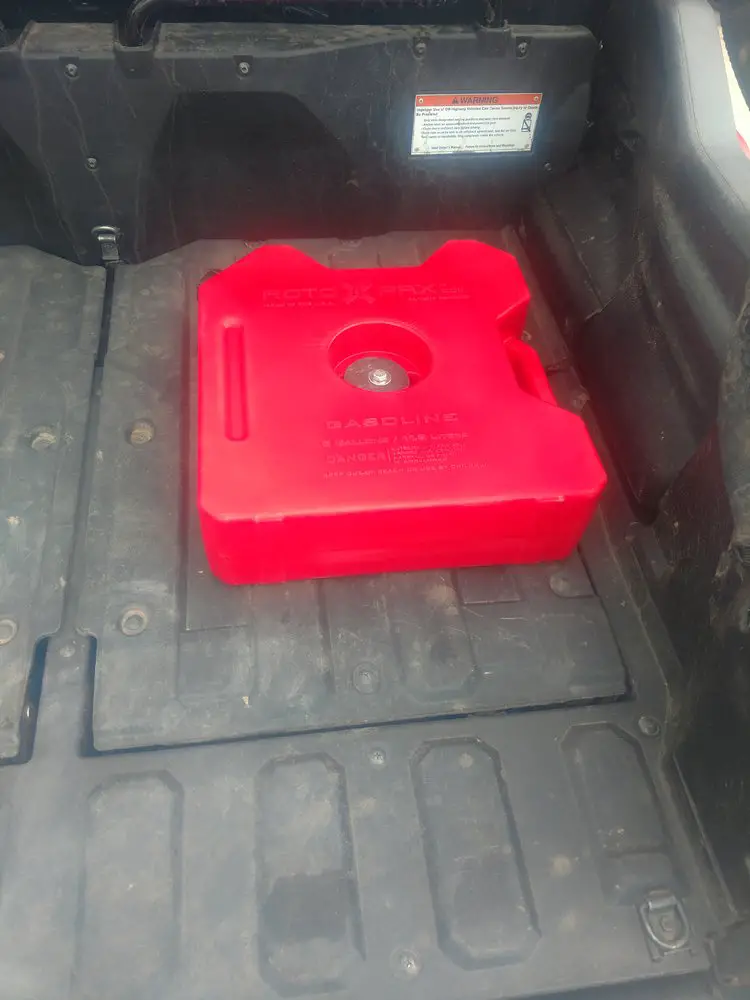

Since I have my machine apart for maintenance, I also took some time to make some improvements. I'm working on a 3 gallon gas can mount for between the seat back and the bed. The can is a 3 gallon Rotopax and it's a beefy fuel rated can. I'll provide more feedback after it has a mount
