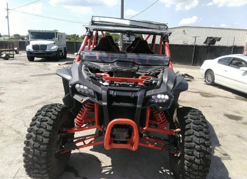

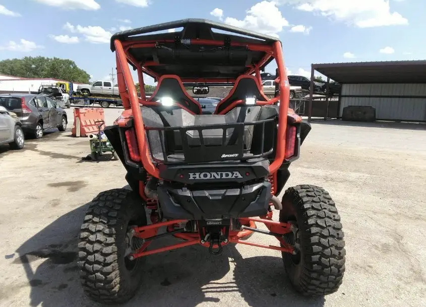

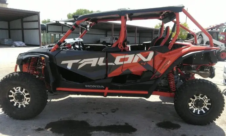

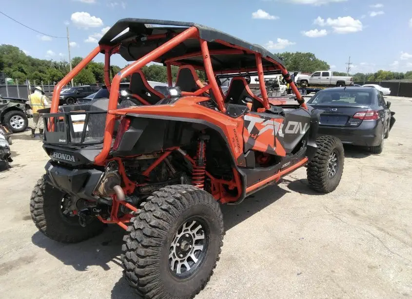

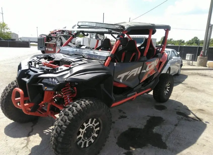

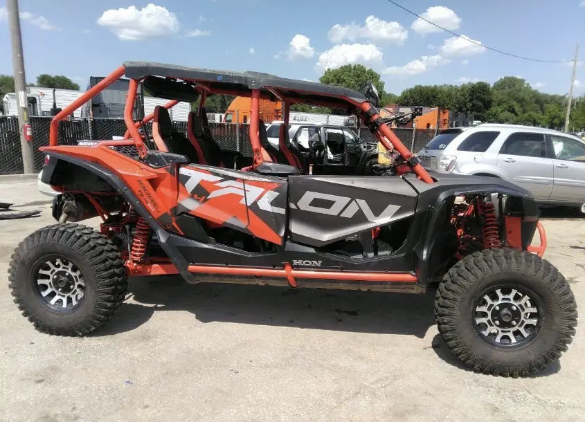

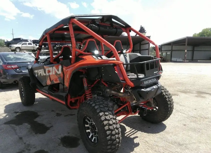

So I’ve been kicking around the idea of a talon x4 for a bit.
Finally pulled the trigger on a rebuilder. Found one that was laid on its side that appears to be workable. Odometer shows less than 900 miles and it’s a 2020. Wanted something a bit newer but it was hard to pass on the price.
Not my first rebuilder ( mostly cars and trucks) but my first rebuilder toy.
Should be a good project for my side business to make parts for etc.
Hopefully I’ll see it in a week or so to see what is really going on with it.
View attachment 424095 View attachment 424096 View attachment 424097 View attachment 424098 View attachment 424099 View attachment 424100 View attachment 424101 View attachment 424102

I’m pretty positive everything on the nose will work. If needed I wouldn’t be afraid of using that front post section from a 2 door or an R if you found something.

Well it’s here in all its glory.
The good
Got a really nice set of rock a Billy tires…I forgot to check the size but definitely taller than stock.
Most of the lights work except for the light bar as it’s smashed.
Starts runs drives without any codes so far other than blinking power steering light. (Battery was bone dead)
Interior is in great shape
Under body is super clean despite the gstring joke of a factory plate
Nice SATV windscreen, basket and rear hitch.
The not so good
Driver rear is toed in pretty badly. The control arm looks bent and one of the rods too. Makes the buggy want to dog track bad
Passenger plastics are so so. Maybe I can find some replacement panels but the will work for now
Missing the front hood
The Bad
The buggy was on its top and passenger side. Originally I thought it was just a flop…the factory cage is kinked at nearly every t joint…by the time I pull it back and make new gussets and clam shells it’s looking like I’ll be over halfway into a take off roof. I know of a take off for sale on fake book but it’s outrageously priced. Good news is that everything below the bolted connectors isn’t kinked and could be pulled back. Maybe I just cut out the connectors and make a new cage not sure yet.
Fo sho I took it for a rip around my pasture a few laps after I checked the fluids and jumped started it!
That god forsaken gas pedal sucks donkey balls and because of it my knee rides right on the ignition switch bubble…not sure what I’m going to do about that. It seems at first look that there’s possibly a chance to move the pedals forward…but that will be for later I think.
