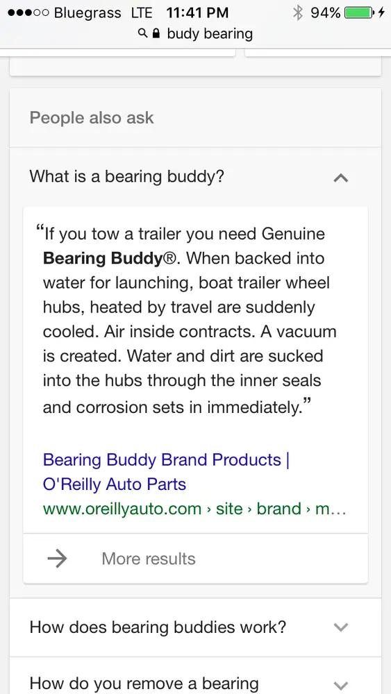

Isn't that basically what a buddy bearing is?
Drill and tap hub spindle for sert, make grease passage to area on both sides of bearing perpendicular to hub shafts don't use sealed bearings, that's how boat trailers hubs are made.
IMG 4512
35,445
208,731
No The spindle has no grease passage to put new grease right on bearing
