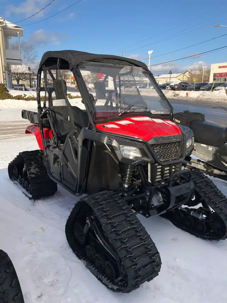

So for an extra $1800 he says I'd get these accessories less the tracks;
Winch mount, soft top, windshield, and box. Trouble is it cuts into my delivery costs (about $800).
I can do without the box ($300!), but kinda like the rest. Is the factory winch mount worth the $300 he claims it is? I can weld...
May have answered my own questions there, except for do I want a half windshield or full? Any advice on that? Lol

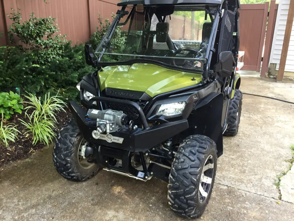

Consider a Strongmade or similar design front bumper, then bolt any winch on top. Solid front end protection. Being cold where you are and time of year, full windshield IMO. OEM one comes off easy with quick clamps. Also many options on rear box for less, heres a link if you haven’t seen it already. Check out Honda Parts King for US price comparisons.
P500 - Post your rear rack/boxes Pics.
Honda Parts King site. 2018 Honda Pioneer 500 Cargo, Honda Accessories
13DD3184 21D9 4ADA 994D B199DE3B643B

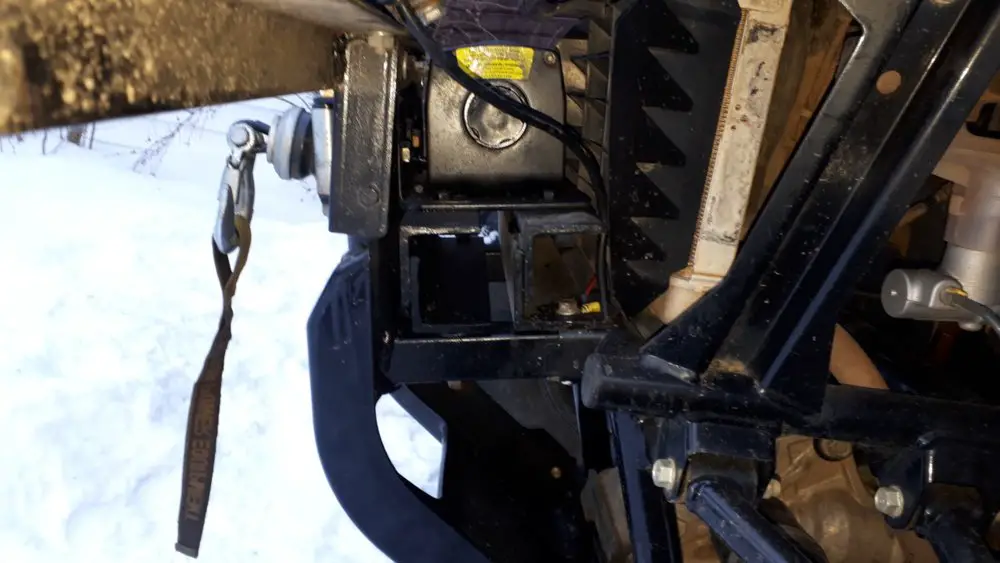

Sorry for the late reply, I couldn't remember who asked for this. It's 4 pieces of 2" angle, about 11 1/2" long, welded together to make the winch the right height for the fairlead. Make sure you drill the mounting holes before you bolt it on!
P500 winch mount

Thanks! Looks simple enough. I think I'd rather have it up higher like that, to keep it out of the mud and dirt. Easier to reach if the front is buried in muck. How about a rear mount? Anyone got pics of a diy rear winch mount?
