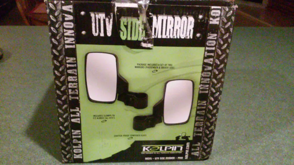

Kolpins are a great mirror at a great price. You'll like them. After having used them for 6-700 miles, IMO, they work the best mounted low, fold in when struck by brush if you forget to bring them in on tight trails, never broken glass, and I think they look the best mounted low.
36 hrs and on the porch...shopping in your underwear is just too easy! :DMirrors
36 hrs and on the porch...shopping in your underwear is just too easy! :DView attachment 25493
Beautiful! I hear ya on that. We don't have to frequent the brick and mortars much anymore. When you sticking them on? Seems like 10-15 minutes per side.
