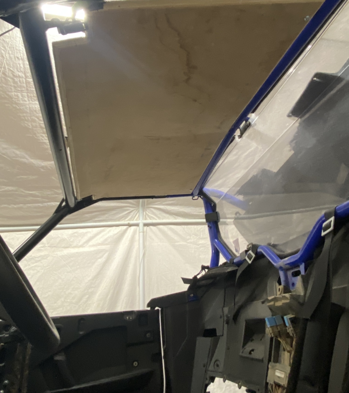

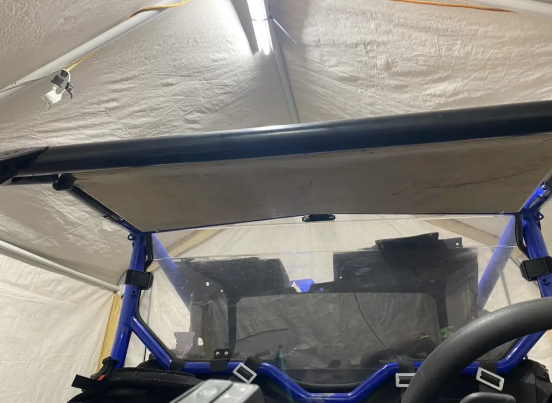

Got done at work tonight and straight home to the Talon. Here’s to the start of the headliner. Kind of a pita bending the center in the back 1 1/4” up and all way across front 2 1/2” down. Think I got it. Still crude but now follows cage closer.
I’m an auto guy so forgive me for using automotive grade materials on the 3/4 ply lol.

Looks good how deep will it be

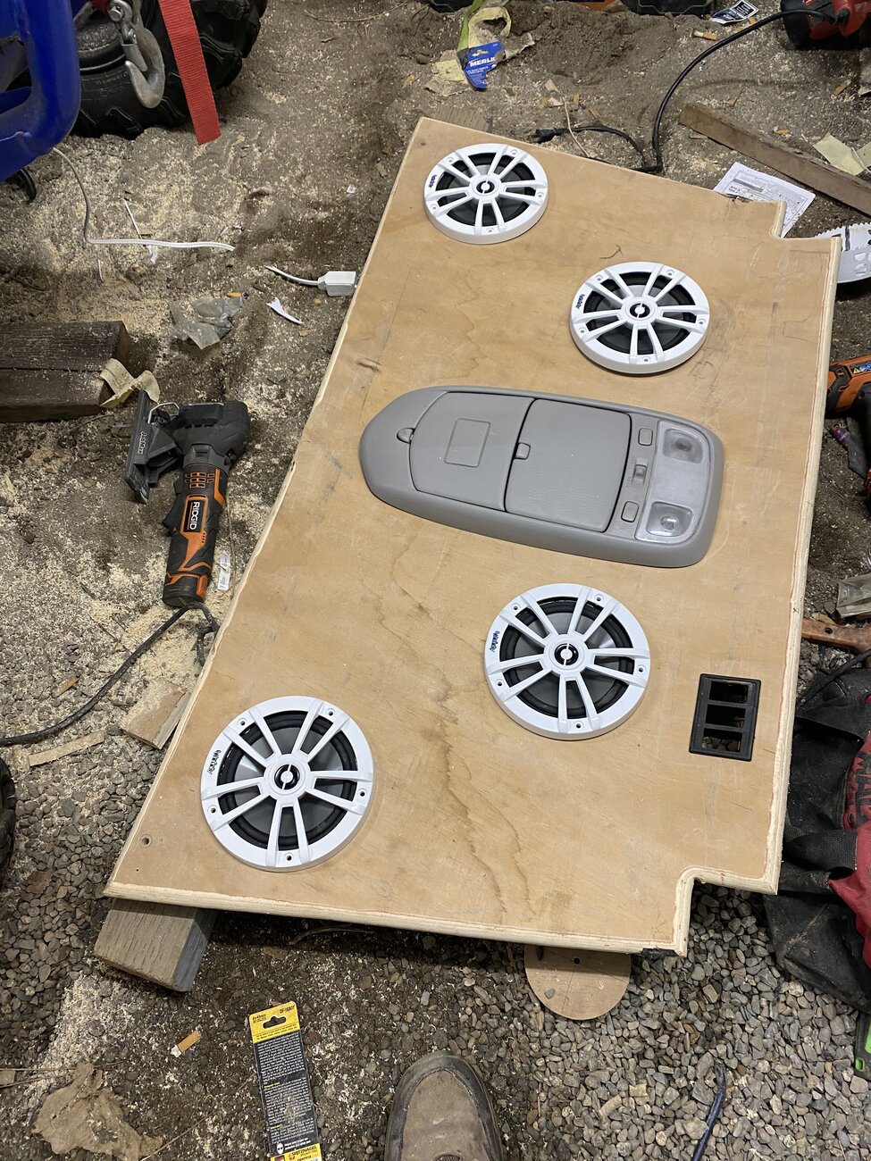

Trying to tuck it up as high as possible but the speakers have 2 1/4 depth so it’s on/off with roof. Right now it’s looking like headliner will hang 1/4” below the ROPS is all, edges are beveled so won’t look like it.
1/2 led spacer under speaker and 1/2” speaker mount so about 1 1/4 below ROPS for speakers. I want it as unobtrusive as possible. Could’ve went with a more shallow speaker but wanted these, they rock and have proven to hold up in other machines

And this is what I was going for. Plenty of sound, place to keep sunglasses and phone all safe and added three switches that’ll turn on whips/speaker and rings/ exterior and headlights internal rgb led lighting. It’s all going to be tied into one another so figured separate on/off for each system. Will have separate occupant lighting and door as well which I’ve always really liked in the Pioneer.
Got a little trimming to do, add speaker boxes then fiberglass over. But it fits nicely up inside.

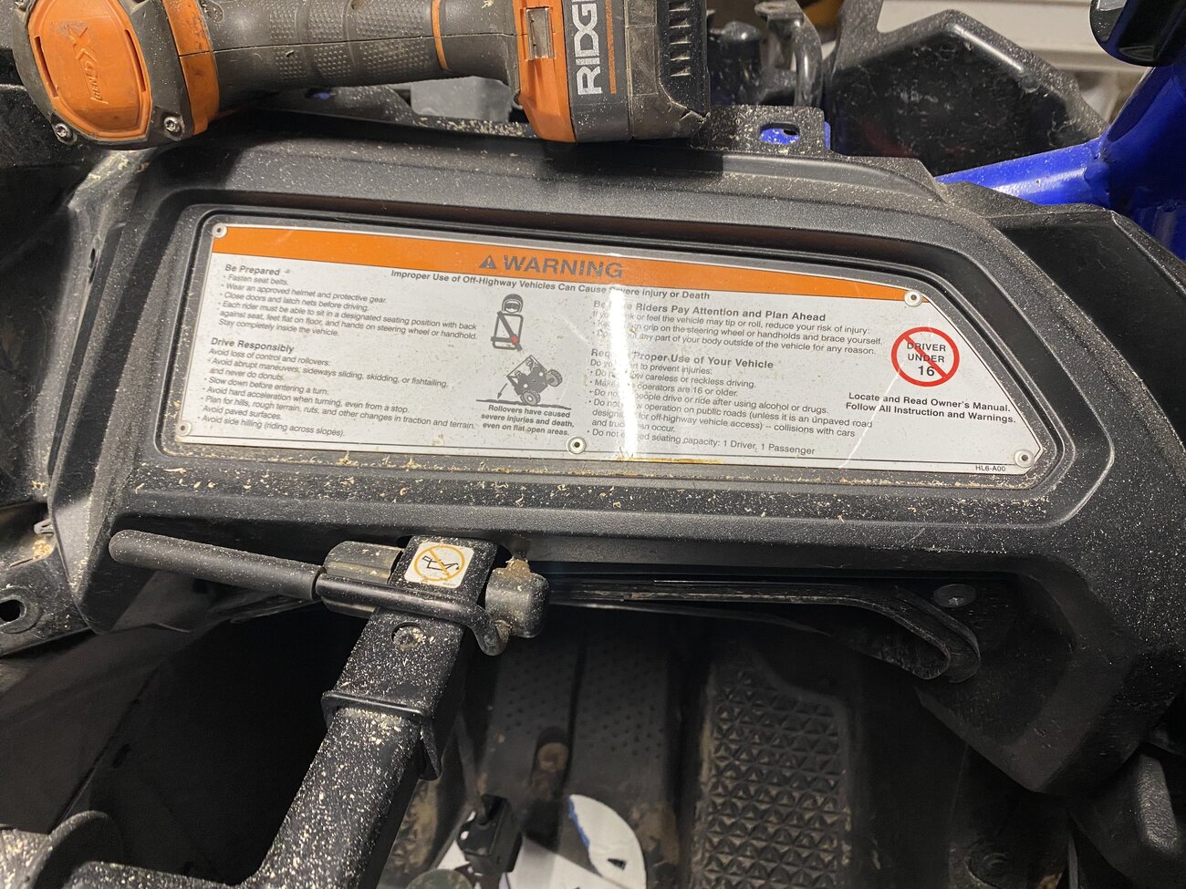

Who on the site could cnc an aluminum Talon plaque to go in place of the dummy laws on dash?
If memory serves @highpocket74 of 10-80 dirt sports was working on something. There was definitely a thread about a magnetic plate on here not too long ago anyway. Not sure which model it was for though.
