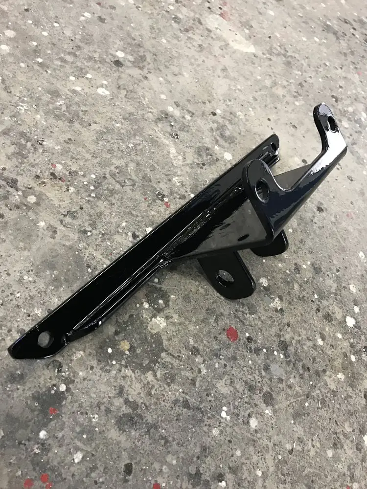

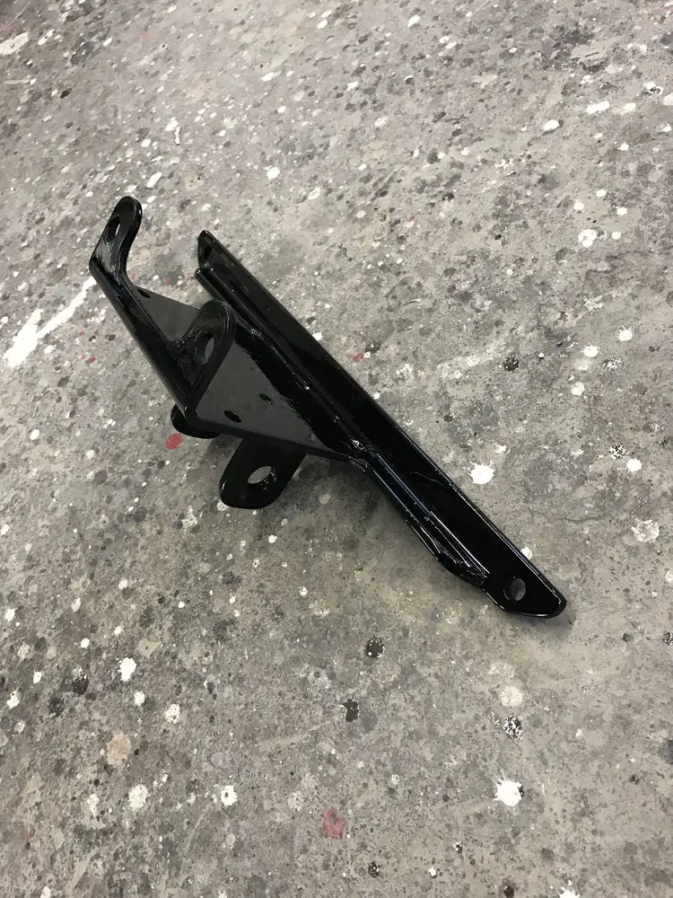

Rear winch mount finished. Just needs to dry. Decided on a one piece bolt in. Three bolts and it comes out. Figured bad idea to weld in case access is needed for anything down the road
IMG 9662
IMG 9663
322,956
C3f40ff350f86a8a781999a6225c8b06B3778efb7b8330e57f359502a39ce37f655f460be90bd308a9e7af654e2749f8
Wasn't about to drop the winch inside the receiver. We use the receiver and it's far to weak to pull from. Built the mount out of 1/4 steel and it drops down in the center to the hitch pin on both sides then up to both suspension mounts. Put large steel spacer into the c-channel in both rear suspension mounts and bolted both pieces that way it's much more stout.
Never liked the light duty receiver mountin this rig but this ties that in as well. Super stout and no twist.
