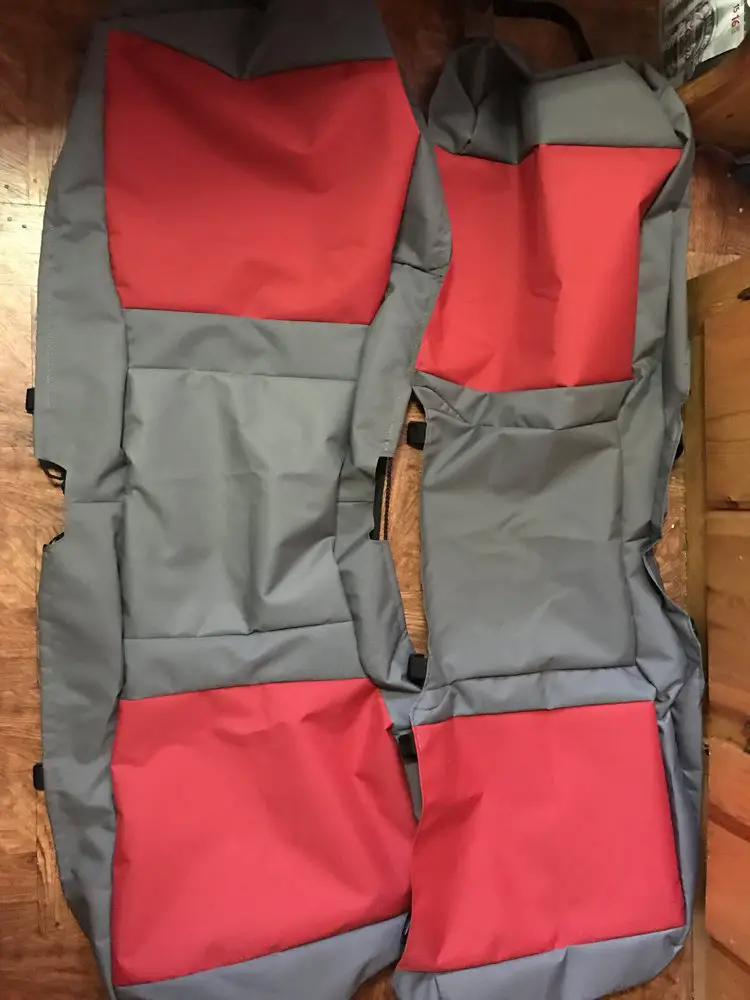

After a couple months waiting they are finally here! They did work with me on an area I wasn't happy with fitiment though and they were more then willing. It was an area that wore out more quickly but now solveWasn't going to spruce up the outside without bringing some into the cabin.
I've had these in three Pioneers but this was the first time going away from camo. Definitely didn't like camo with all the red on the outside.
Ordered up grey with red inserts in the toughest material they have it's also much more uv protectant.

Did you just use a local upholstery place?
No RuffTuff seat covers. They make them for all the Pioneers. 20% more but very good quality and you can order any color pattern and material type.
Just looked them up for the 500, you can get a new seat for less.

Seem to fit fine over the 3/8 in gel pad we used

Did you leave the original seat covers on?

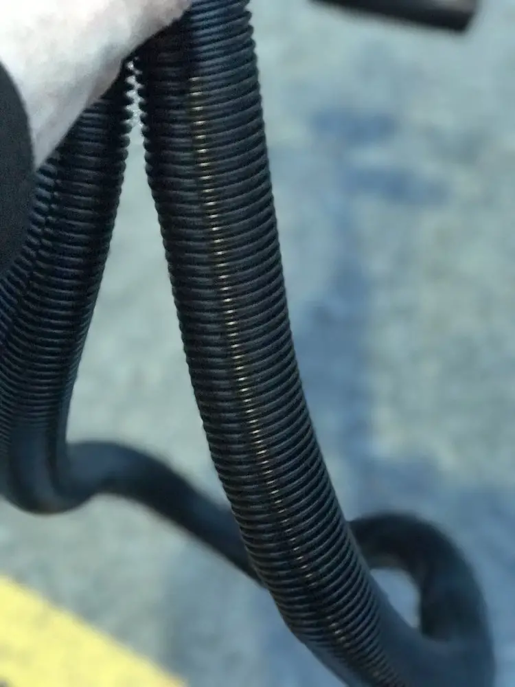

I know I'm all over the place on posting but that's where we're at. Busting ass on literally 15 different projects and it's crunch time. Picked up serious wire loom it's as big as my arm haven't needed anything like this since the bus build.
IMG 9633
2 6gu, 6 rca monster cables,12 speaker wire all stereo,2 4gu rear winch cable,3 10gu for fans and probably 12-15 other wires from dash to ass.seeing for the first time the actual scale of wiring scares me. Things are coming along though

Not good to run power and RCA's in the same raceway. Can cause interference.
Agreed! But there are not many options for running wire if not all together! I have mine together and there is no noticible interference.
I'd isolate the RCA's and speaker wires in a smaller loom inside the big one. With the cable jacket and the loom, they'll be shielded.
This I'll agree with! Same thing is true for the video rca used for camera. Unfortunately there was only one good pathway through not many choices. We have been listening to the system as we've been building and it is clear. Did take the time to bundle all speaker wires through separate 1/2" wire loom inside the large loom. Definitely Did the best possible through this. Thank you for bringing this up as it is an important thing for wiring. Normally speaking you run separate sides of the vehicle for the two
Exactly buddy! @trigger I know you're very good stereo and this is exactly what was done. Again there's only one way through and I didn't want looms stacked. Monster cable was used for RCA which has much better shielding as well.
