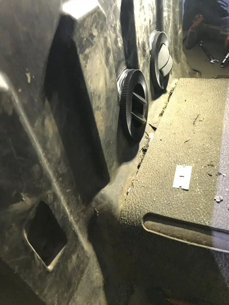

View attachment 39973 Heating and cooling installed. Large fan (cooling) is reversible and variable and twin small fans (heating) are variable. We were getting plenty of heat with the enclosure just through the seat heat so this'll be much more then that and controllable.

With the floor vents it'll be nice because during cooling they can open or close so you can choose airflow intake from cab or just underneath. They are totally adjustable for direction or amount of flow.

Where did you get the fans and vents? I have one big one but thinking about adding more

The big fan for cooling is a 1700 cfm 8" radiator fan and the small ones are 84mm heavy duty computer fans. Used 3" marine air conditioner vents for the intakes. They took days to find something I was happy enough with lol
