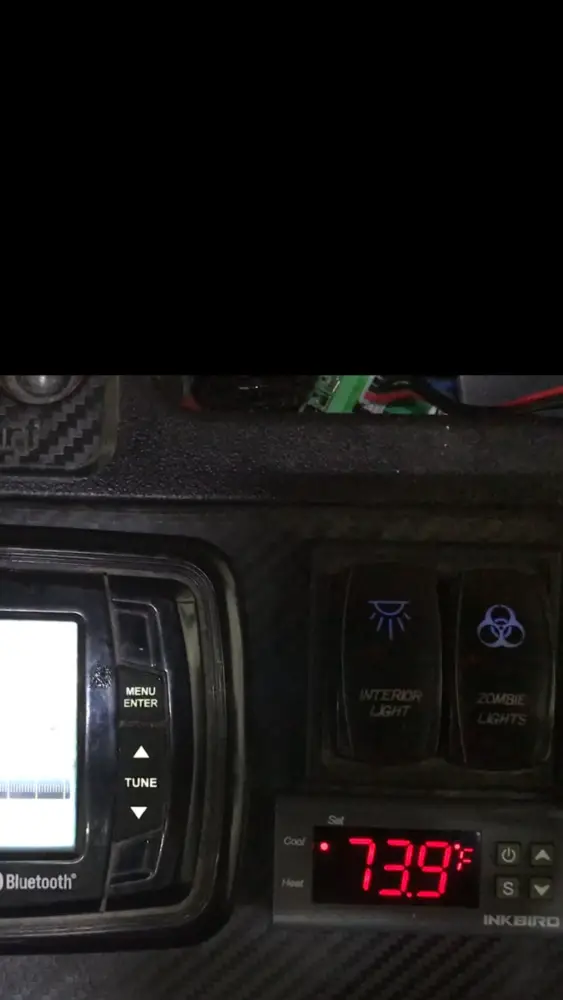

Got the bodywork to the dash completed from the old volt guage that was in this spot, moved switches up and left room for added switches below.
The temperature controller in. Easy setup to control both sets of fans, heat will turn on small intake fans into the cab and cool will turn on 8" 1700cfm cooling fan that runs across the motor and exhaust. Not a bad buy for 9$ with built in relays, hell the controller was less then one rocker switch and I would've needed two that would've taken up the footprint in the dash. No need for something extra to push and now anyone who drives this won't concern themselves. This full setup will be 65$ for everything pretty reasonable.
When the cabin gets hot cooling comes on and as it's gets cold the heat comes on. Simple and effective I'm hoping. This was a 5 wire hookup and two switches would've been 10 wires. Win win.
Cooling fan is pretty quiet and heating fans are totally silent so it's nice to have separate indicators on the screen to tell us they are working correctly.
I have that exact same controller in my pump house with a space heater hooked to it. It does a nice job. My first one fried after 2 years but I think that's because I was running 2 heaters on it. Probably too much current for the relay to handle.
322,956
It says 10amp relays which is plenty for what I'm doing but you could use it with another relay. Sounds like you've got the 110v version. If it makes it 2 years I'll be happy under 10$. I was very happy to see it had memory for the settings with power off was worried about that but so far so good and less switches is a damn good thing

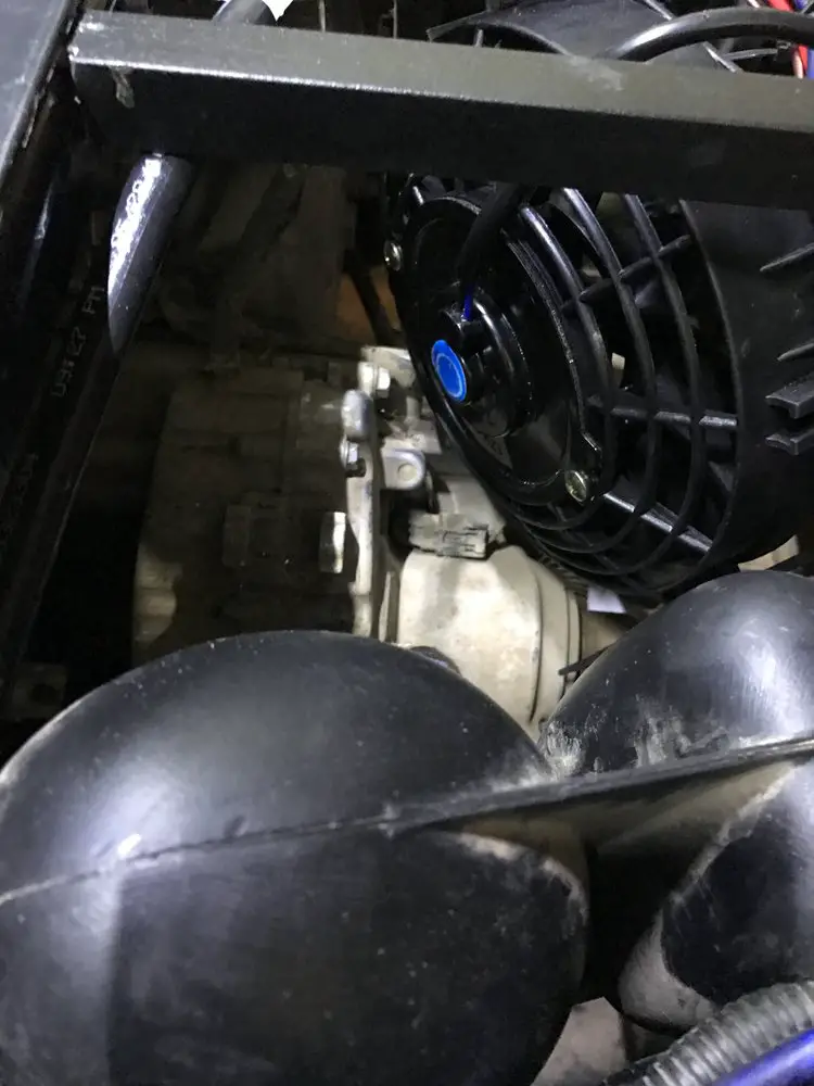

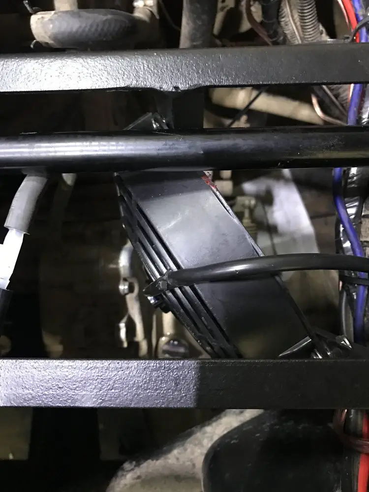

Got the "air conditioner" installed. Not much room for an 8" fan but she went in. Used bumpers on both side of the mounting bolts to keep vibrations down.
IMG 9481
IMG 9482
Works great you can feel air moving pretty good at the right tire with the skids off even. This fan also will be reversing and have a speed controller to give exactly what's needed. Massive air movement is what we were going for here. I'm going to build an insulated plastic cover for the engine bay and it'll have a side that drops down to control the air flow even better.
