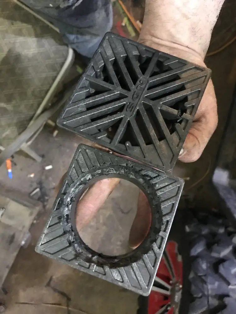

Kind of a b**** to find stuff to bolt this together. Cut the grills from a drain so it'll flow easier
IMG 9487

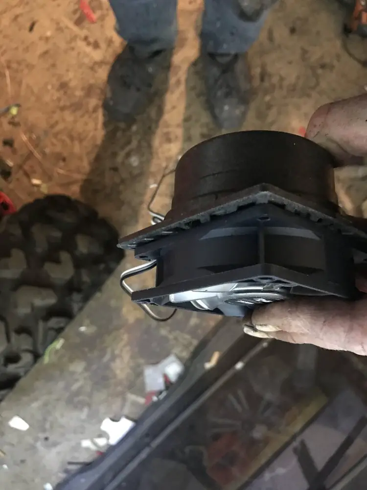

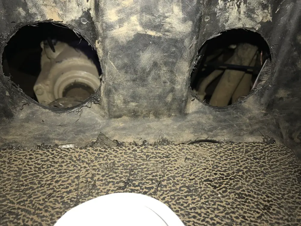

This gives solid base to mount the 3 inch fans

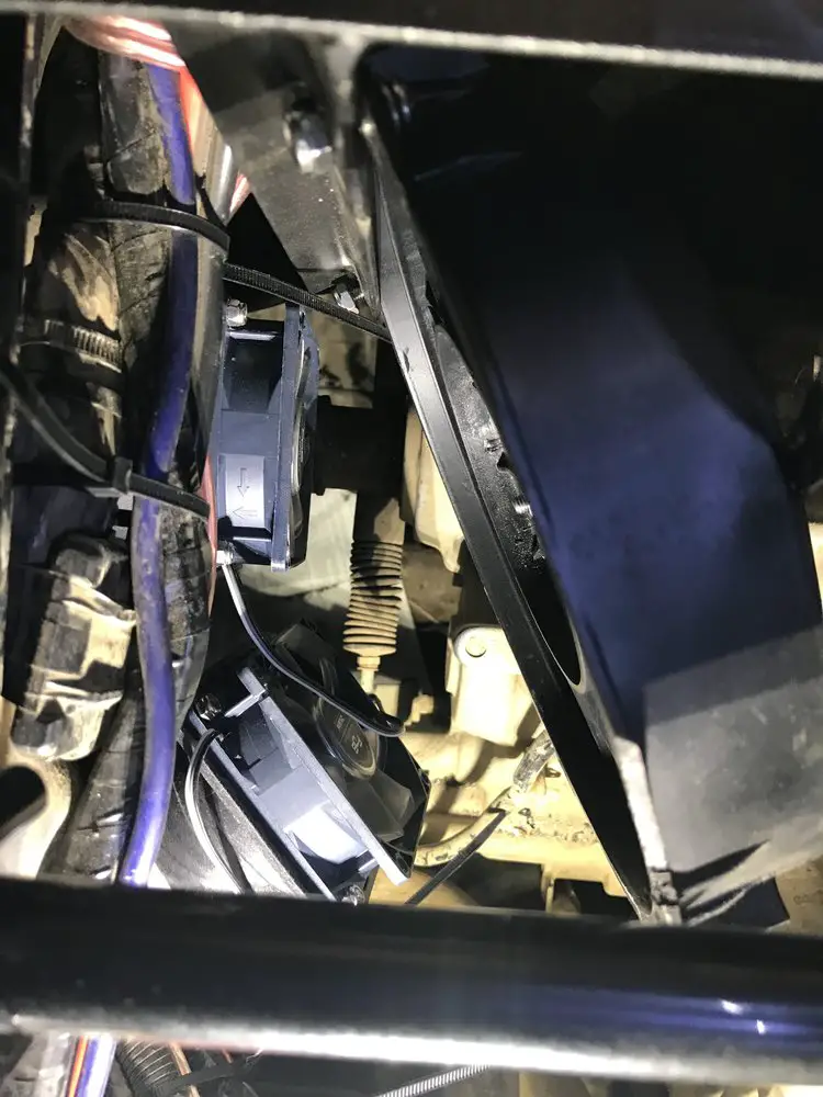

Everything is made to come out easy,bolts so it's all replaceable and most importantly doesn't need to come out to service the rig.

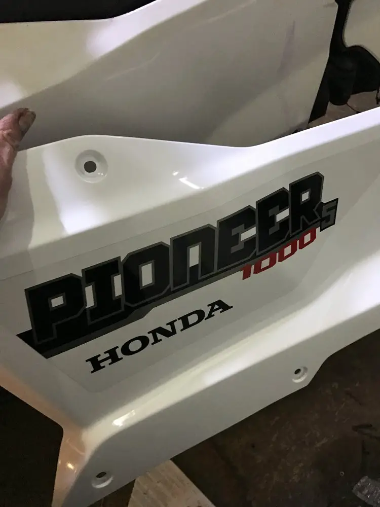

Took till now to finally pull trigger on new side panel. Scratches dings and dents don't bother me one bit but while building the enclosure before Xmas some PVC primer was spilt on the panel. Not going to paint side panels as they get too scratched up and putting new decals over purple crap was unacceptable

Big difference and exactly what we wanted. Even the red Pioneer in red background shows up.
Again another shoutout to my friend Walter over at creativeutvgraphics! @jrplaza2008 you're the best and I'll have you're beer ice cold in three weeks. I won't let too many people touch my rig but your work is all over it.

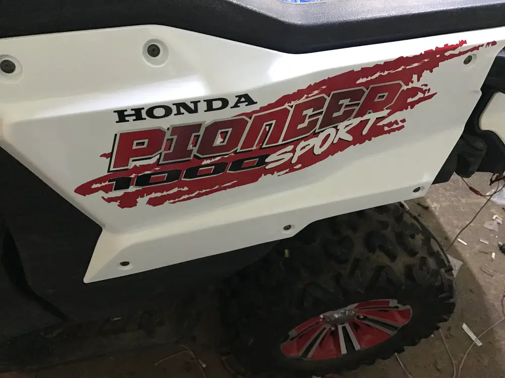

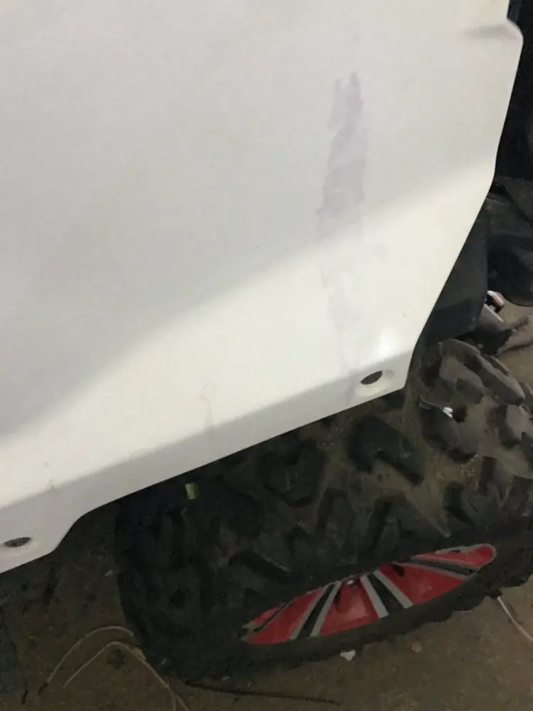

Oops
Brand new decal now gone.

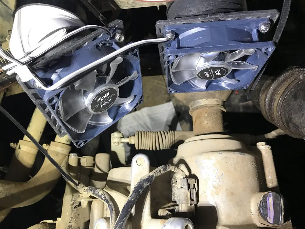

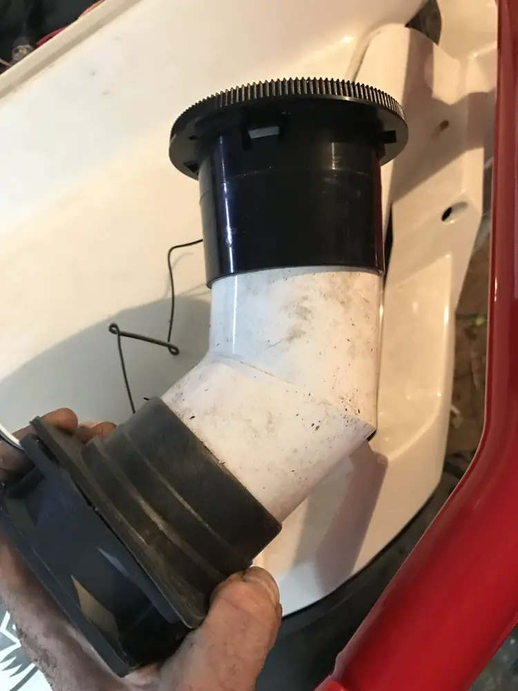

Heating and cooling installed. Large fan (cooling) is reversible and variable and twin small fans (heating) are variable. We were getting plenty of heat with the enclosure just through the seat heat so this'll be much more then that and controllable.

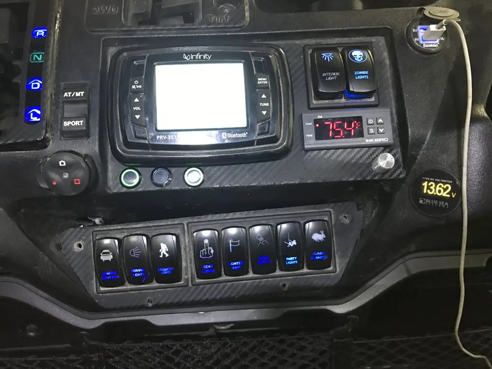

Dash center finally done. Two green led for turn signals/flashers and center is blue for windshield waster. Replaced the voltage guage with a super accurate oled unit with a slight timer so the voltage readout isn't bouncing around anymore that got old.
IMG 9567
The controller for the fans works beautifully. Need to button everything up but all works correctly.

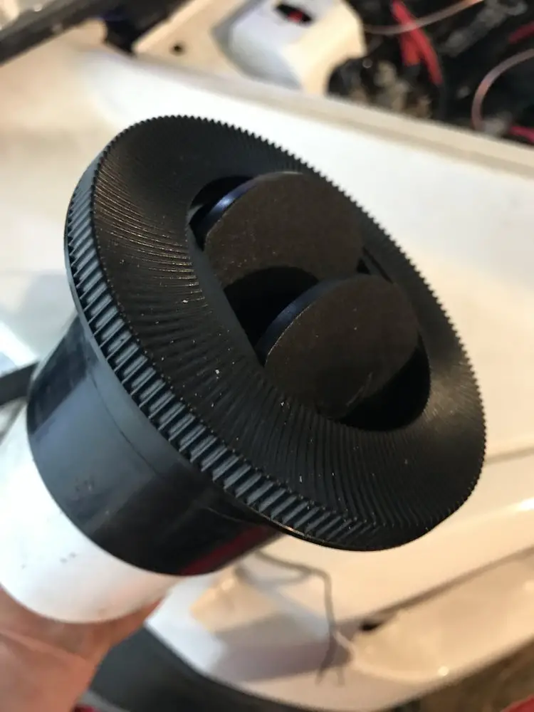

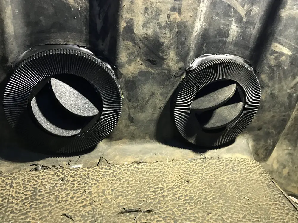

With the floor vents it'll be nice because during cooling they can open or close so you can choose airflow intake from cab or just underneath. They are totally adjustable for direction or amount of flow.

View attachment 39973 Heating and cooling installed. Large fan (cooling) is reversible and variable and twin small fans (heating) are variable. We were getting plenty of heat with the enclosure just through the seat heat so this'll be much more then that and controllable.
