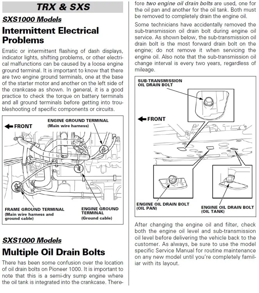

The winch problem may be part of the loose ground bolt issues guys are having. Tightening them fixed them for most guys. The doors also have some adjustable rubber stops you can turn to tighten them up.
34,174
Where are these ground bolts you refer to?
39,130
Try this....
A9acb5326ee4c569ed70142884896c99
39,130
Thanks Joey, is this something that is being suggested to check and possibly tighten oUpon delivery of new units?
Yes it is. I tightened those grounds upon delivery. I also found a seat belt bolt barely hanging on. I was missing two brake line bolts that hold the line to be A-arm. I tightened all the ROPS bolts. I can't remember what else.
Oh yeah, I also out dielectric grease on all the connectors I could find.
I tightened the loose clamps on the intake tube. You must check that.
Maybe that's the high points.
34,174
Yes it is. I tightens those grounds upon delivery. I also found a seat belt bolt barely hanging on. I was missing two brake line bolts that hold the line to be A-arm. I tightened all the ROPS bolts. I can't remember what else.
