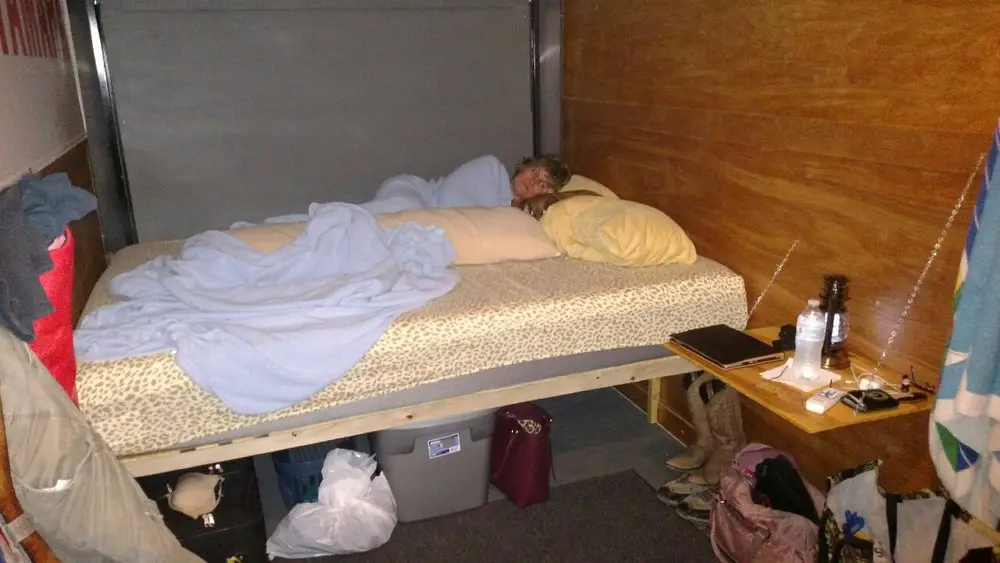

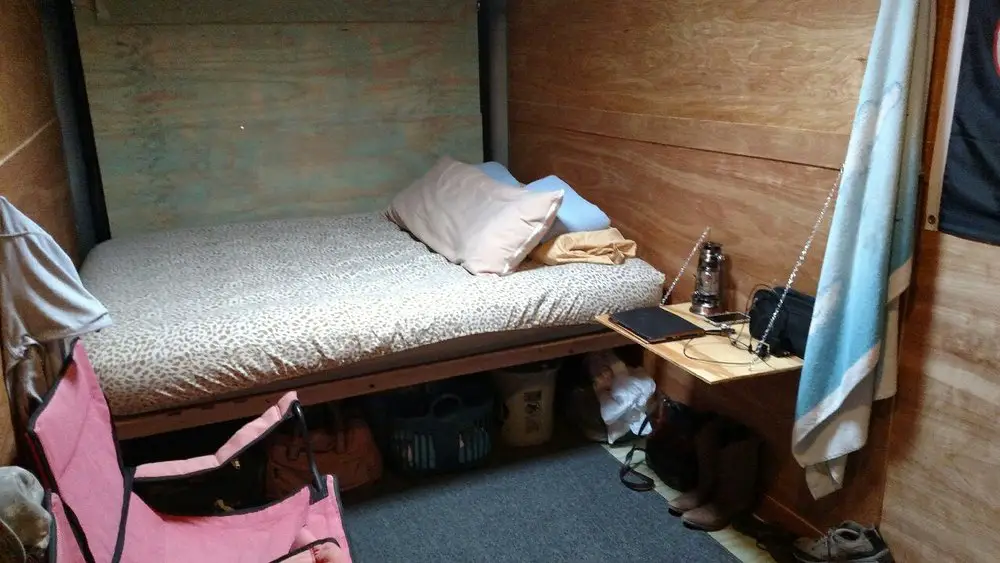

Stands up against front counter. It is a full queen 60"X80" . Inside of height is 7'

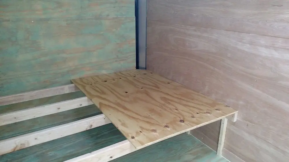

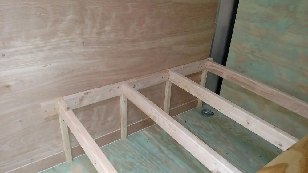

4 2X4s drop in slots, 1/2" plywood board hinged in center. When not in use I stand the mattress on end against front counter, then the hinged board, then the 4 2X4s. Then ratchet strap across all to hold. Takes less than 5 minutes. Stop by and check it out at the TO.
