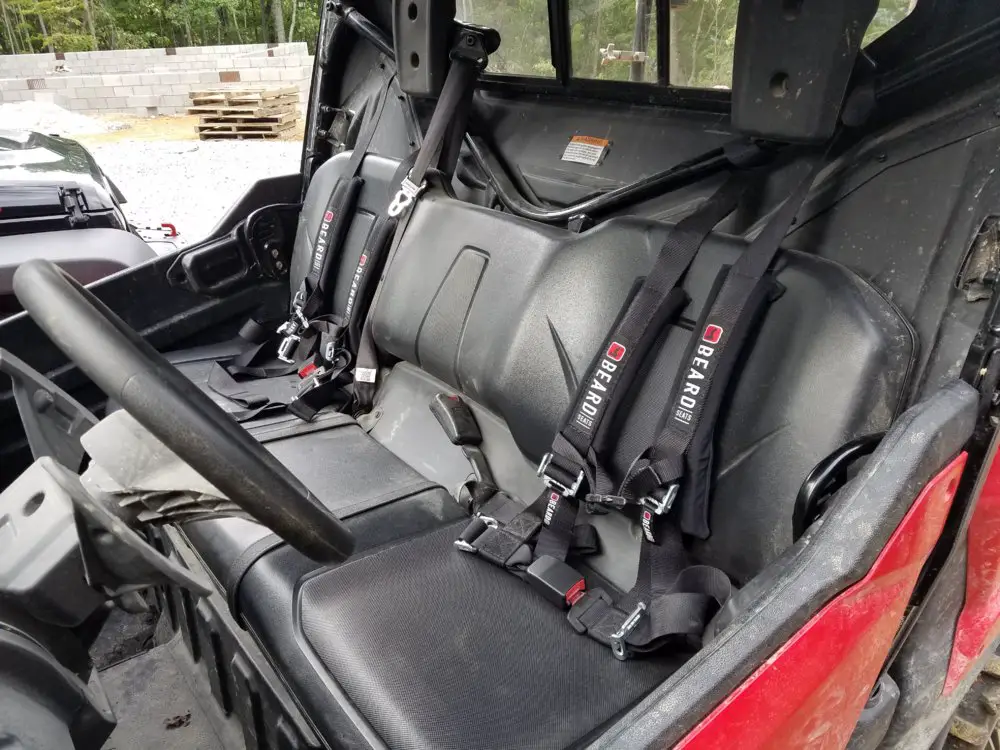

Now that I am going on longer rides frequently got tired of the OEM setbelts rubbing on my neck / collar bone area and wanted something more comfortable.
Since I am completely happy with the BEARD 4 point restraints with automotive latch that I have in my P500, I added a pair to the front of my P1K5D. Keeping the center seat belt for car or booster seats for now.
Installation was very easy, on drivers side behind padded headrest is a hole already between the two mounting bolts. There I used a single 3/8" x 1.25" bolt to secure the upper harness mounts together to backside of headrest mount. On both sides used the OEM location and bolts for the bottom harness mounts. The passengers side top is a little different but simple drilled a 3/8" hole in the same place as on drivers side and used a 2.5" long 3/8" bolt due to the size and shape of the OEM metal headrest bracket.
These padded harnesses are VERY comfortable as well as keeping you put on rough terrain making the ride even more enjoyable. In case of rolling the machine these will keep you in place even if you end up on your roof.
Beard 4-Point Safety Harness with Automotive Buckle | UTV | Rocky Mountain ATV/MC
My wife has this exact complaint, I was thinking of removing the lock off the seatbelt. That seems to be her issue is it tightens up because of that slide lock at the buckle. I think cutting that off would allow some movement like a car belt. Since I lowered the cage it rides in a much more comfortable spot on your shoulders

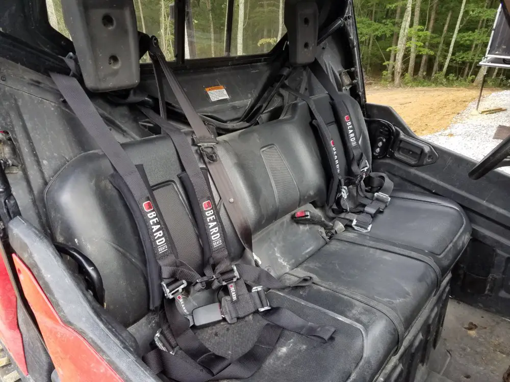

I know I don't have a P1K, but here is a quick shot of the belts nearly finished. Only need to anchor the inside shoulder belts. Not sure on where I am going to anchor.
P.S. not sure what these buckles are made of but I burned up a couple drill bits, they are really hard!
Sent from my SAMSUNG-SM-N930A using Tapatalk
41,220
283,294
Why not anchor both top straps together like on my P500 build? Just used strap metal around the tube at top rear of seat.

It looks like he used plumbers strap. I think I want to find a more significant mounting point. I was able to use 3 of the original anchor points and bolts.
