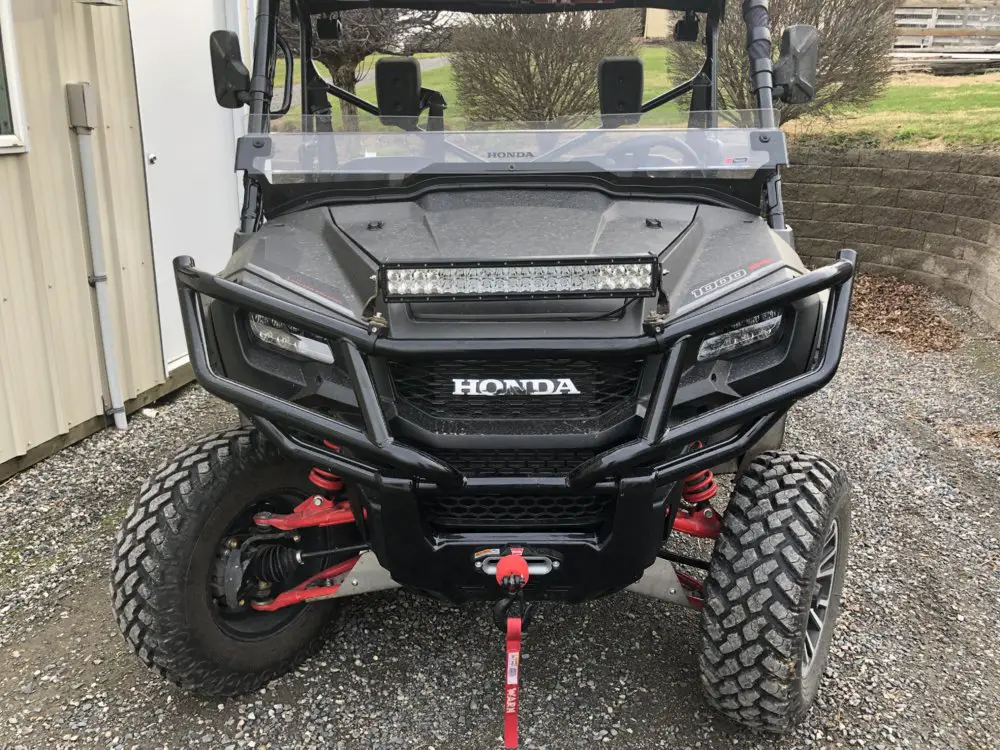

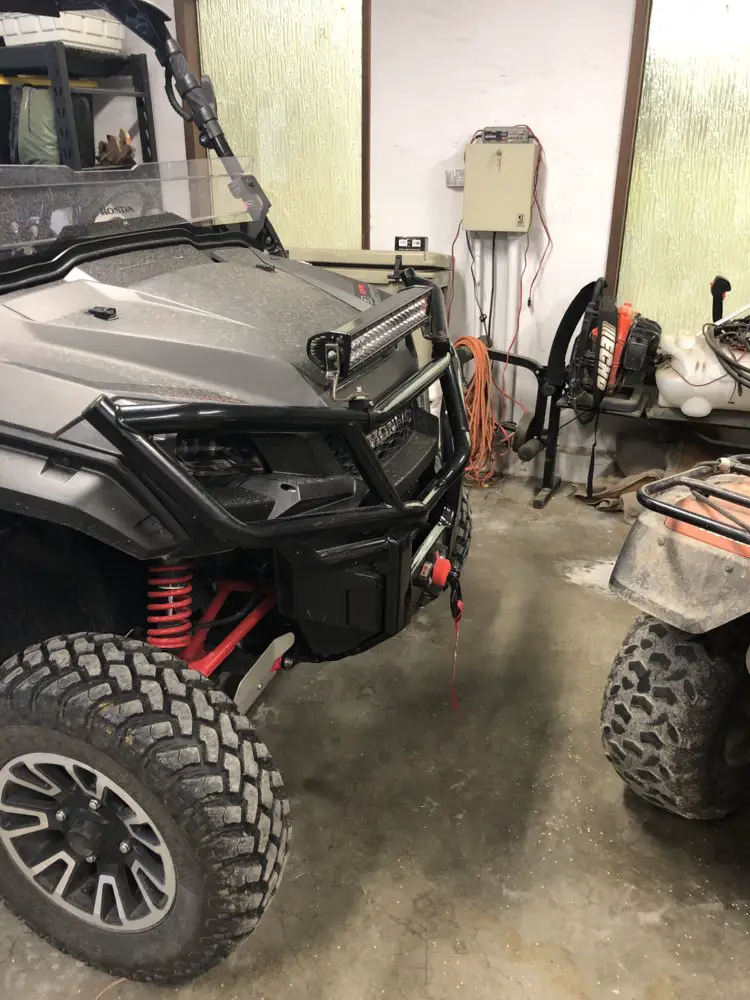

View attachment 101684 View attachment 101685 View attachment 101686 I decided to make use of the 24” dual row Rigid bar I took off the Viking. I was gonna do the 52” across the lower windshield... and still may sometime. For now though, this one will work fine.

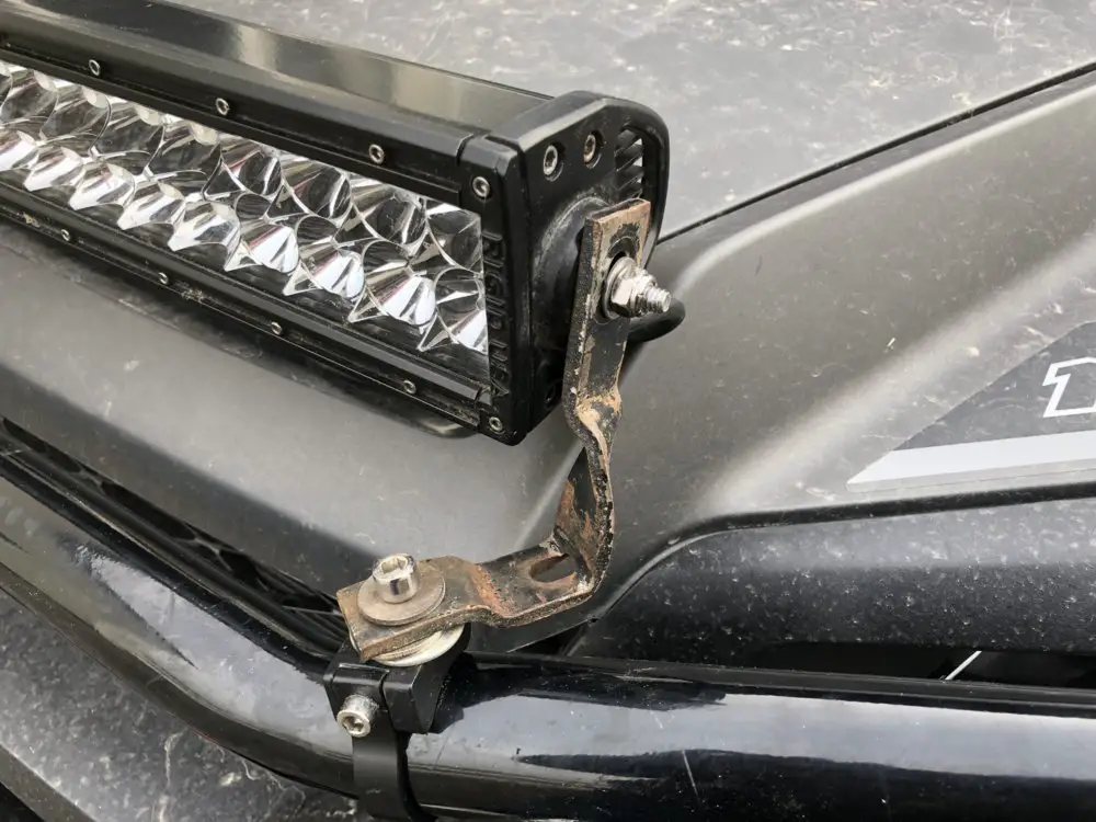

I looked at a couple different ways to mount it, and came up with this today.
A severely tweaked pair of short bars I had in my toolbox, bolted to a bar clamp.
Looks kinda ghetto right now, & I do have a little more tweaking to do on one of em...
But here it is.
I drilled some holes in the well where you mounted your isolator for mine so it wouldn't hold water.
32,051
I can get it about 2” lower, and I think I might do that.
Also have to find some shorter bolts & loose the washers lol!
You can get real low on the bar with a 20-ish inch light bar. Visibility is much better over it.
