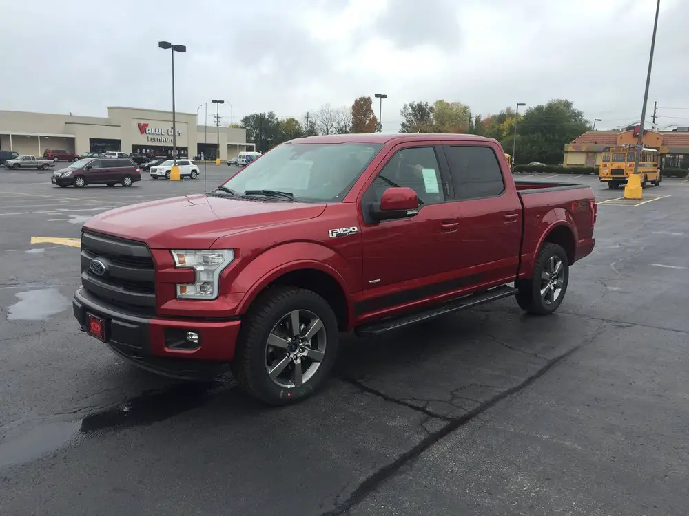

I guess it's only fair to reveal that I'm a Ford guy through and through. BUT, I have NO problem admitting defeat or that something else is superior. Hell I considered an SS before I bought the F150 but it just didn't have the tow rating.
