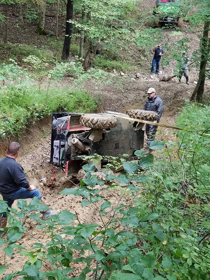

Here I can be seen draining the water out of my cooler, it was after this trip that I discovered the drain plug in the cooler and that would have saved a lot of time...
Everybody knows this even if not willing to admit it. Glad there was no injuries. Sure is green there, that must not be a fresh picture?
I think that was last may (EDIT: October). We have 3 big riding parks within 3 hours of me and two of them are pretty aggressive with hills. This was at Haspin Acres, a big park but nearly every inch of it is downtrodden rock and clay with tracks everywhere, a lot of youtube videos about that place. People like if cause you can overnight virtually anywhere you want and it's a bit of a party park.
Interlake and Redbird are SRA's have a lot more greenery and nature but are stricter with rules on alcohol and no overnights.
Anyway, when we are at these places we are never really far from the trailer so some of us take risks just to do it, a "Skills test" sorta place. If I was in another state I would ride with a little more sense to reduce the chances of ruining my good time with buggy damage.

I think that was last may. We have 3 big riding parks within 3 hours of me and two of them are pretty aggressive with hills. This was at Haspin Acres, a big park but nearly every inch of it is downtrodden rock and clay with tracks everywhere, a lot of youtube videos about that place. People like if cause you can overnight virtually anywhere you want and it's a bit of a party park.
Anyway, when we are at these places we are never really far from the trailer so some of us take risks just to do it, a "Skills test" sorta place. If I was in another state I would ride with a little to fit in the toy hauler. more sense to reduce the chances of ruining my good time with buggy damage.
This is our first year doing this. My wife and I have a toy hauler. The P500 was chosen in part due to the fact that it is small enough to fit in the toy hauler. We have several places within a few hours where we can camp either free or very inexpensive. Hansen Hollows in eastern Iowa is e nearly 500 acre fam with tons of trails. Free camping. Smurfwoods down in Missouri and Tampa OHV park in Tama Iowa. Lots of great opportunities. This summer is going to be a blast!
