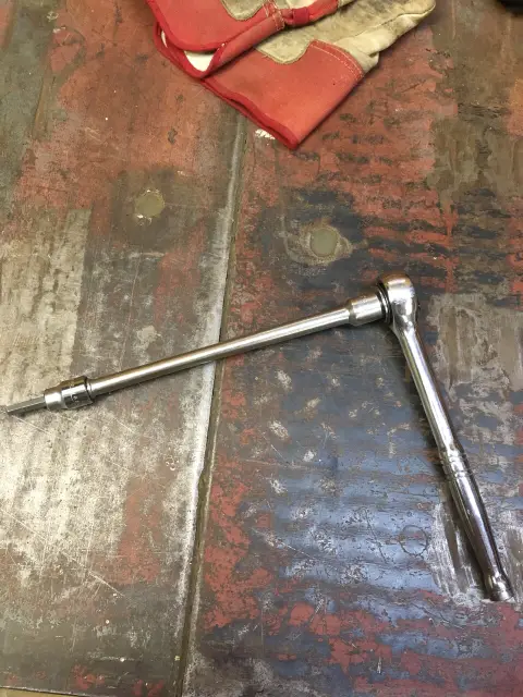

I got it thanks to the recommendation from @Neohio and removed the seat. Still a huge PITA. Can’t believe the Honda engineers thought this was a good idea. My other brand that started with a P was literally 30 seconds to get to the air filter and change it.
Honda p1000 air filter change guide:
Step 1 - disassemble entire machine.
Step 2 - try not to strip Allen heads since they were put on with a 3/4 impact.
Step 3 change filter and reassemble entire machine.
View attachment 56093View attachment 56094View attachment 56095
That is all folks.
I also ruined a brand new first time worn white work polo because I’m too hard headed to change. I thought it would be a super simple job when I started. My wife is super proud and happy with me. Lol

Ok how the F do you get the top three Allen head bolts out of the air cleaner cover. I tried with a regular allen and couldn’t get it. Went and bought T handles and still can’t get the crap to budge. Tried taking the two bolts out of the side of the cover to lean it down and get a better angle and that does nothing. I’m not a 75 lb 3ft tall Japanese guy and this is frickin stupid! Help please.
I must be one of the lucky ones read how hard it was to get the Allen screws out so I ordered the long Allen tools and prepared for battle. I live in North Texas and noticed changing the air filter was not part of the 100 hour service dusty where I ride so I changed it yesterday. Raised the bed took the push pin cover off wiped dust off of filter housing and began removing the screws. All came off EZ and was a 5 minute job. Glad it wasn't a battle.
