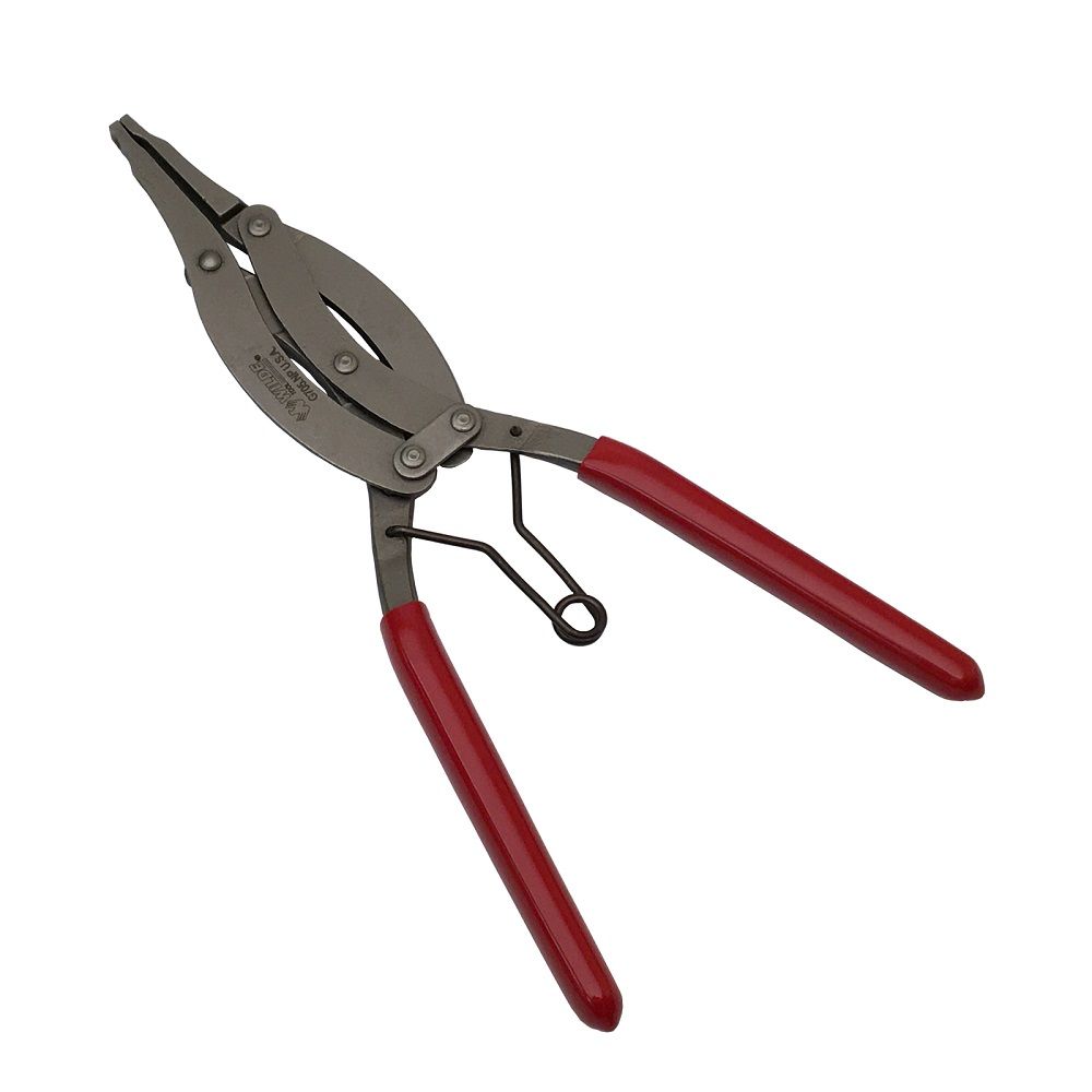

We use a pair of pliers like this, but from Mac Tools
I have similar pliers also. But sticking my hand in at a distance and trying to keep the tips lined up didn't work very well. The circle tips captured the retainer ring and held it easily. If I thought I would be doing this again, I would make a set from a heavier wire and try to center the loops more.
These have divots on the outer edge of the tips to hold the clip. They also dont pivot in an arch, they spread in a straight line so the they wont slip.
Trust me, ive done way too many of these with everything under the sun and these are the only way.
We keep one bolt in the diff, spread the clip, then pry the shaft backwards to get it past the slot in the diff coupler. Then pull the diff forward, remove the front hoop and its out.
I guess I don't have pliers like that. No divots and bad arching. But my bailing wire goter dun.
