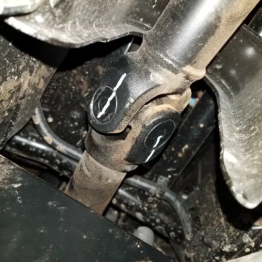

As long as the caps aren't rotating, you should be ok. HondaBob marks witness lines on his caps with a welder's paint pen, similar to all the paint marks on important bolts around the Talon. You could use fingernail polish too but don't let yer wife catchya. :oops:
HondaBob's photo from the previous page -
I don't think they've moved so far. I did put JB on them but they may have been moving before. There is definitely a bit of play in the front u-joint. I have the new SATV shaft sitting here, just waiting. I tracked down a few clips and ordered one from a shop in UT. I was on the line with one in WV but they wanted about $60 for shipping a $3 part! I'll push before I pay that.
I forgot you mentioned that you were able to feel some play, I'd be changing mine out too if that was the case. I think the Talon guys are going to make @SuperATV very happy about their investment in developing the CV driveshaft for us. :cool: The recent difficulties in this thread aren't giving me any confidence in tackling the project. :oops:
