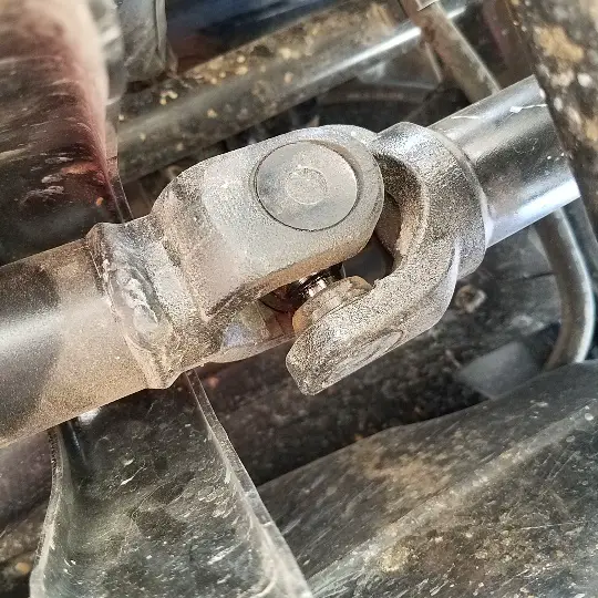

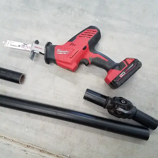

If the U-joints have play and the bearing caps are in place you may be able to do a ride. You can use a sawzall with a 9 inch blade and cut the driveshaft in half to remove it quickly. With it out you can drive ok in 2WD. Sometimes we will have 10 Talons on a ride. I always take my sawzall to cut the driveshaft in half if some had a bearing cup fall out. It can be cut through the coolant drain hole in the skid plate then just pull it forward off the sub trans.
Is it typically the front joint or the rear one that goes bad? Or both?
I like the sawzall trick, if I go that route I'll be SENDING IT up some shale shelfs!

Most are the rear U-joint but my buddy has the front one fail. Its easy to check to see if there is play in the U-joint. My 2020 Talon with nearly 6,000 miles is still OK. I marked the cups and check them at every oil change or before a big ride. There is a cardboard sleeve inside the drive shaft.

I have read that some have tried a cold weld epoxy such as JB Weld instead of a tack weld. Does anyone have any experience with this solution?
If you use the sawzall method, I assume as long as the 4 wheel drive is NOT engaged the drive shaft still connected to the front final gear will NOT be rotating and flopping around. Correct?.
View attachment 324774View attachment 324775

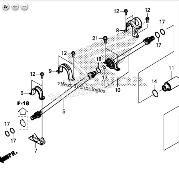

I have not seen any reports of the X4 having a driveline fail (not that it isn't possible). The X4 has a 2 piece driveline with a center carrier bearing and the parts are all different. Maybe the X4 parts have better press fit tolerances than the 2 seater, only time will tell...
