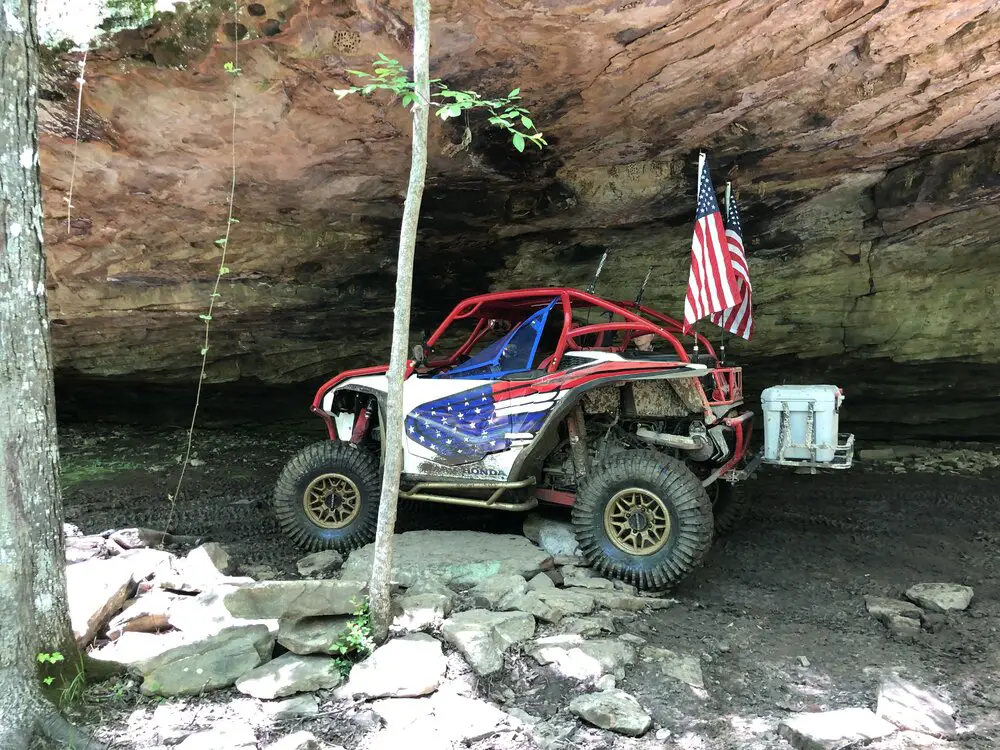

Cooler rack worked perfectly yesterday. Also ran the "heavy" Bandit spring set with the sway bar disconnected and it was sooo much better for how and what we ride. Had a great day with friends riding the trails and taking in the amazing beauty of creation.

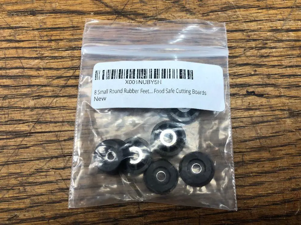

Found a good fix for the little bit too short door stoppers that Honda gave us. I've tried a couple other things but this fixed the rattle for good. Small rubber cutting board feet from Amazon. Just screwed the bumper to the raised portion of the inner door panel that contacts the stopper and adjusted the stopper as necc.
8 Small Round Rubber Feet Bumpers - .250 H X .671 D - Made in USA Food Safe Cutting Boards - - Amazon.com
I'm going to order these today. I remembered seeing this posted a few months ago and it took me a while, but I found it this morning. Great idea!
