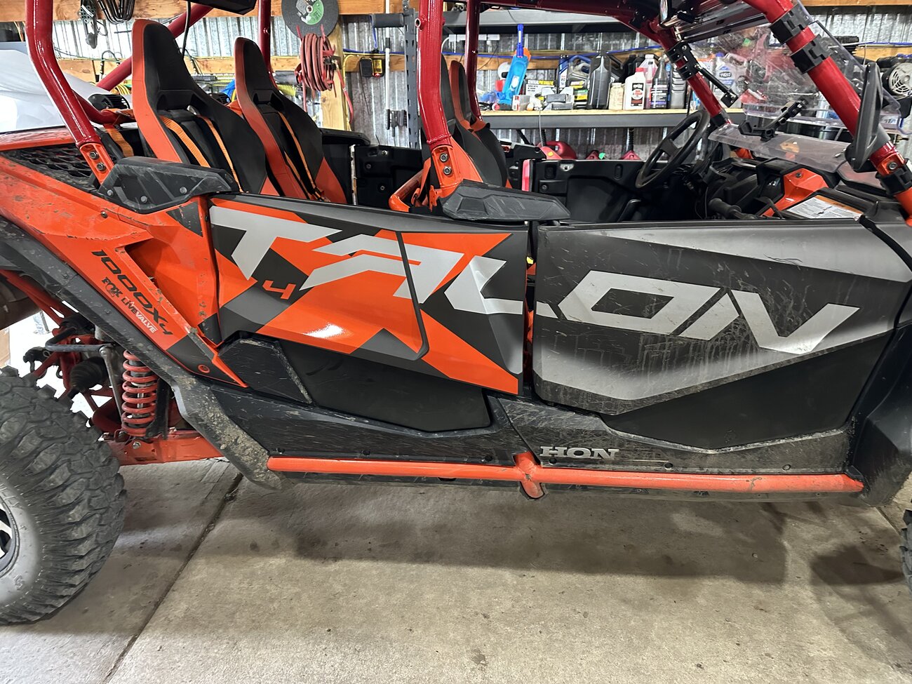

Got the replacement midsection of the SATV flip screen installed, the upper cowl installed and some mirrors installed.
IMG 6431
IMG 6429
IMG 6430
For the mirrors I used this Amazon kit and inverted the rear view mirror. I hate this mirrors that hang down low, talon already has a small window if you will.
Gotta clean up the bottom on the windshield yet, install the 4pt harnesses in the rear seats, 42” light bar, and maybe a rear panel or screen. Still have to move the seat and notch the gas pedal.

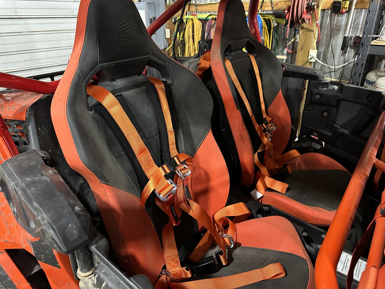

Installed the rear 4 point harnesses, front already had them. They are aces racing from Amazon.

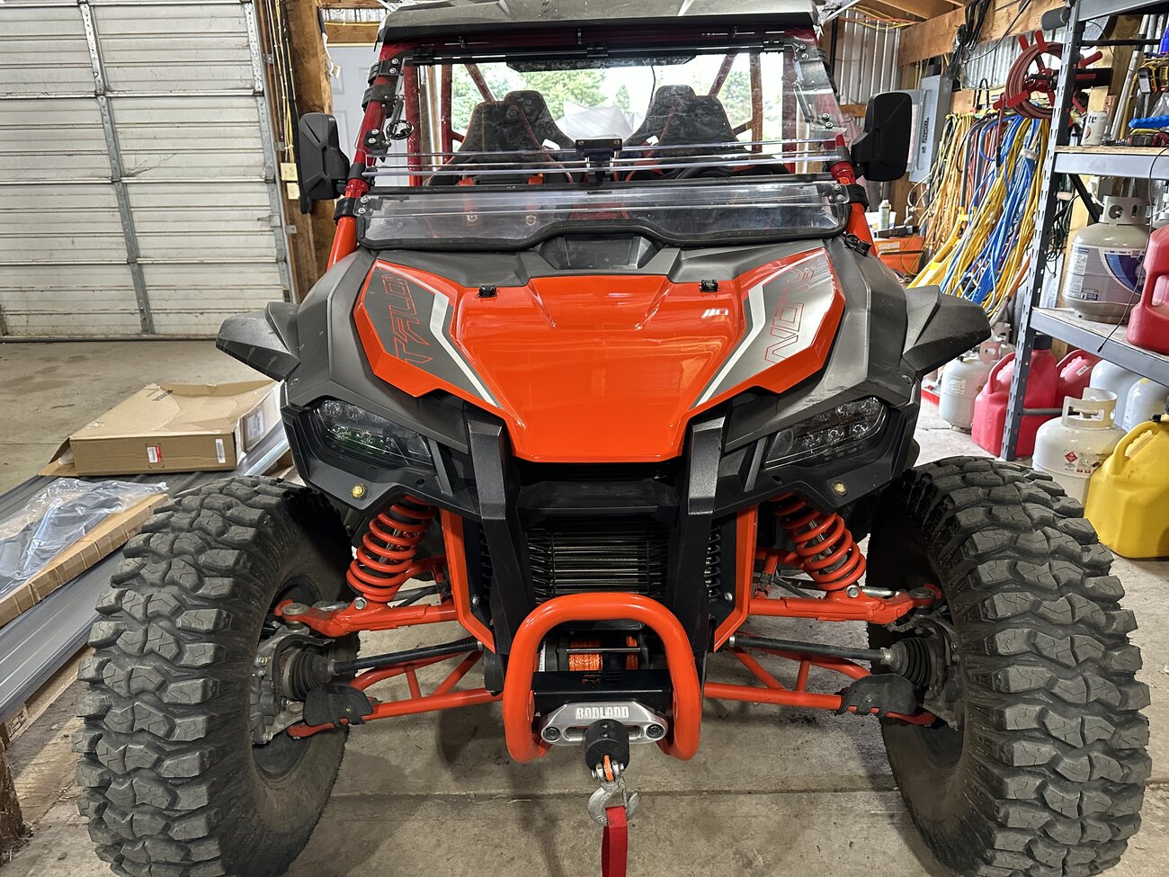

Brown Santa dropped off some stuff today..
IMG 6439
IMG 6440
Pssst….
Don’t tell @Remington i stole err “borrowed “ the hood from his Talon!
Found it new on flea bay for 1/2 the cost of the new gray one, which has been on back order since I bought the buggy. Gonna cancel the order in the morning and pocket the difference. I think the x2 hood looks great on this rig. Very happy that everything lined up perfectly.
