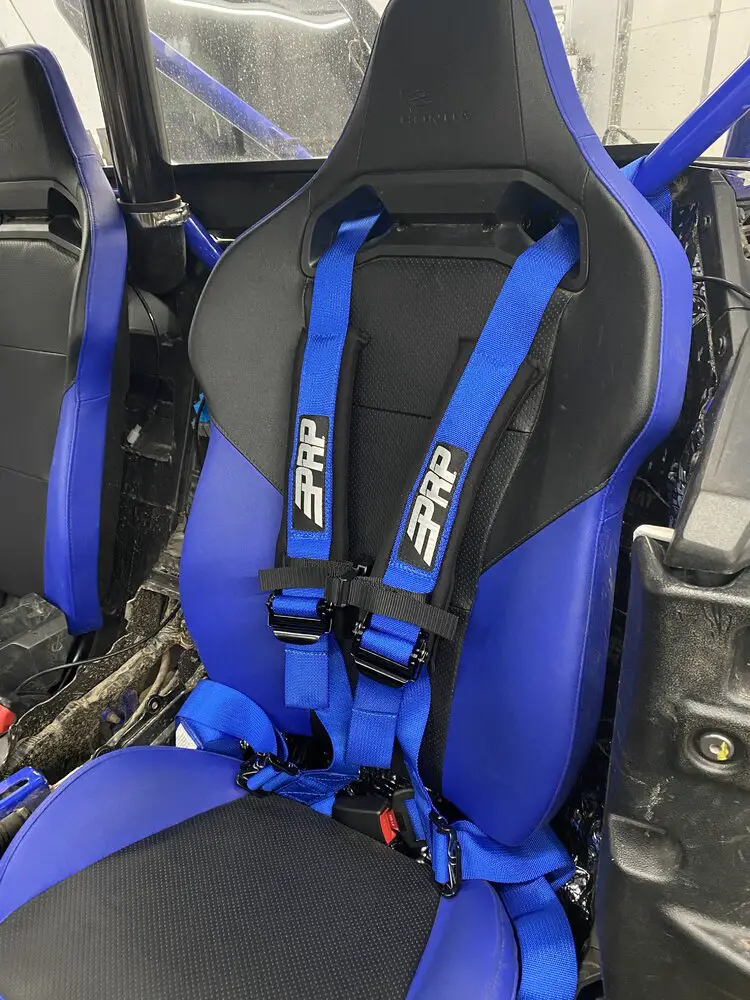

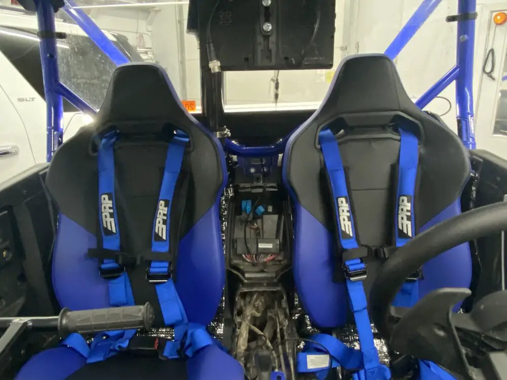

Update. Got passenger seat sound mat installed, harnesses in, and light bar mounted. FYI dragonfire EVO belts do NOT work in the Honda 2 seat. Sent those back and went with 4.2 PRP and the quality is much better than Dragonfire. The buckles tighten up and loosen up WAY easier than last set. Now its my turn for gauge relocate kit just in time as I am wiring everything up! Thanks Paul!

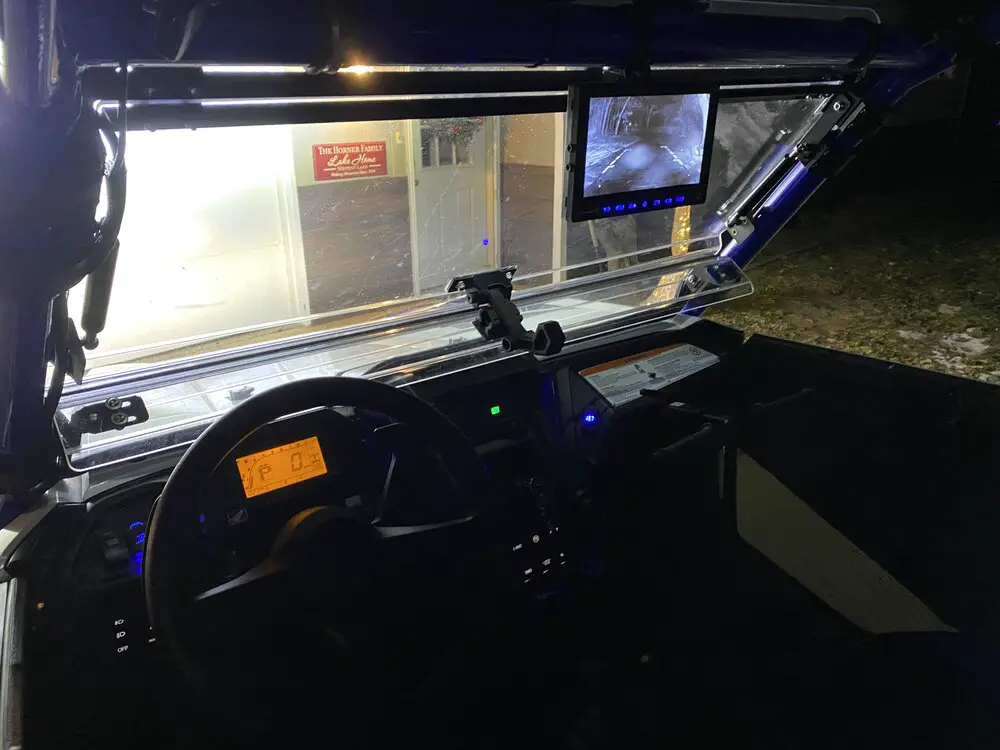

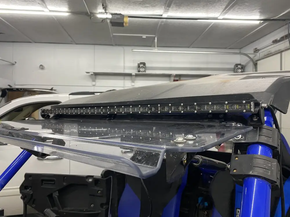

Any feedback on the reflection with the light bar and raised windshield? Does the windshield clip the 'up close' light?
I have not had a chance to test it yet. I will be getting my gauge relocate kit from Paul next week and I will not have the wiring finished for a while because of a hunting trip. I will let you know once I can test it.

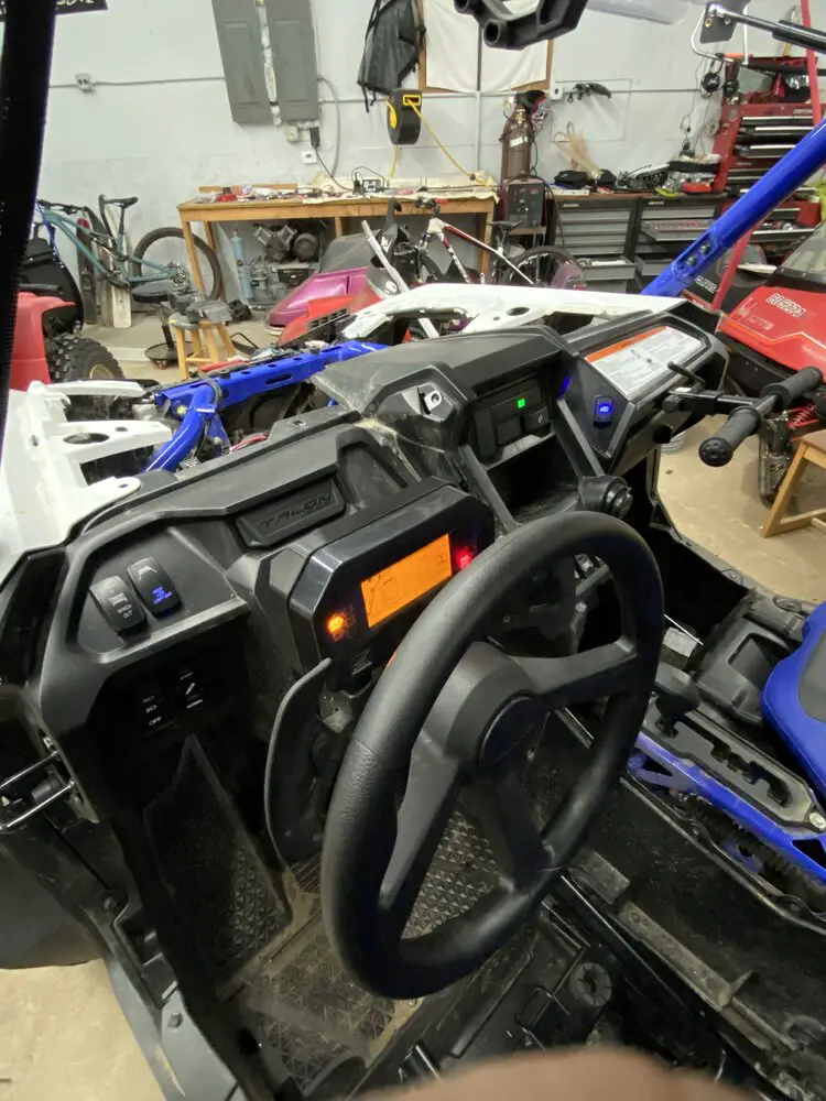

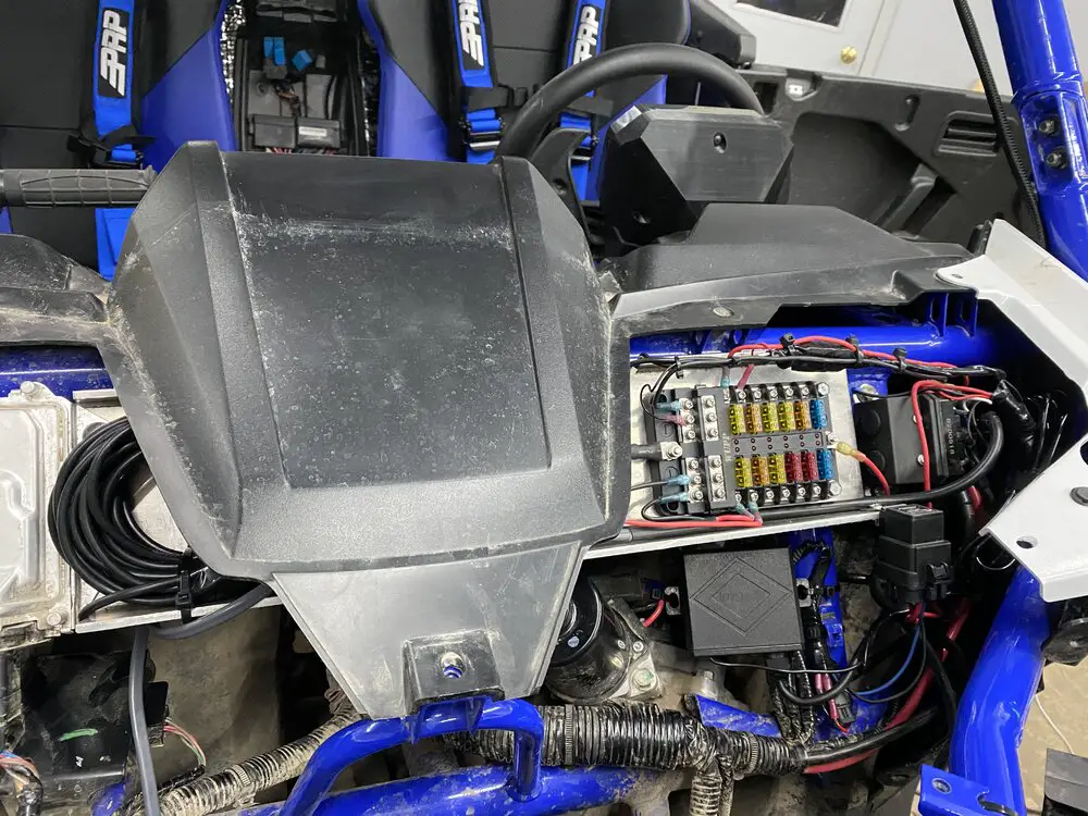

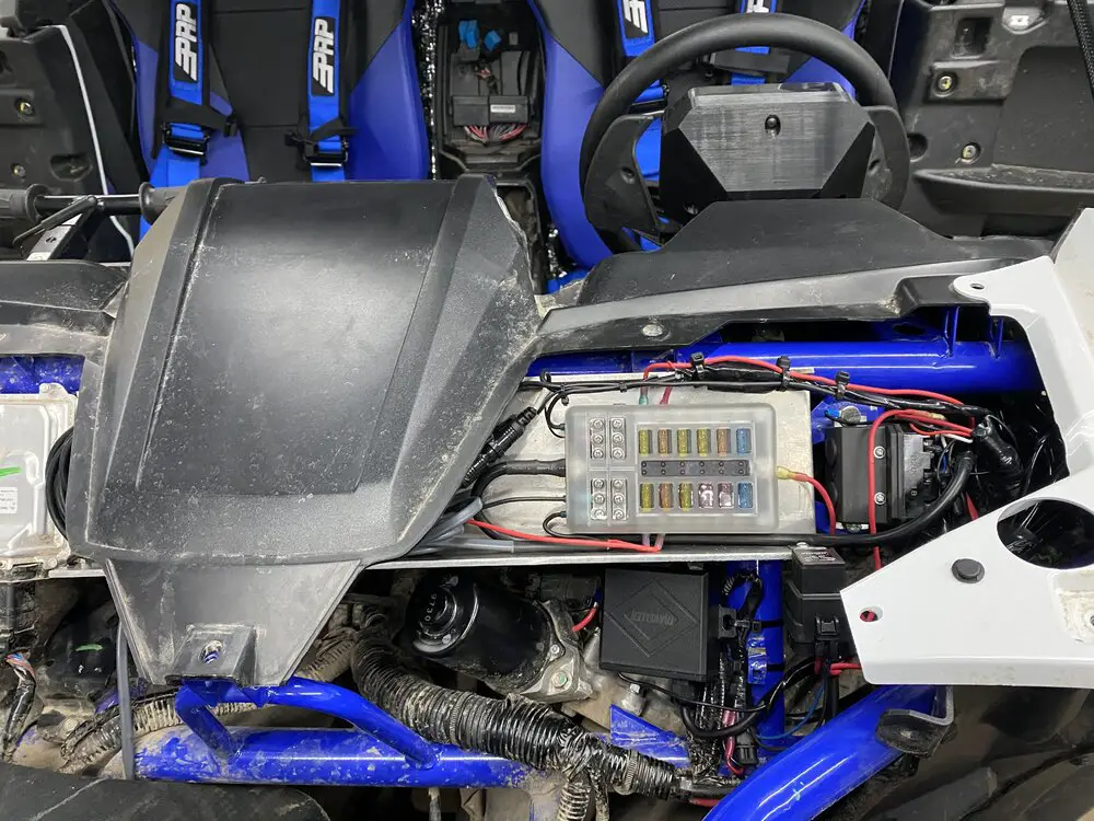

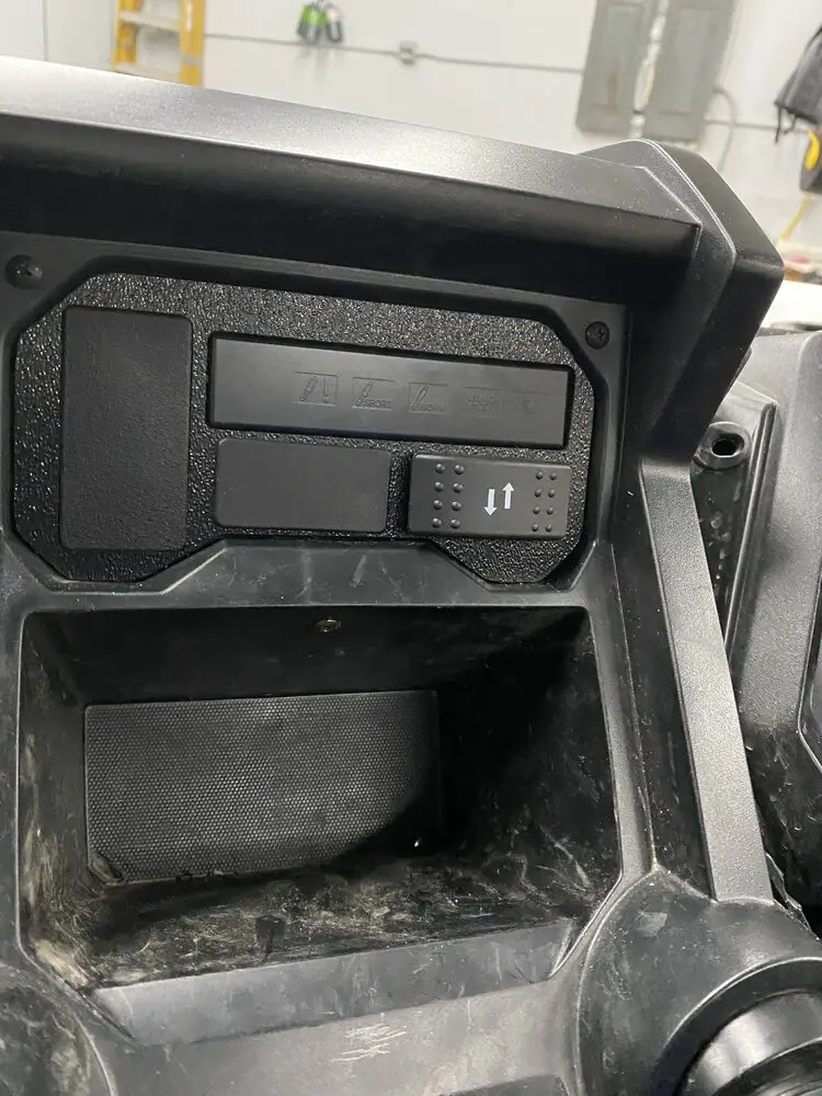

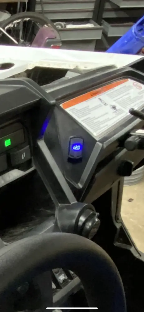

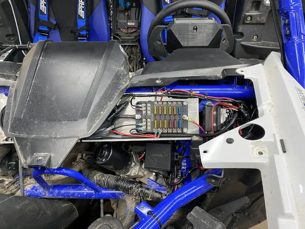

Finally got around to wiring up accessories and installing my gauge relocate kit. Still not finished but got a lot done.
Also added a voltage gauge with dual usb ports on the passenger side. Gives nice view of voltage and enables you to plug in a usb and stick your phone in glove box or center cubby while charging.

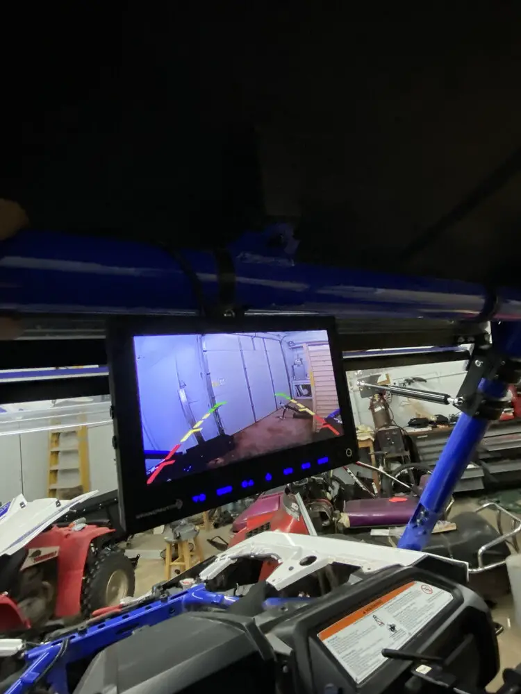

What backup camera is that, is it wireless, have a link? I find I'm nearly blind backing the Talon. :oops:
Just got to test out the light bar tonight in the dark and there is zero problems with reflection on the superatv tip out while open or closed. Highly recommended.

How does it work at speed? Blochie?
Have not been able to test at speed. I will report back. It is a hardwired camera so as long as the refresh rate and head unit can handle it there shouldn’t be a problem.

I want a camera, but I have watched so many blotchy vids and don't know what to buy?
Main reason for this one is backing up while plowing, and checking to make sure people are coming on the trail. I should be able to test it this afternoon.
Camera seems to work well at speed. Works well enough to see same as you would in a mirror. It actually works better than a mirror at night because you do not get pounding light in the eyes from your buddies light bar...😂

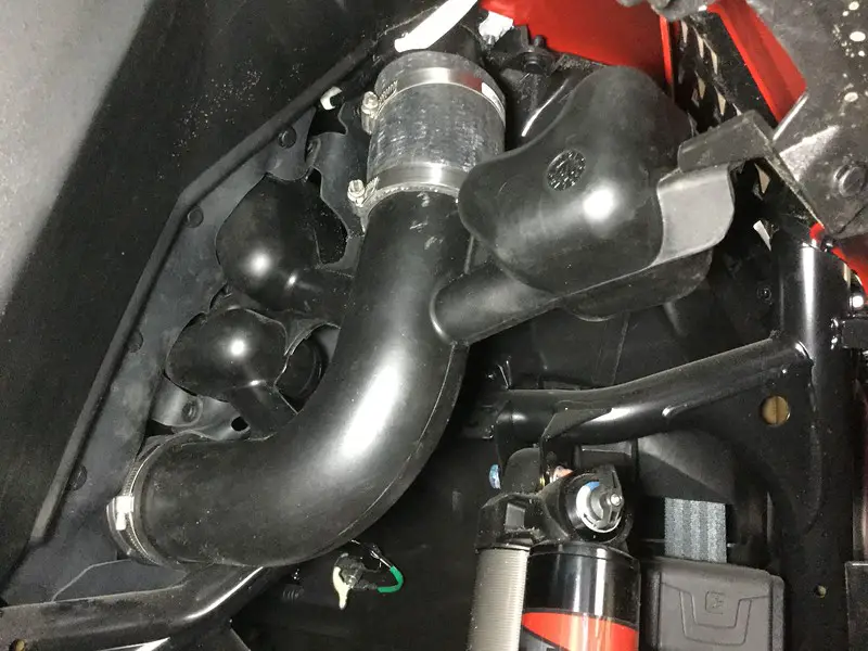

Update on cab intake. It works great for keeping things clean and at speeds less than 40mph. However, I went on a highway cruise with speeds above 50MPH for around 6-7 miles and the noise was quite annoying. SOOOO....with deep regret I am here to let everyone know I do not recommend routing the intake in the cab unless you are wearing helmets and intercoms for riding all the time. I will be re-routing this outside of the cab in some fashion just have not came up with the plan yet.
fwiw: The mechanical noise in the 3 Talons I've ridden in is painful to me so I'll always be wearing hearing protection anyway. I have a jar of foam plugs that I keep in the Talon so I can't forget them, it's that bad to me.
Did you remove that goofy looking multi chambered air intake plenum? I often wonder how much of this is for intake tuning and how much for noise control? 🤔
I would say it is 100% for noise control. I did remove it. I don't think there will be an issue with noise once I route the actual air intake portion outside of the cab, the resonance is what makes it annoying; it makes you feel like your inside of a tuner pipe on a CR125.
