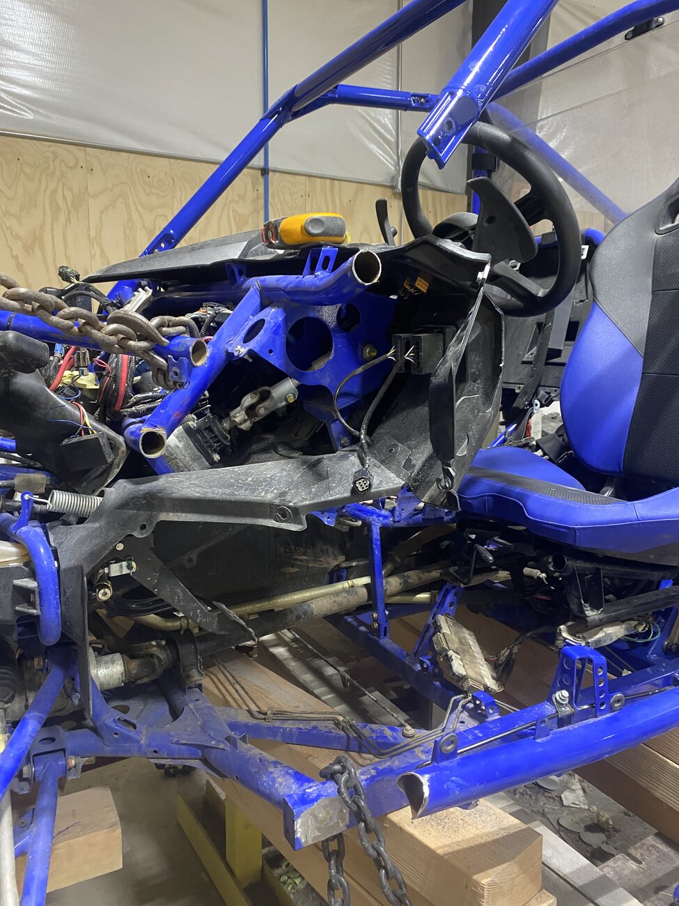

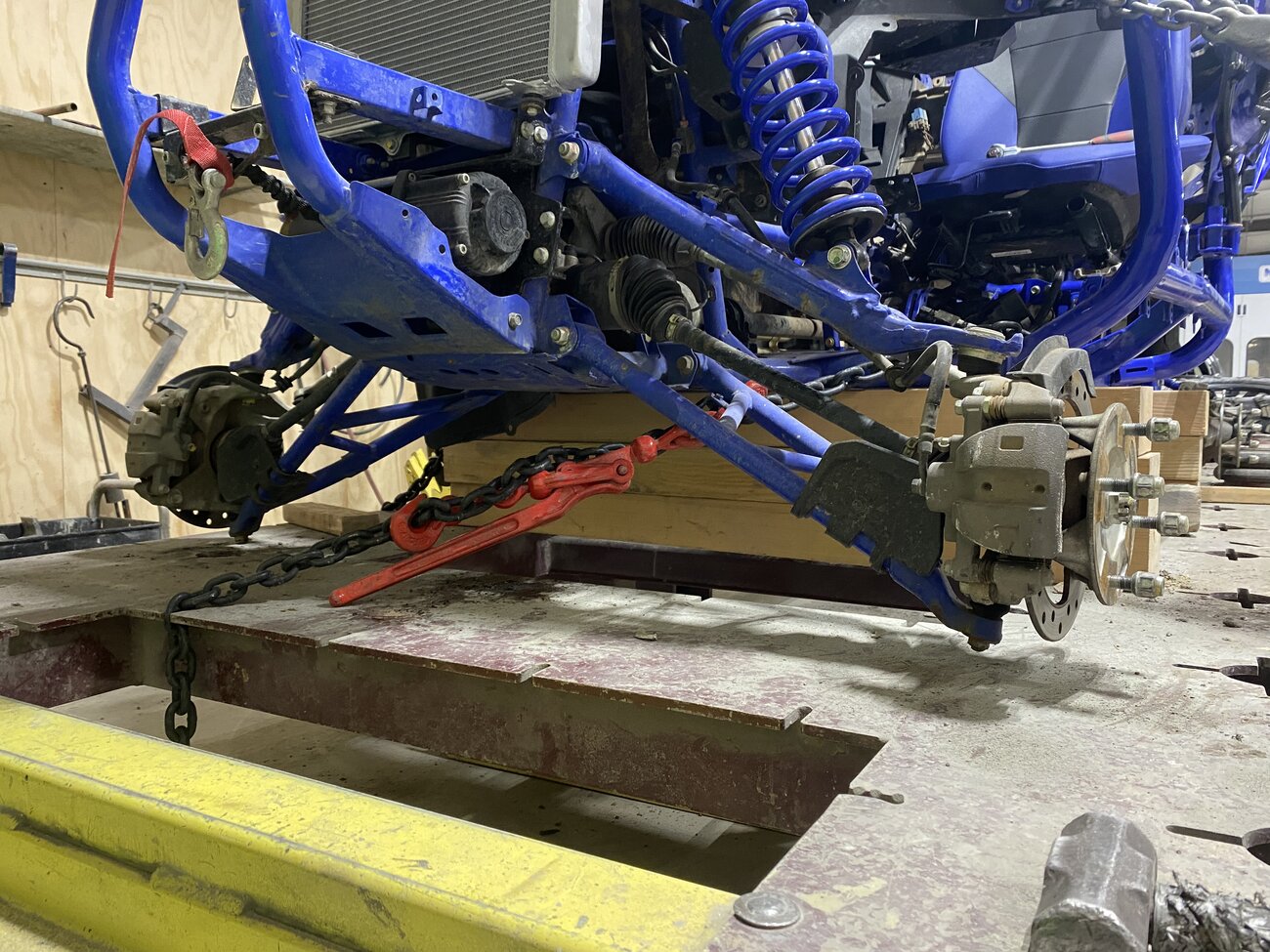

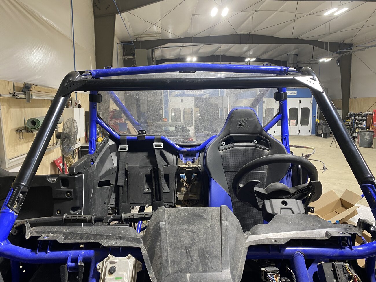

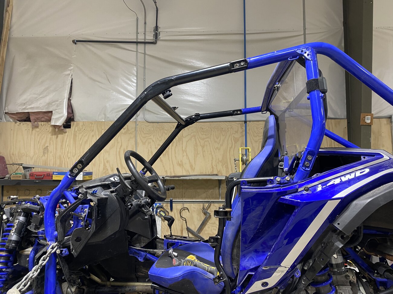

Currently waiting on parts. As far as I want to pull everything till the frame section shows up. Pulled everything with the old cage so didn’t twist the new one.
New front section of the cage now easily bolts in at three corners and is very close on left front. Cross measurements all show on the money and dash holes all line up for the first time. Rear cage section was down and forward a bit, not surprising, but now looks good. Steering wheel is straight and centered on driver seat. Suspension all sits uniform to the frame rack and cross sections under frame all match.
New front section of the cage now easily bolts in at three corners and is very close on left front. Cross measurements all show on the money and dash holes all line up for the first time. Rear cage section was down and forward a bit, not surprising, but now looks good. Steering wheel is straight and centered on driver seat. Suspension all sits uniform to the rack and cross sections under frame all match.

you da man. looks really close now, amazing what a little friendly persuasion will do.
What did you ever figure out about the shock that was leaning?
I have no f***ing idea to be completely honest. After I got rear suspension in and dropped it she was half as far off as previous. I forgot about it when I went for a quick rip last night and I didn’t look again till it came on the frame rack, it looked identical to passenger side. It was way off before but no live valve idiot light or anything ever, good now, idk.
I'd be interested to see what the computer is reading on that corner vs the other 3.
