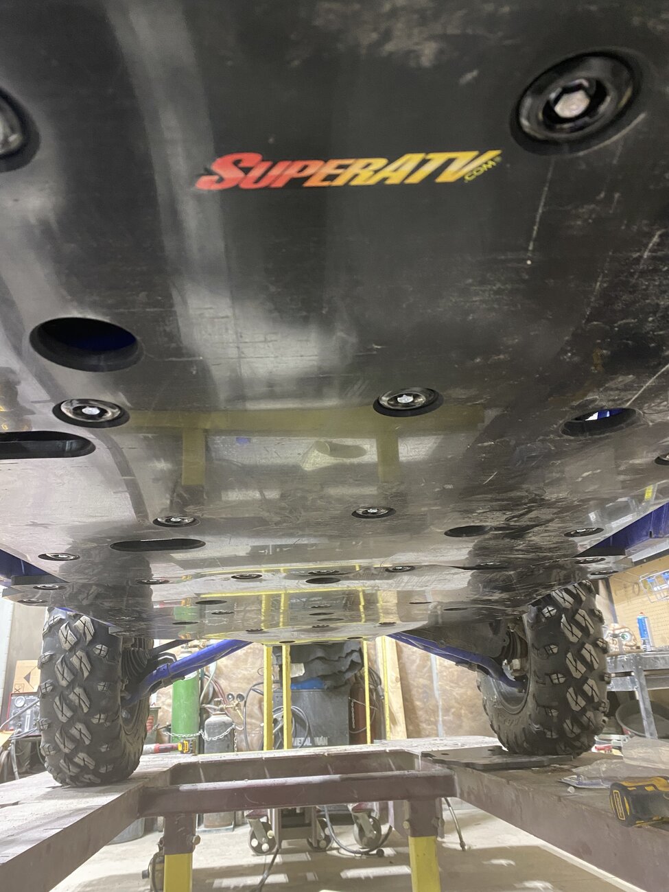

Got skids on. Looks like it’ll protect it well enough for the dirt roads. Again @SuperATV you need to package these better so they don’t get scuffed, how am I going to show off the under side of this little Princess now? Is there an improper packaging discount?
When that sticker wears off it will definitely perform better 🤣🤣🤣🤣🤣🤣🤣🤣

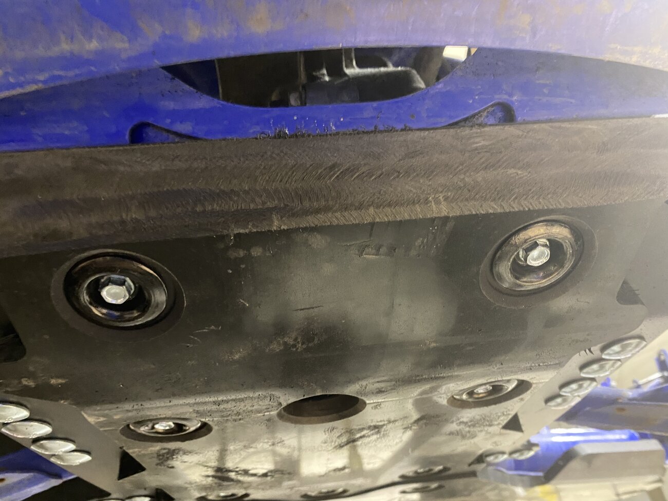

@SuperATV If I could make one suggestion though you should mention that the front edge be beveled. That edge when it hits something can be nasty not to mention it rips the skid plate off. I ground this one down
The Trail Armor has a square front edge too, mine needs beveled. I don't think I have as much material in front of the two front bolts but there's room to ease it some.
Sss on Pioneer has the same too. Seems dumb. In Tennessee I hit a rock while suspension was under compression with a square edge, went front 25 to zero in two feet, it hurt.
I remember that! It was nasty, u got some bad bruises on your shoulder from the seatbelts also
My machine routinely "grazes" the sand in G-outs and it caved in the little skid on the front bumper (within 1/2" of the winch) so when I was shopping for a skid plate, I wanted one that went more forward and protected the winch too.
The only one I found was the Factory UTV unit. It is about 12" longer up front and "curls" up the front bumper. Kind of like a ski, slides over everything real nice. They do something very similar on their Pioneer skid too.
I'm surprised that no one else does this, it only makes sense...
I like that. We could do that.

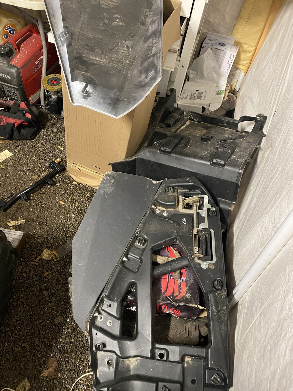

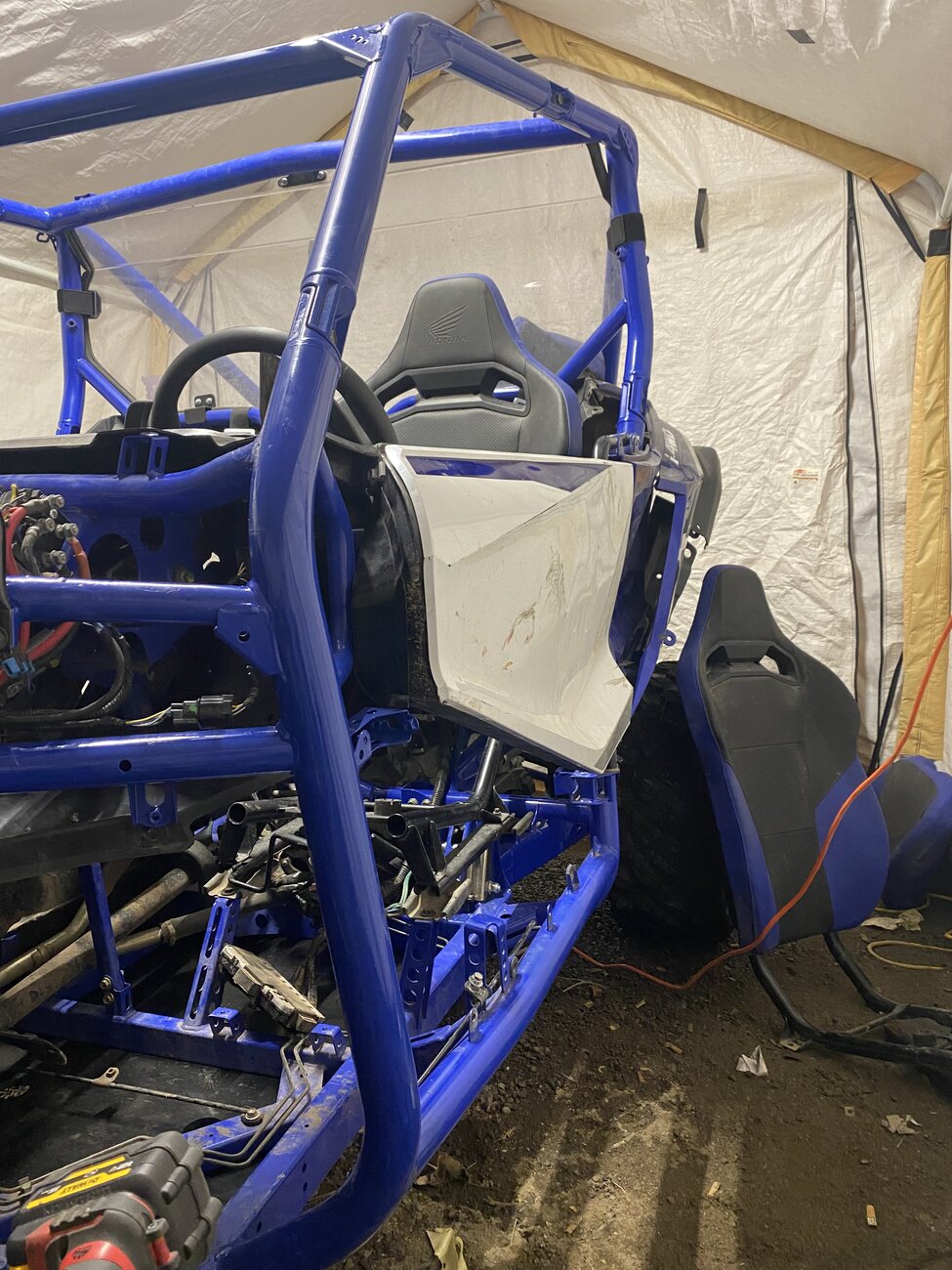

Had a little time tonight to dink off. Didn’t know the door panel was completely ripped off door, I assumed it was unscrewed but literally every mounting tab was yarded off. Took a bit to two part urethane those back on in exact spots but got it. Then had to heat up and reshape it to fit new door as a new door panel isn’t available and expensive anyways. That’s ok she’ll get some more scuffs soon enough.
Bad ass though, installed new hinge and unbent striker latch then bolted on without adjustment the where they were, must’ve done something right as the door shuts perfectly. Happy about that! Apparently a driver door is important.
