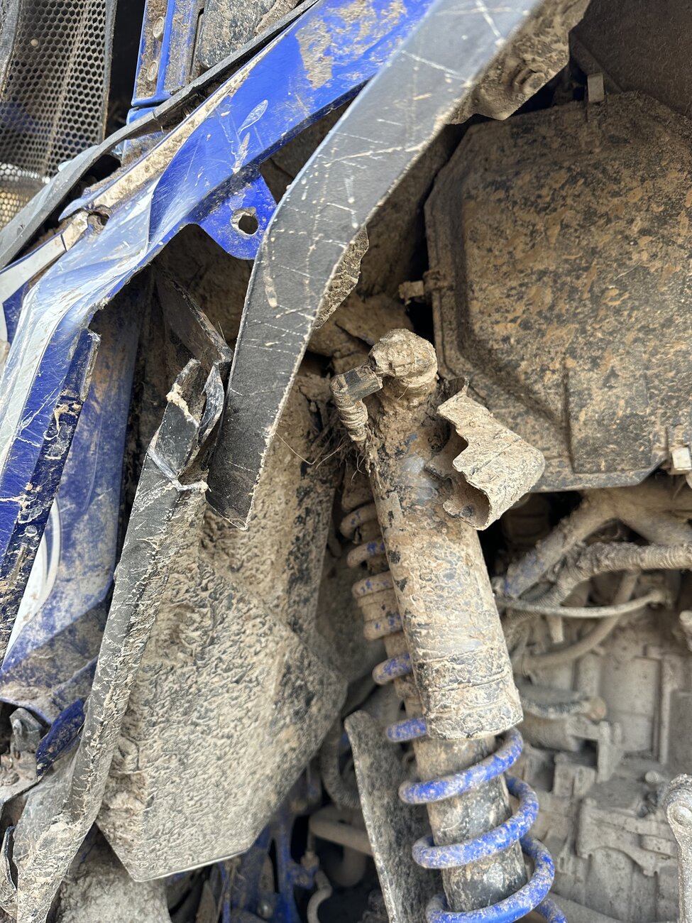

Did notice the left tie rod pretty bent, upper ball joint done and right front wheel bearing is junk. Not sure what else. Got the big zip ties and fixed stuff all over before the trip, I try not to litter lol. She’s getting pretty noisy my wife noticed, needs some love really soon but she was again trustworthy. Friend put 33’s on his Talon, I’m a little jealous but just don’t have the extra cash right now. Really liked it though

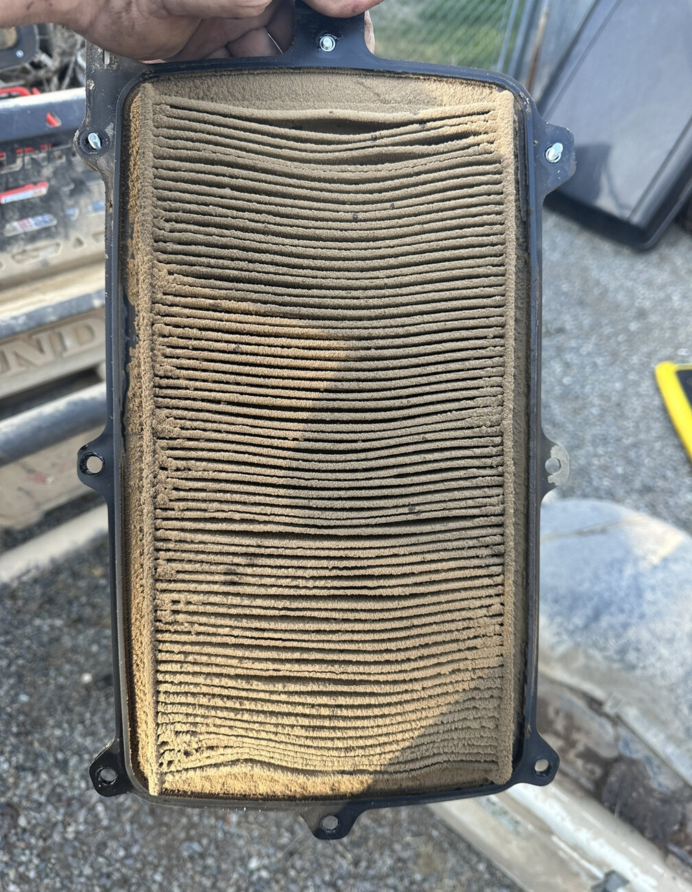

Replaced air filter, it’s original and has 5300 on it. A lot of miles considering where and how the Talon has been ridden. But, it was f***ed up! Runs a little better now!

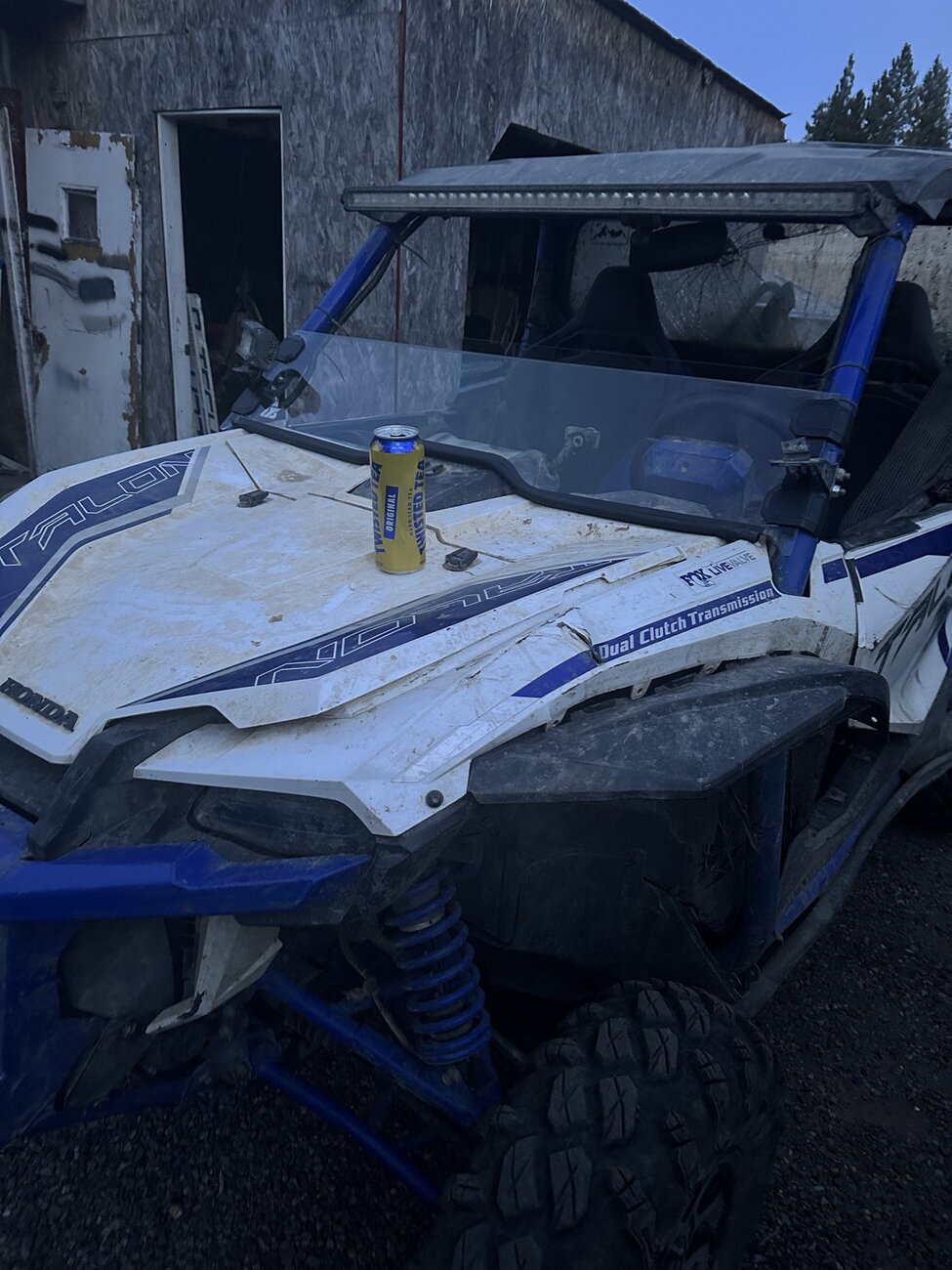

Bit warm lately so finally broke down and got a half windshield, dealt with the heat last year and up to now with full glass but over it. Bought Tusk, it was cheapest out there. Going to break anyways.

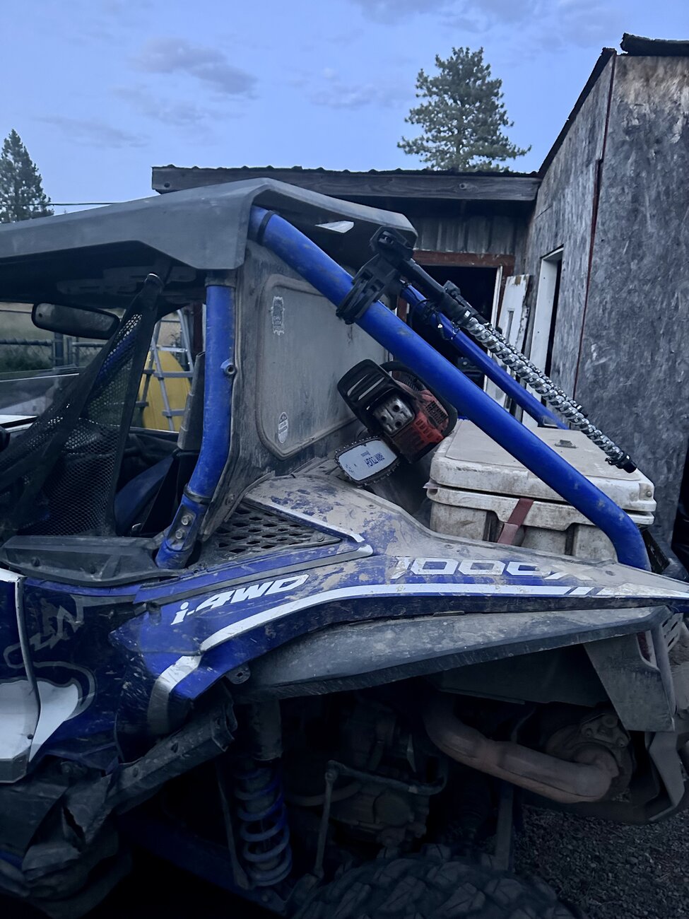

And finally picked up some whips. Bought Boss, they seemed real tough and are easily removable. Also folding mounts and only went 2ft, I’ve had probably over 12 sets between all the machines and doubt any have lasted over a month or two regardless of what I do. Really trying on this one on where I mounted, size and everything else🙏🏻🙏🏻

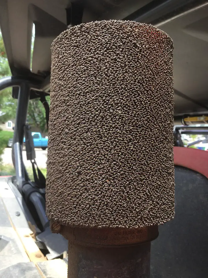

Once upon a time, I'd have been horrified by that filter but not anymore. Most heavy equipment uses pleated filters in environments as bad as the Talon's and they do just fine. Guys are replacing their filters much too often IMO. I love my snorkel and oiled foam prefilter but I'm not sure it would last in your environment. :oops: The advantage to a snorkeled prefilter is that you can see it without taking the stock airbox nightmare apart (and hoping you don't cause a leak) - and change it with a spare in minutes.
I also believe that guys clean their foam filters too soon. This was filthy at 600 miles IIRC. :eek: The problem is that the primitive FI on our Talons doesn't sample and adjust when running, it only samples just before start-up, not when the engine is running so it can't lean out when the airflow is restricted, its only knowledge is the preset mapping. :(
I do run prefilter as well. My local friend was changing filters every about every 250 miles prior to mine, I wasn’t going to deal with that so ordered us both one. I’ve only washed if a few times but smack the dirt out every so often
