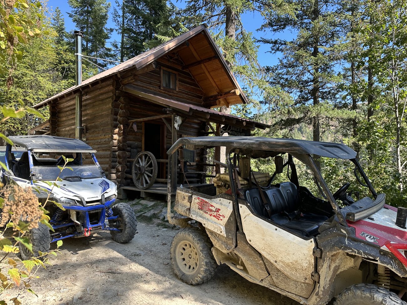

Great weekend. Daughter asked us to come up and go riding in an old favorite spot, of course we’d come up. She took the Pioneer and off we went. Wife drove Talon half the day. It’s weird because I never felt totally comfortable riding shotgun in Pioneer with her but in the Talon I just kick back and enjoy the ride.

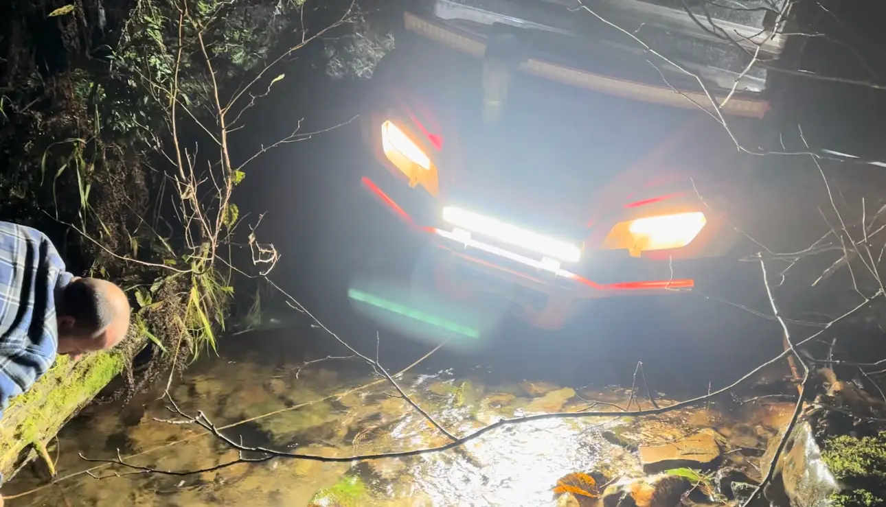

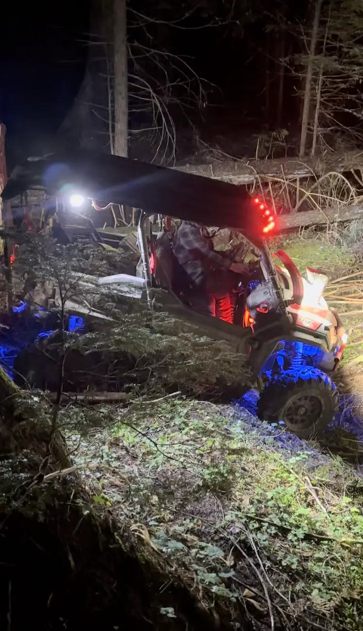

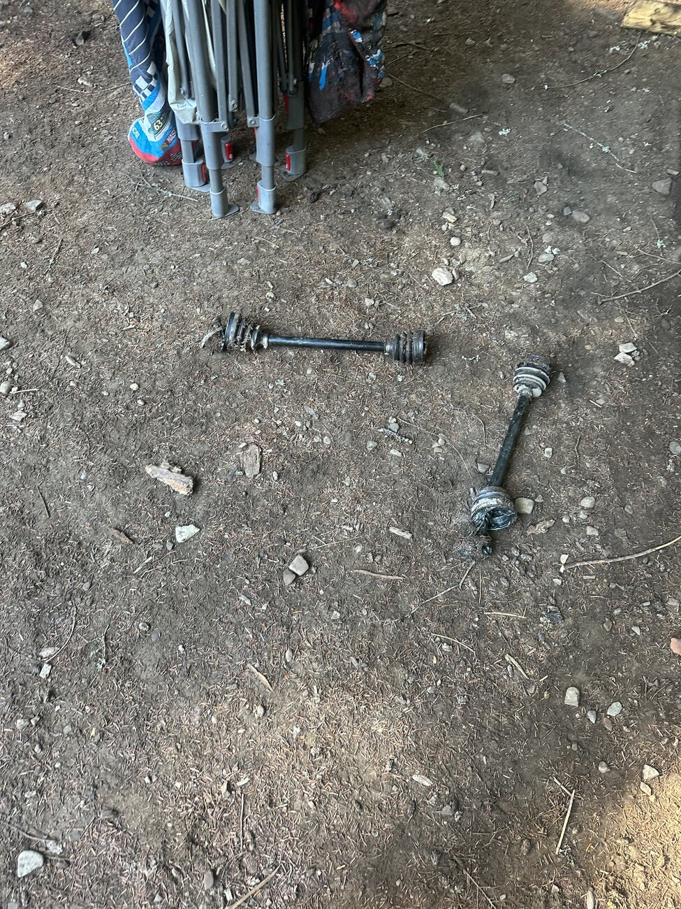

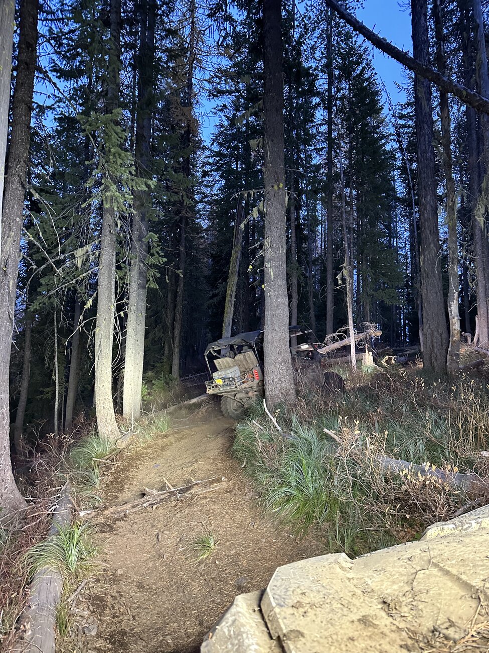

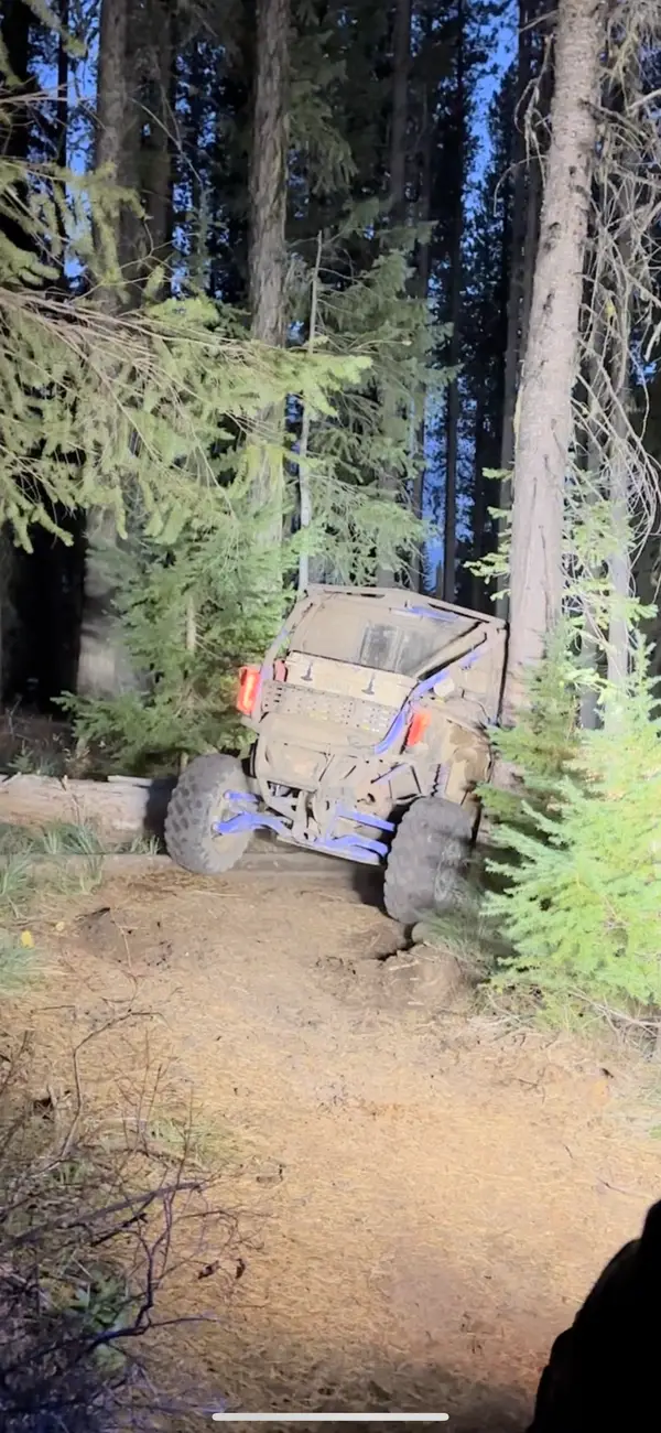

Learned something new. When you pull both front half shafts you have to run it in 4wd so front speed sensor reads. After we pulled them it threw codes and wouldn’t shift. Took me just a minute to figure out.
Buddy’s JAH spit both front shafts at once this weekend. Need some new @SuperATV 2.0’s! Tbh we were definitely doing crap we shouldn’t have been on a night ride. Had to pull it out and up the bank with Talon, was sketchy.
Buddy’s JAH spit both front shafts at once this weekend. Tbh we were definitely doing crap we shouldn’t have been on a night ride. Had to pull it out and up the bank with Talon, was sketchy.

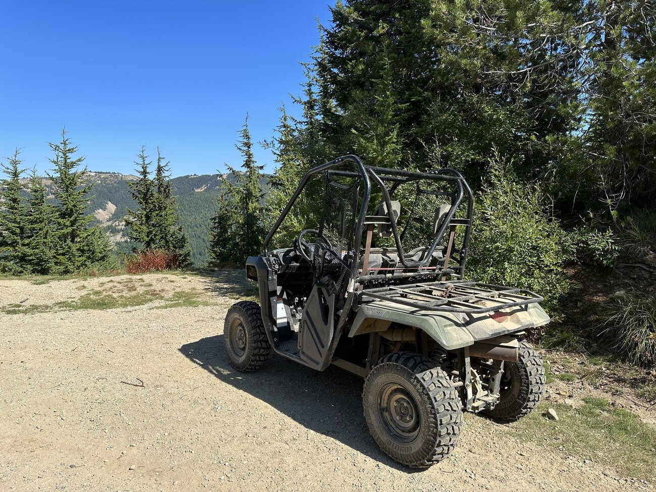

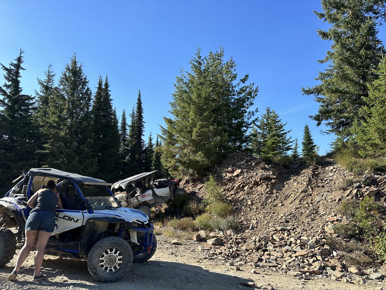

That damn Pioneer was impressive in 2wd. It was ran hard the next day fully loaded, we did well. Talon still going…More zip ties then then a bear has hair but still going

🤔....some say them Junk Ass P1Ks can't do shît in Turf or 2WD modes........🤷‍♂️😂😂😂
Watching it go up a 45deg shale rock hill over downed trees with my friends family inside in 2wd was impressive. I’ll leave it at that.

So you left the cv spline ends in both the diff and the hubs?
What would happen if you had to do this on one side of the rear? Have to drive around in turf mode? I got to thinking about it last week because a Polaris Ranger guy told me if he breaks a rear axle he's dead in the water. I was pretty sure I'd be able to get out of the woods with the Pioneer.
Yes just left the two ends in, no axles. Nice when they break on outside edge, then you just take boot off inside one and find clip to slide it off and pull it. Takes couple minutes and only tool is pocket knife.
If you took one rear out turf wouldn’t work, any other selection would.

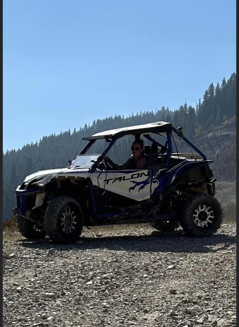

Well 3 sets of tires already in a year and a half. Set 4 going on. This machine now has double the miles of anything else I’ve ever owned, including the most recent Pioneer and Wolverine. Seems like tires and fuel for this ol POS. Oh and a set of brakes lol.
Tires aired down, gunna be some shenanigans deep
In the hills this weekend.
