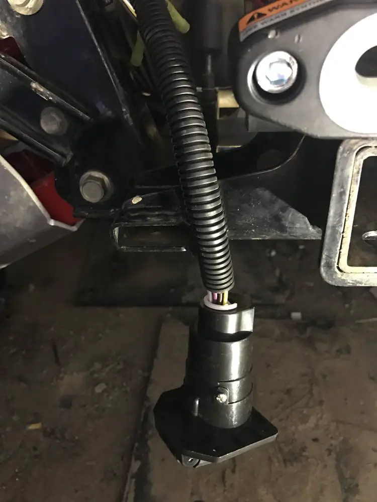

Finally got around to wiring in taillights for turn signals. While this is being done the 7 pos trailer plug gets installed. It'll have trailer brakes before too long.

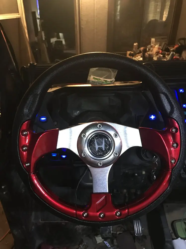

I suppose and would be nice if that was needed. I did see that but its lots more money and it keeps your fingers further from the paddles. That was a big part of our issues we're keeping the steering wheel where it came in relationship to the paddles. If that wasn't the case this would've been done for 25$ and been done long time ago. Really worked hard on this one.
Heated would have been nice definitely sometimes. But we can now pick and choose steering wheels for 20$ and have good horn gave us another spot for switch lol. I really like making my own stuff over buying it if can.
I'm super interested in doing the horn mod!

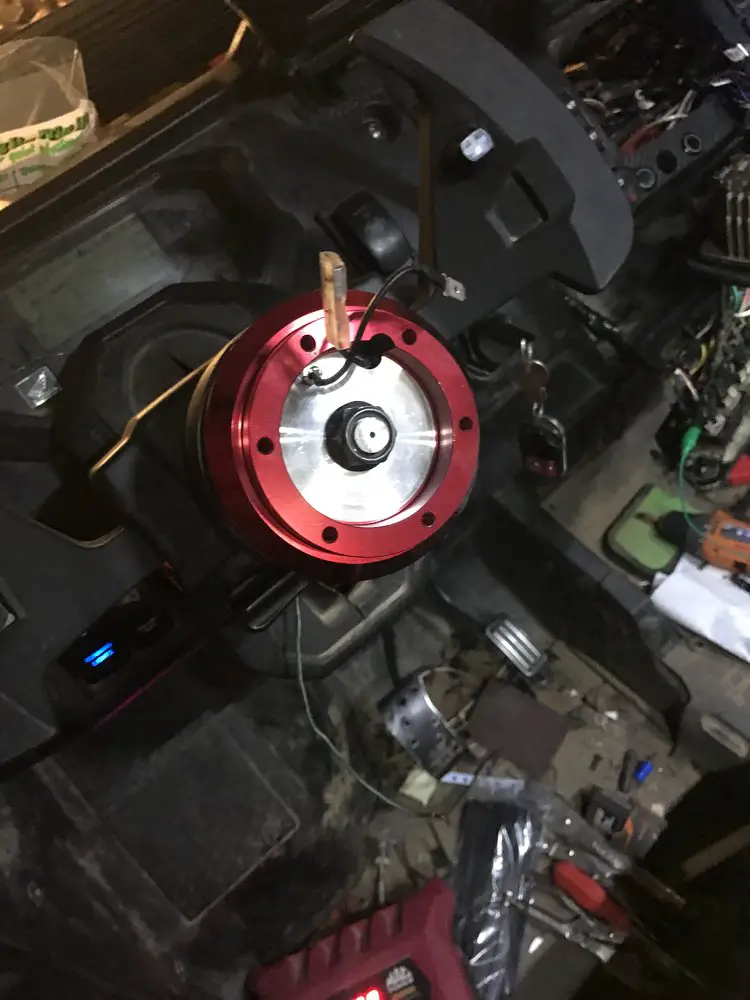

Been very busy on side projects last couple days to start building cash for the Takeover trip so Puddle Jumper hasn't had anything done to it for a bit.
Finally got everything for the steering wheel and this mod can now be done with very little work and pretty reasonable. Anyone interested pm me but don't just start buying things it has to be in right order or gets expensive I'll promise that. Anyways new wheel installed correctly! Old wheel can go right back on (if ever wanted) horn takes a bit more but very reasonable just have to be committed.
View attachment 39051 View attachment 39050 View attachment 39052
Fits very good didn't leave anything just be it had to look and fit perfect otherwise I wasn't doing it but persistence paid off
That's pretty slick bud! It will be nice to have the horn where it supposed to be.
Really wanted it there! Honestly almost gave up but that's just where it should be and my wife gives me enough hell I usually get it done
