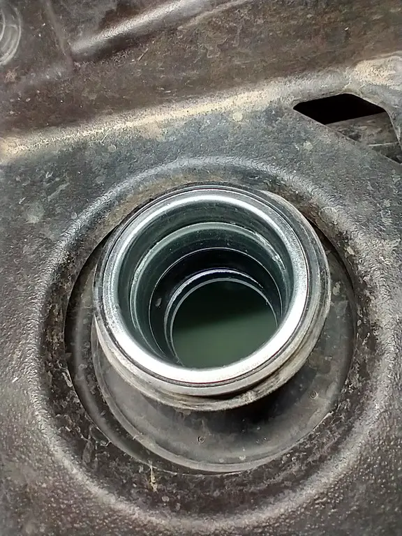

I haven't put a hole in the filler tube, I just removed it. It can easily go back in.
Tube in place
IMG 20200527 214008992 HDR XL
Tube removed
IMG 20200527 214028429 HDR XL
Tube
IMG 20200527 214145763 HDR XL

Lol, I got it out, not so nicely as you did😝 Mine is not going back in, it's going to the trash! Thank you so much for posting the pictures, that thing has been driving me crazy every time I fill up👏🏻👏🏻👏🏻😎

How did you get it out?
Sorry, I know it's too late for you, but for the benefit of others... I used a sharp pick between the plastic tube and the metal sleeve in the filler neck to pry it a little. I don't think this next step is necessary, but I didn't know it at the time... I used a sharp utility knife and started to vertically cut the tube from the top. I saw that I now had something to grab onto so I grabbed the plastic tube with a pair of needle nose pliers and with a twist and a pull it came right out. At this point it would be easy to drill a vent hole in the tube or leave it out. Either way there is a chance of excessive fuel venting as Paul F previously mentioned, which will result in an unwanted fuel smell in your cab. I plan on looking into extending the fuel tank vent, just haven't gotten around to it.
