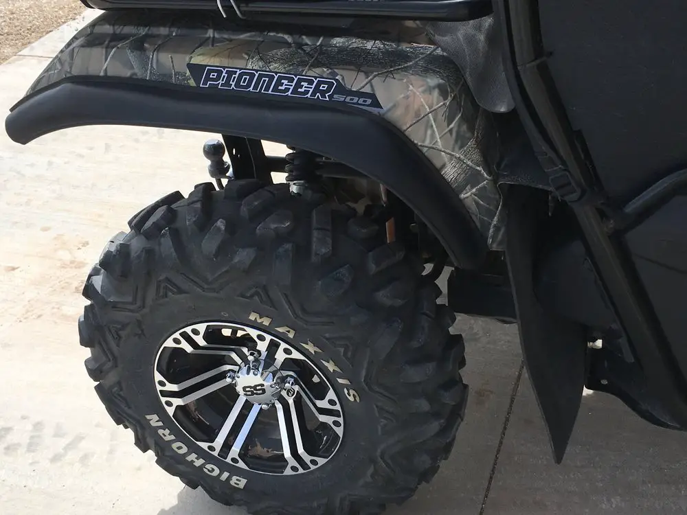

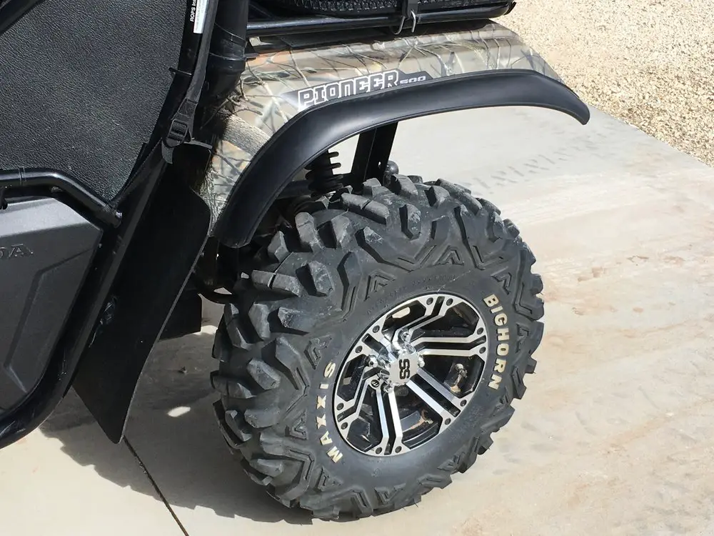

Here few pics from this morning. Fits just perfectly.
IMG 20170305 112420601 HDR
IMG 20170305 112427413 HDR
IMG 20170305 112447265
Sent from my XT1585 using Tapatalk

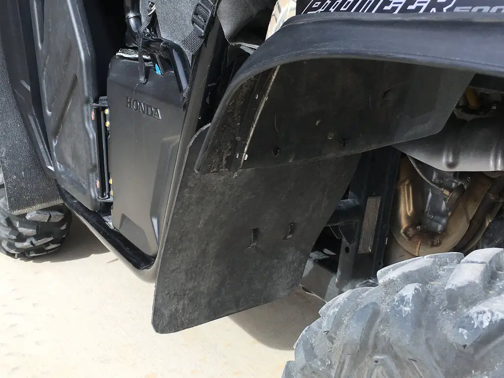

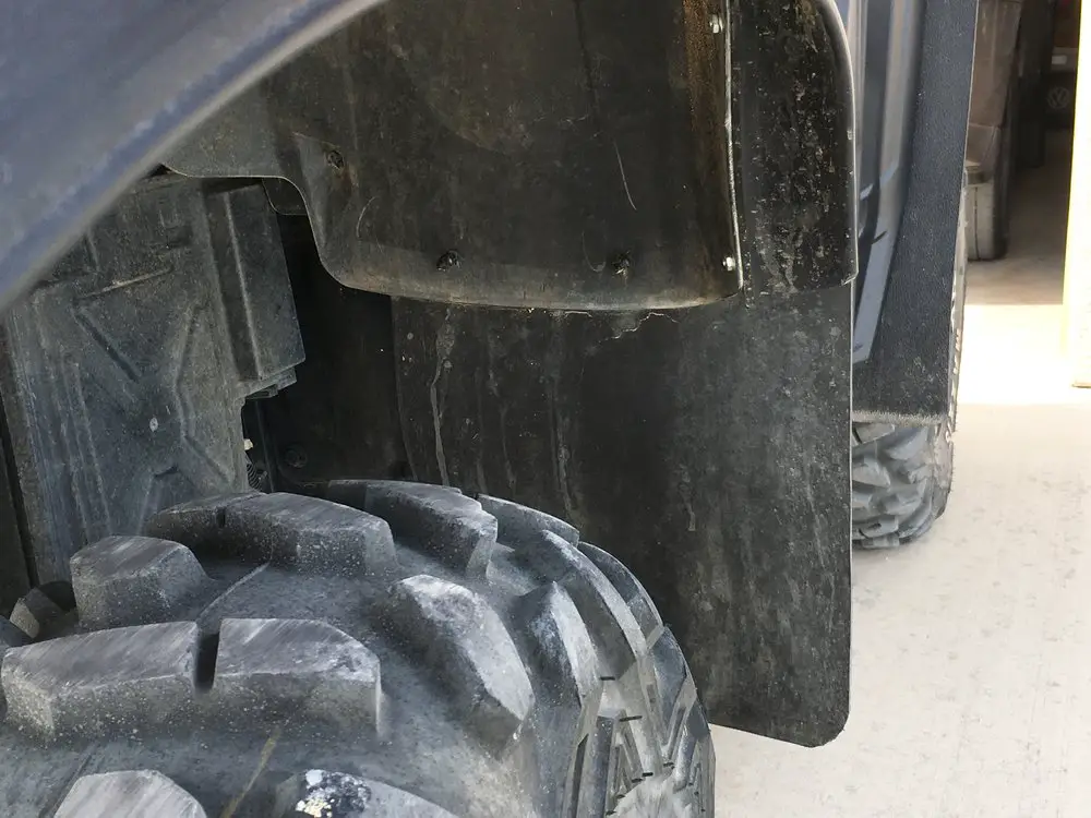

Finally added the Flexi-Flares and some mud flaps to the rear fenders to reduce the mud thrown forward toward the cabin. Used larger plastic push pins to attach the flaps to the fenders and heavy duty tie wraps to hold the flap to the frame on the driver's side.
IMG 0275 IMG 0278 IMG 0279 IMG 0280
