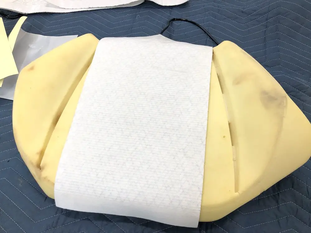

The kit works fine as is for the bottom.
49201439733 4677daaf6f b

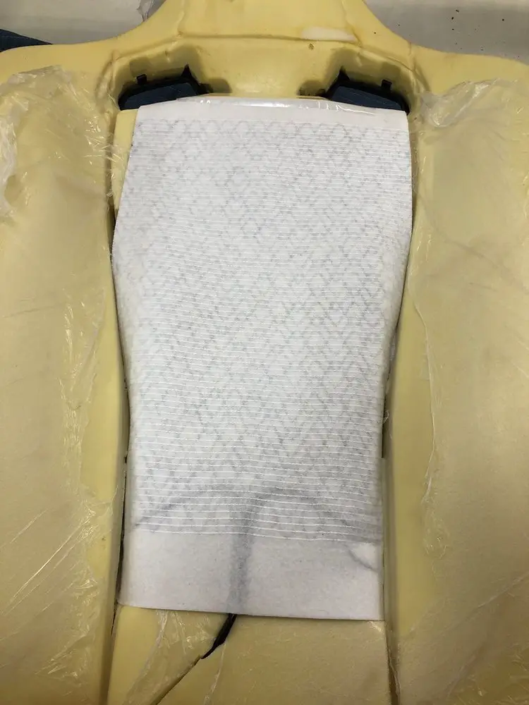

The back was a different story. The foam for the back was too narrow to properly fit the heated pad. I finally figured out that if I cut thru the foam I could tuck the pad in that slot. Seems to work fine. I also cut a slit in the foam to hold the wires.

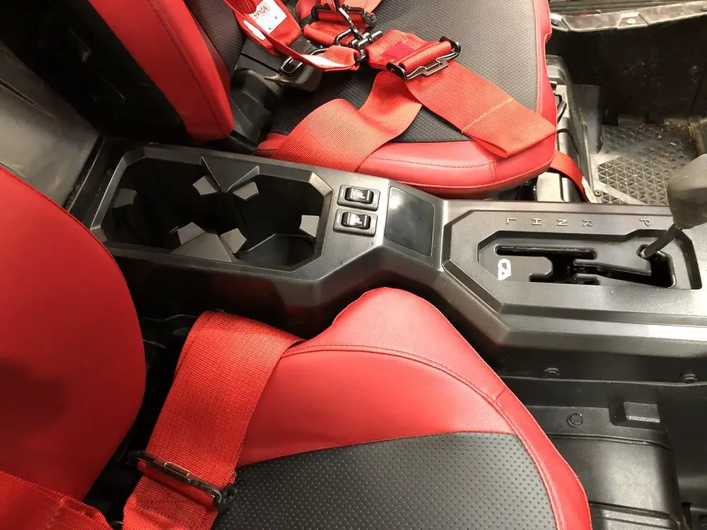

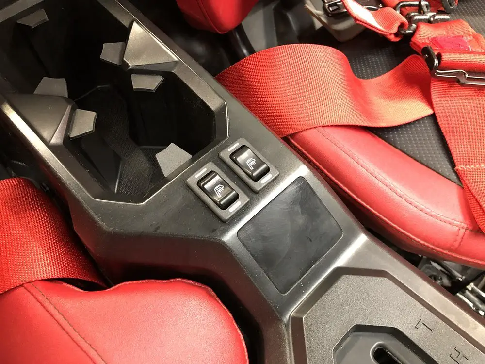

There is a seemingly perfect spot for the w=switches in the console where the trans warning label is but it won't work. The left switch will not clear the shifter bracket. Cost me a console top to rind that out. :eek:/ Thankfully Honda sells the console top for $12.

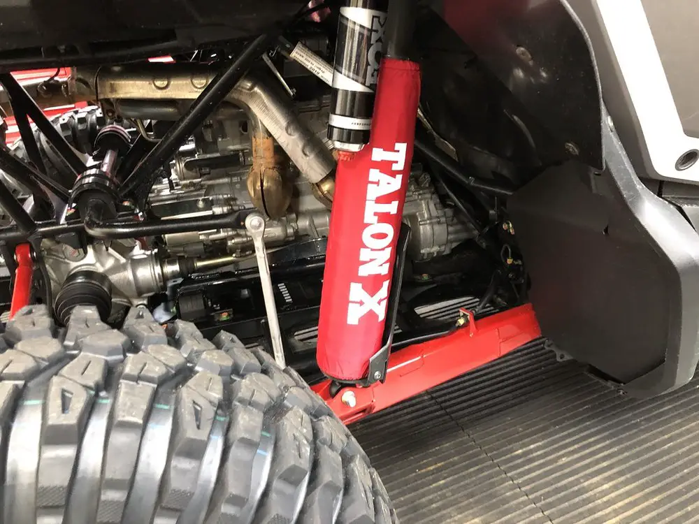

I also received some custom made shock covers thtat I ordered a couple of weeks ago. They are made by a lady that came highly recommended by Ted at Bandit UTV. The covers are top notch work.
49250521698 c98bf13b19 b
49251199397 9ac6a262af c
49250521938 33fa97d303 b
