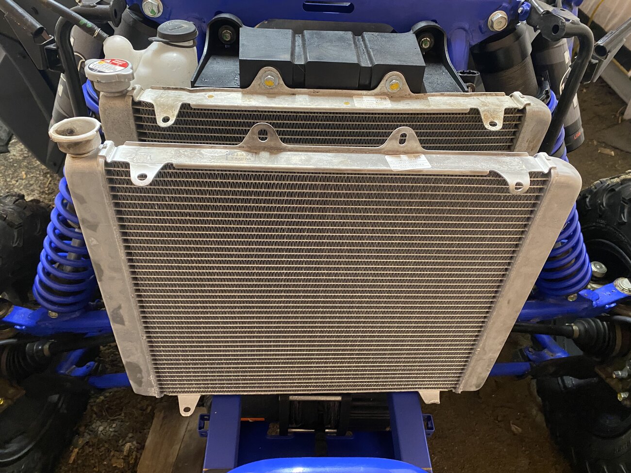

New radiator showed up. I’d heard that they sometimes come in bunged up and people b****ing about it. So I called around to multiple dealers and sure as s*** found one with a couple bent tabs. Worked to my advantage saving 75$ for a 1 minute fix lol. Learned that trick with Honda parts years ago on pioneer by calling around and finding broken factory windshield then having tinted glass cut for it, saved almost 300 that time. Not scared to try to save a buck.

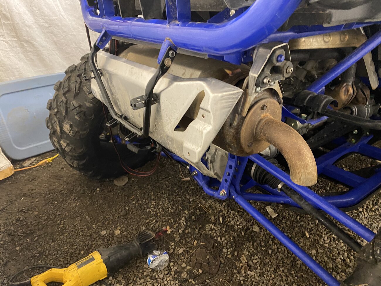

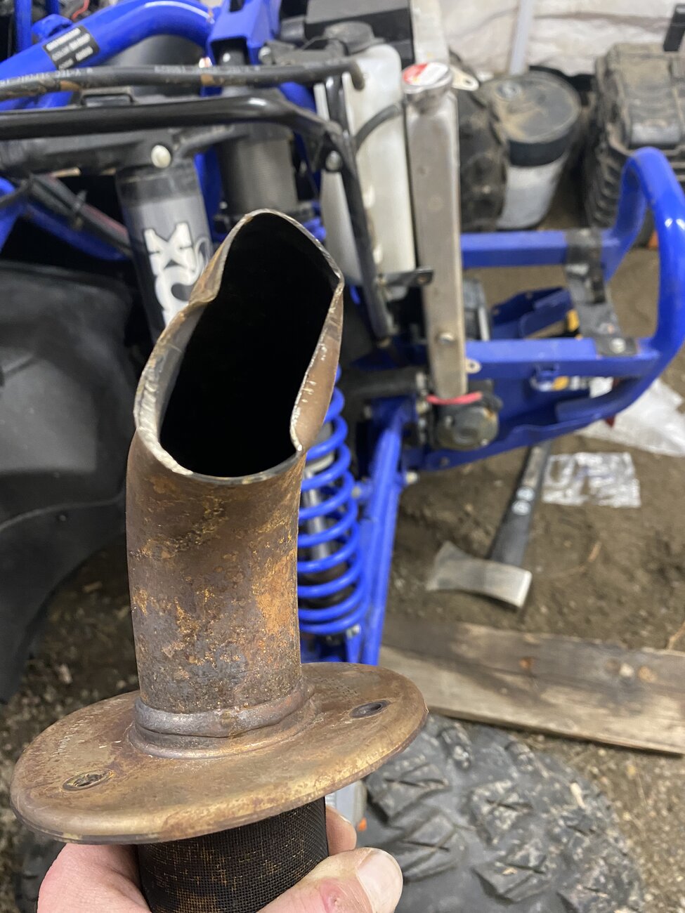

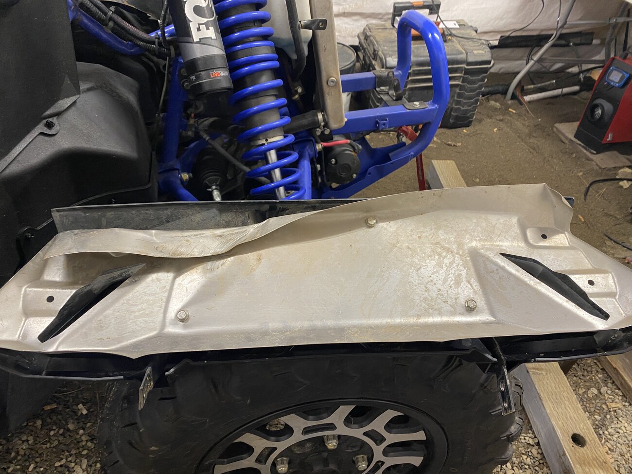

Busy working on the rear of the machine. Exhaust got hit pretty hard, bent up the exhaust tip and all frame/exhaust mounts fairly good. Ripped a tab out of ROPS that attaches the exhaust cover and destroyed the cover mount and heat shield.
Straightened and rewelded the ROPS mounts, heated up and bent back the mounting bar for cover, hammer and dollied around heat shield, heated up and got the cover straight and installed new tip on exhaust after straightening up the brackets and exhaust hangers.

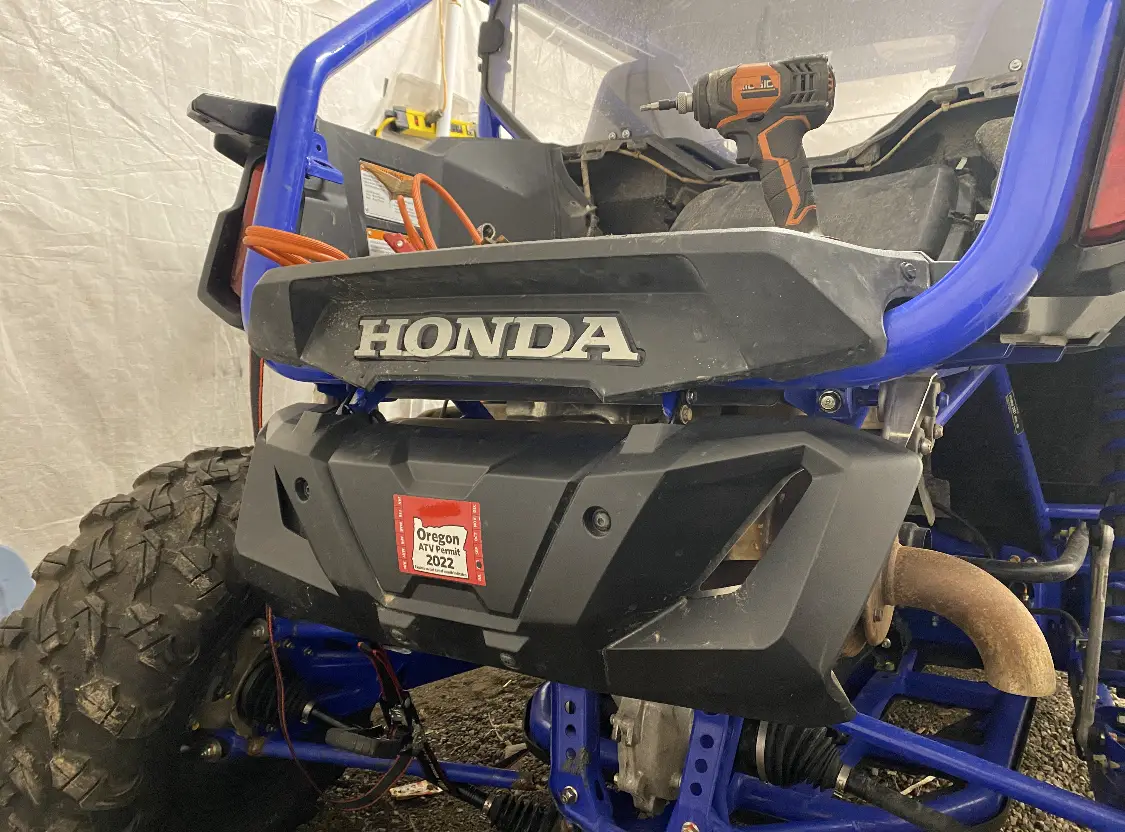

Other then cleaning up welds and the blue paint at least the rear section on the machine is done.
Going to go through the machine and get everything straightened out then pull back off and do bodywork and paint around.

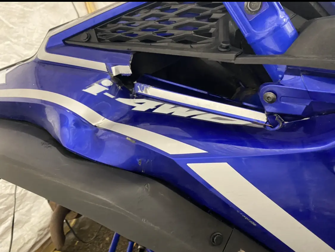

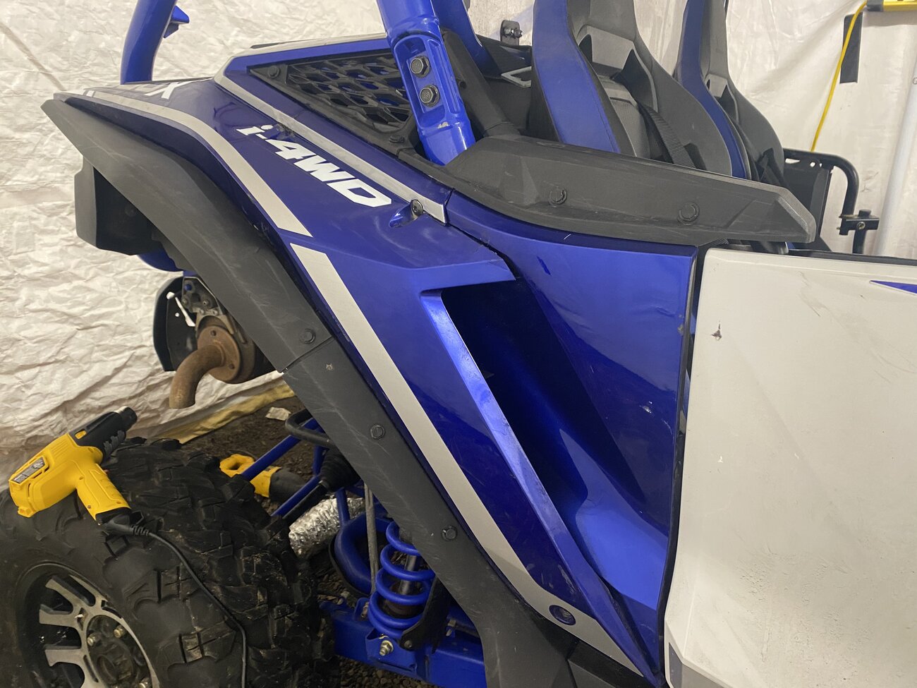

Not a new passenger rear fender but looks better. Heated it up and reformed it, used a very good urethane panel bond in the backside, reformed and rewelded the broken roll bar mount then replaced some of the decal with automotive silver stripe. Rear fenders aren’t available so this is as good as it gets for now.
Could’ve bodyworked and painted but I’ve seen this area get waisted several times where we ride anyways so I’m ok with it. From passenger front door to the driver side taillight is now done. Baby steps lol.
I’ve seen this area get waisted where we ride anyways so I’m ok with it. From passenger front door to the driver side taillight is now done. Baby steps lol.
And what's wrong with that, nothing!
