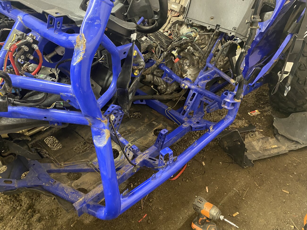

Alright getting down to the heart of the damage. Everything on the lower frame I trust, I’m not seeing any continuing damage further then originally thought, it took it all right at the dash and stopped at the structure under the door. Did find a couple cross threaded bolts that I’m sure was factory, kinda hate seeing that still showing up years after my ‘16’s. But I know that’s common in other makes.

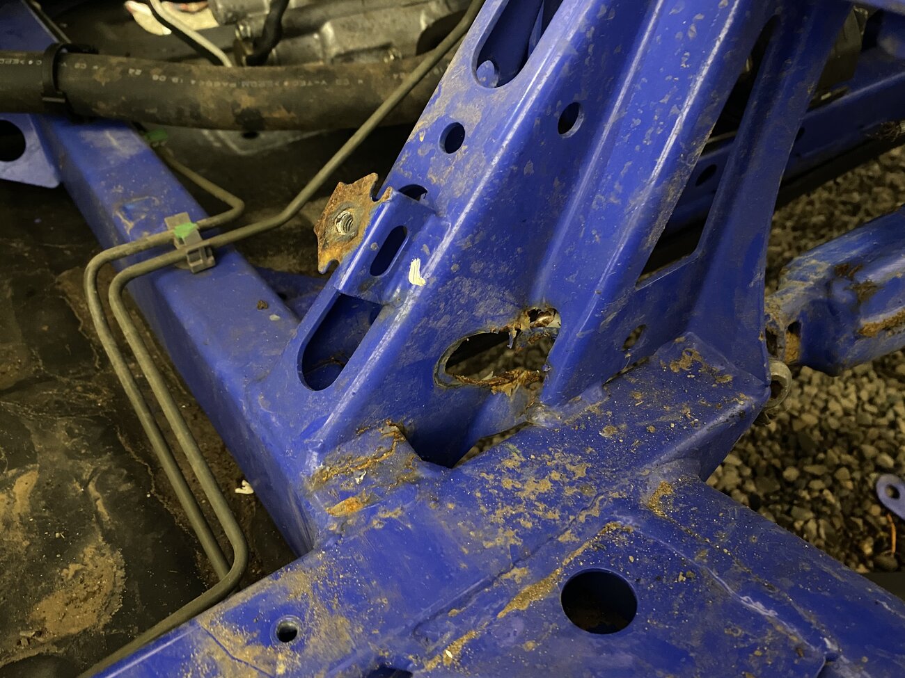

Here’s damage from Trailing arm being ripped off the machine. IMHO that looks a little weak, it was double sheer like front but tore that out too, looks like I’ll beef both sides up a bit. It did take a hit though, bolt is bent and bushing is shot. I’ll get them coming.

Get RaceCo's trailing arm pivot braces, ive seen a couple units with those mount holes enlarged from regular use.
We're a dealer for them, i can possibly get some in the box when we send the rest of the stuff if we've got them in stock.
