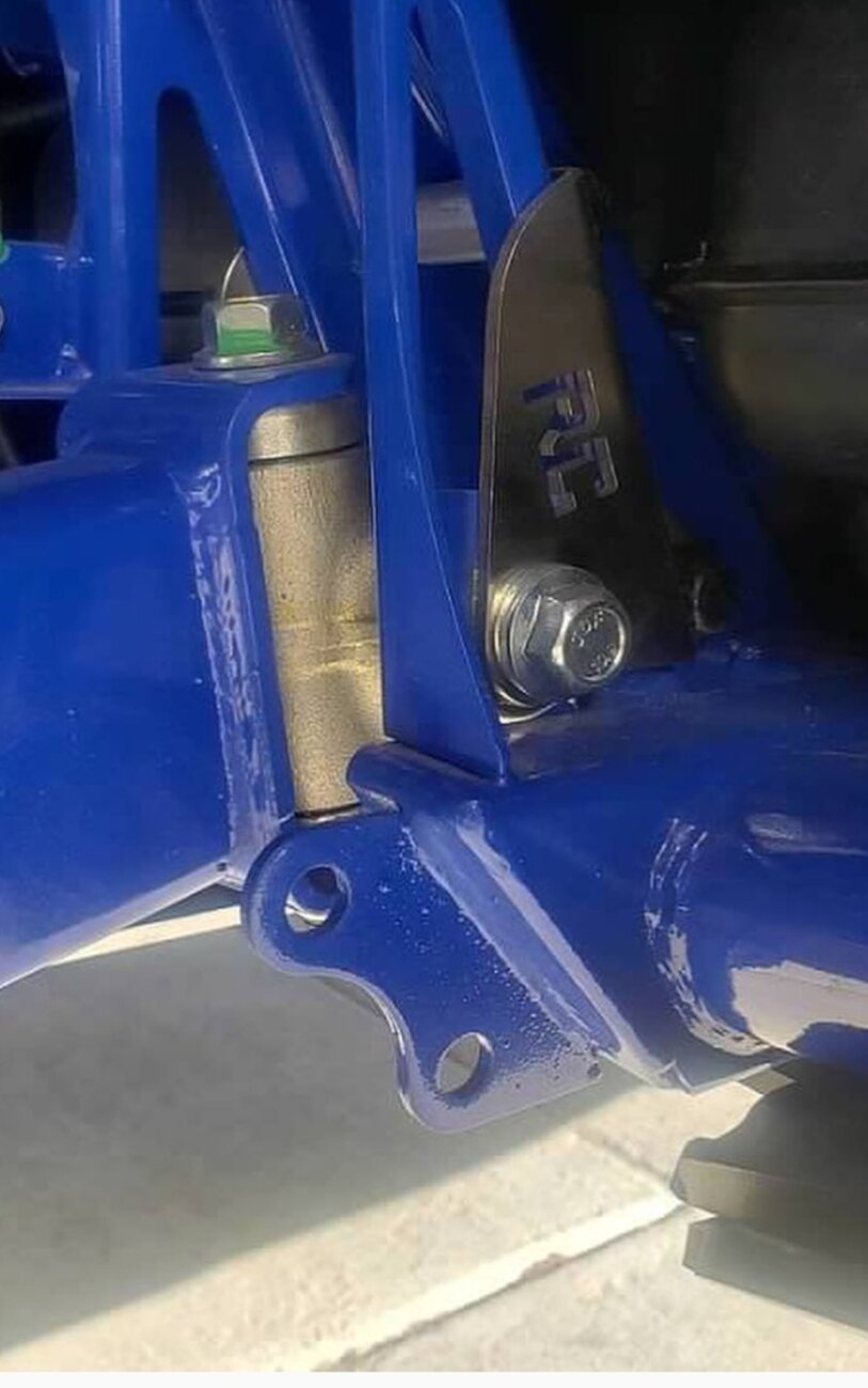

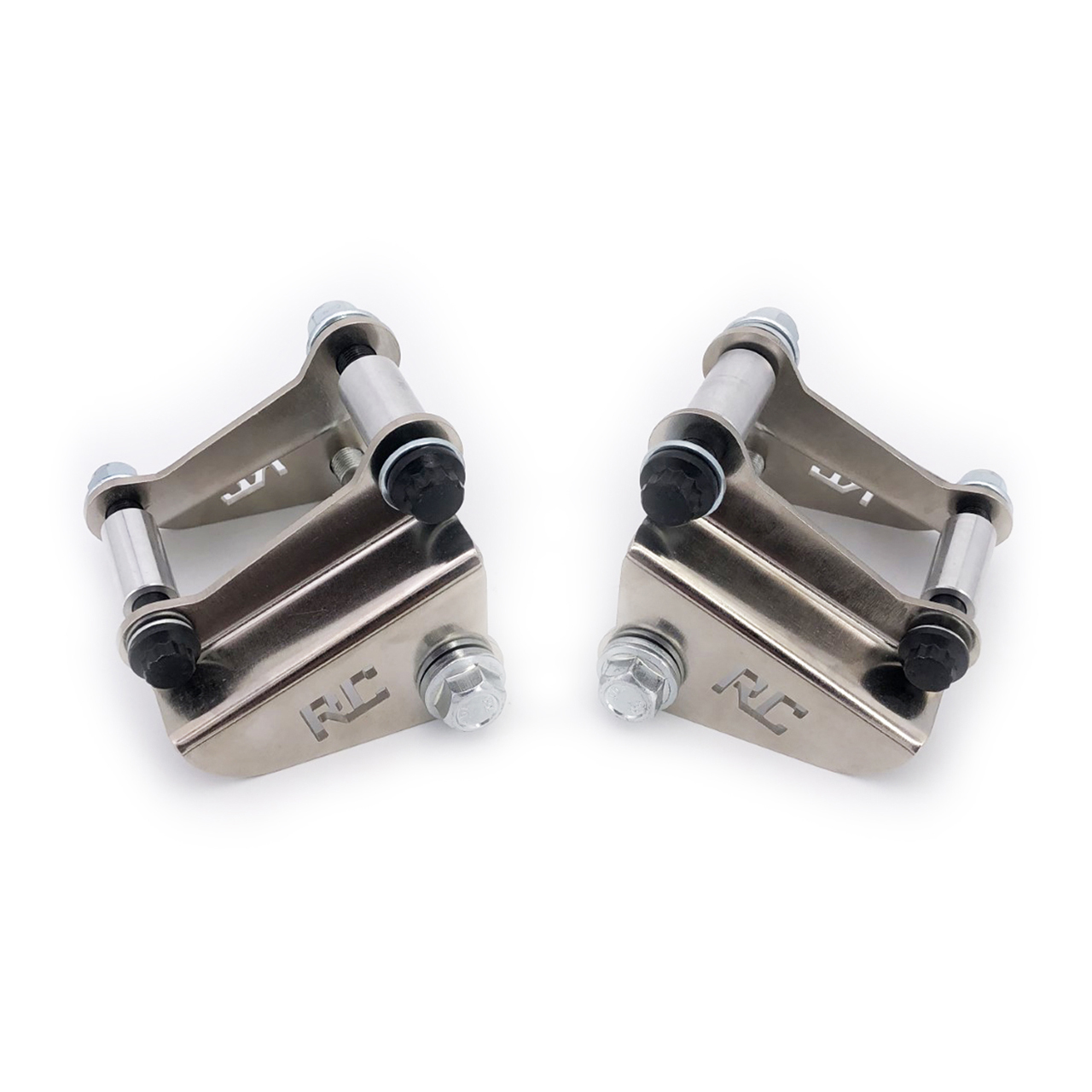

Get RaceCo's trailing arm pivot braces, ive seen a couple units with those mount holes enlarged from regular use.
We're a dealer for them, i can possibly get some in the box when we send the rest of the stuff if we've got them in stock.
Id have it together, but ive been on Georgia since Friday View attachment 316384
Well damn I see how those would go right in. Ok so I’ll just cut out the torn section and replace with same gauge steel and use those, that would fix it up nicely. Good call. Alright add those onto the bill if you will.

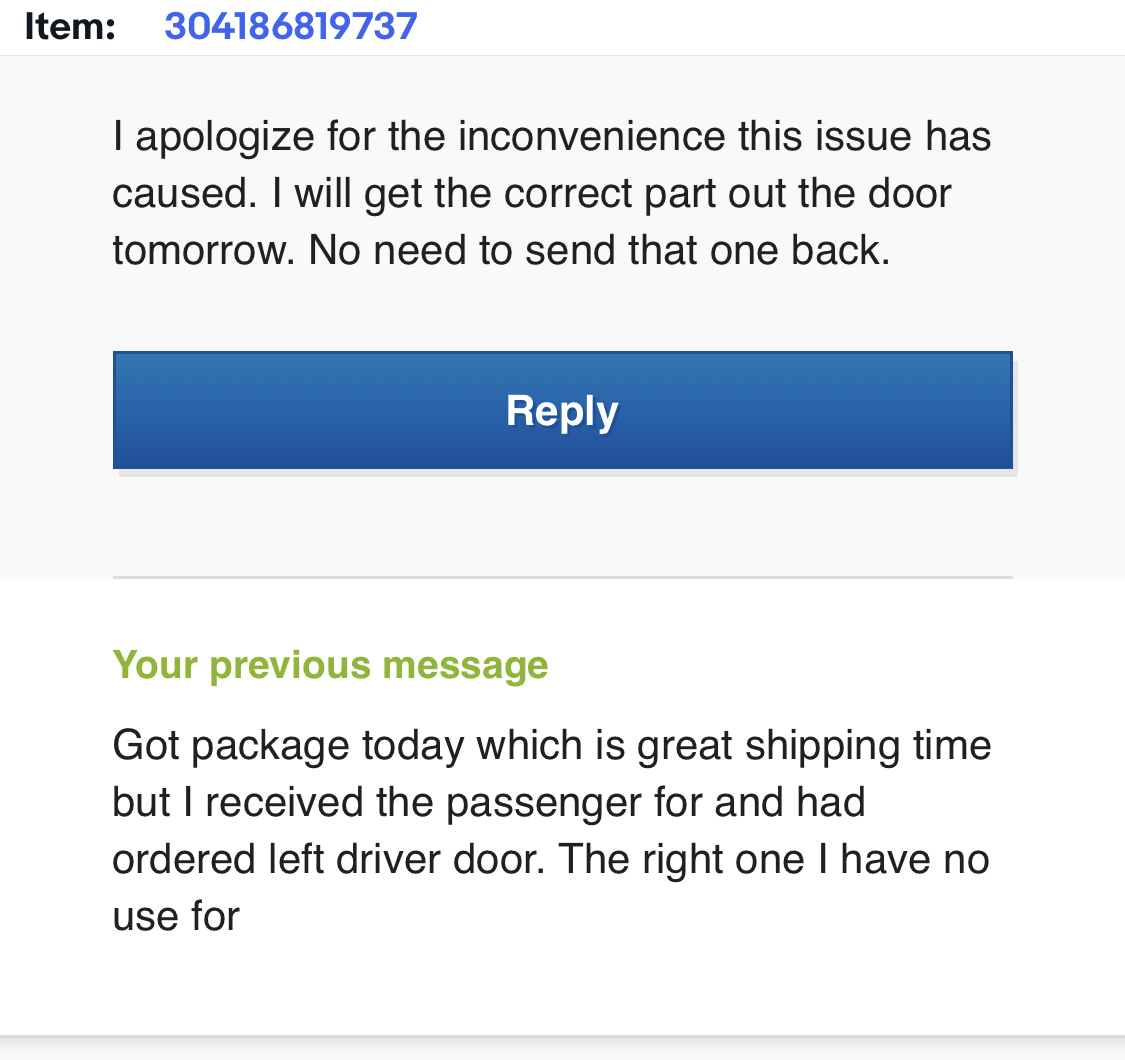

Just a positive shout out to Powersportsnation that’s selling used UTV on eBay. Most of the part I have bought through them, they have been on top of shipping and responded to every question quickly. Very good customer service. Part showed up today and unfortunately was wrong side, here was the response. Hard to get that kinda service right now

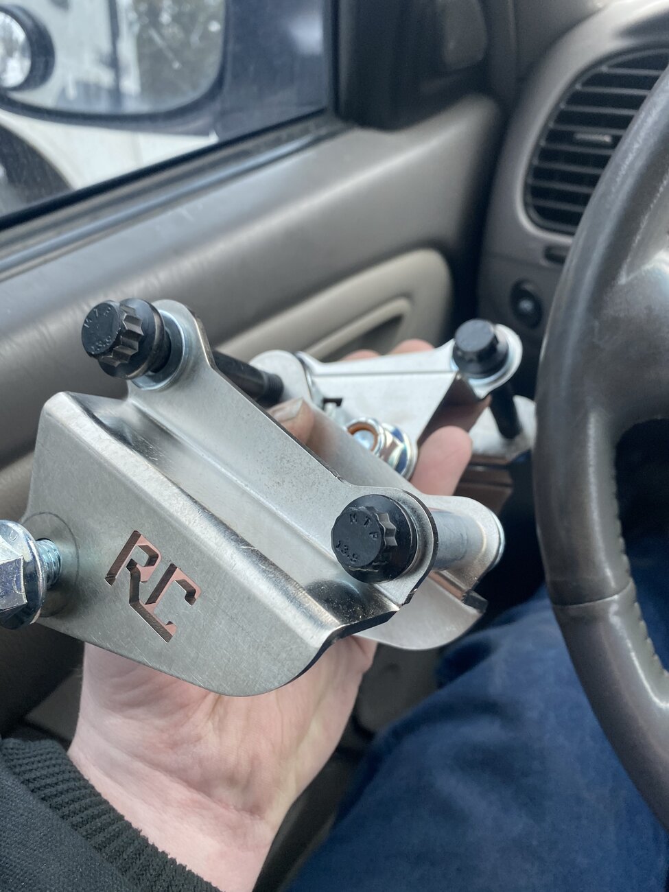

Got the trailing arm braces that @HondaTech suggested. Looks exactly like what I needed. I wanted them before welded up the torn factory mounts so make sure they can still have clearance going in.

Dayem, the previous photo made them look MUCH smaller, those things are YUGE!!! :oops:
I’ve got big hands too. I thought same thing. Was worried a little it was a little of a gimmick but then picked up the box and thought holy crap someone sent me a brick. Opened up and immediately didn’t feel so bad about the price. Very well made and I totally see now how they work. They don’t rely at all on factory hole. Should last.

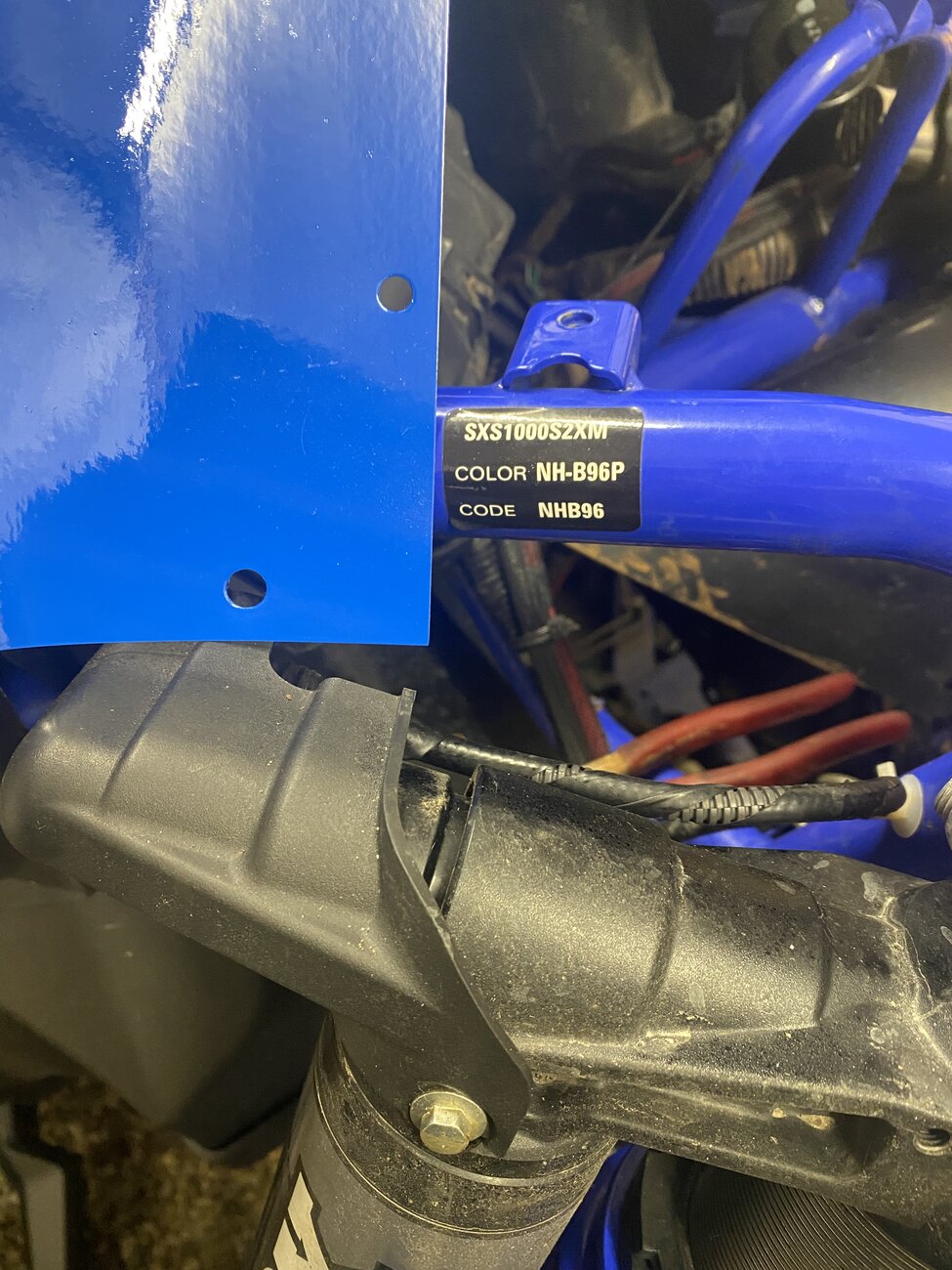

Oh and wtf? What’s this paint code even mean??? Doesn’t pull up in any automotive paint that I have access to. Grrr. Did spray out at work with closest color I could find by memory alone, not even remotely close. Going to have to bench mix.
4F130EF2 B580 47EF 8692 B59D87E3BF84
35,975
212,826
Wow, the master is scratching his head. HA! You be the man to pull it off!
