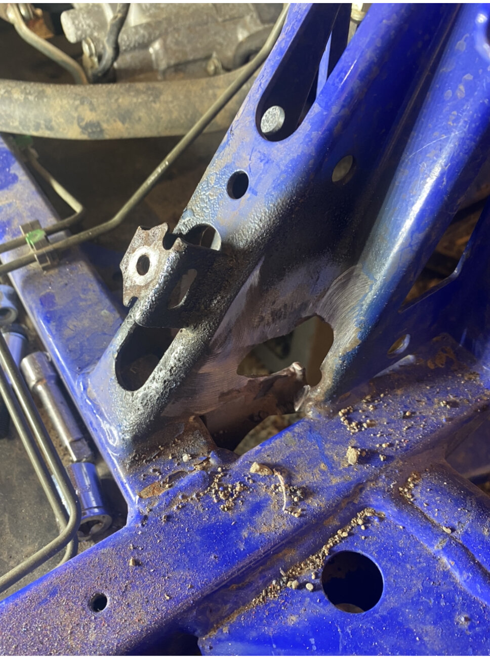

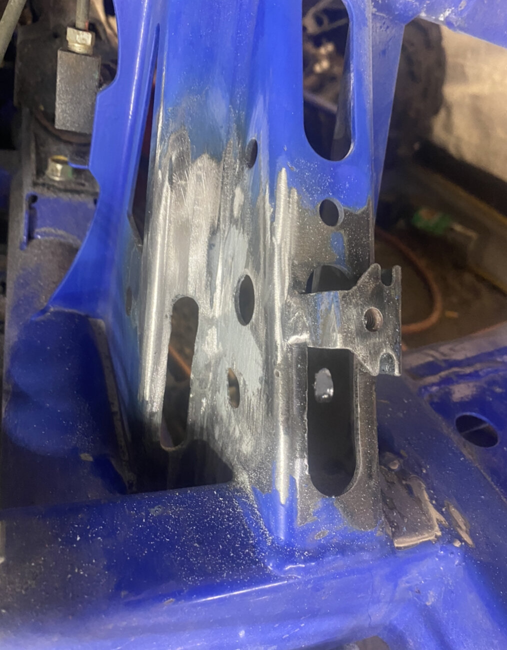

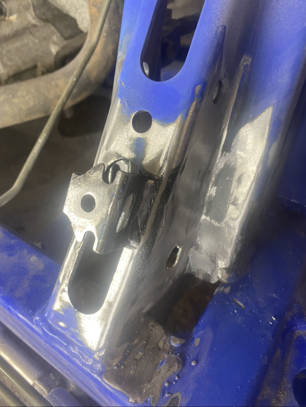

Tomorrow I can get the rear trailing arm in. Got all the steel repaired where it tore out of the frame on both sides.
EED8331D 4AB9 444D AB3C 061BF9B782BF

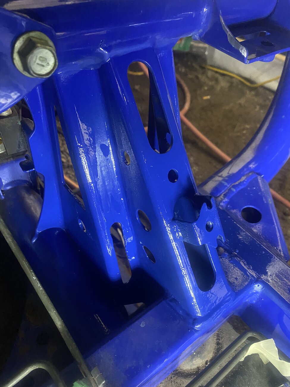

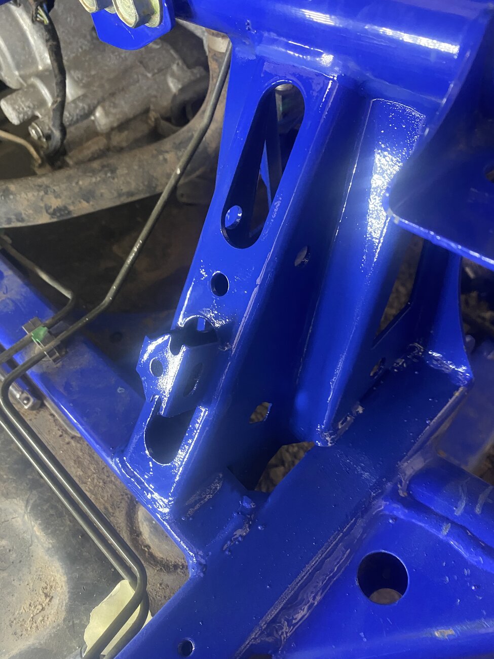

new steel the a light finish coat of fiber fill so it’s a bit smoother.
D4FCD94E A864 41AD 9143 F13AE1A4BB7B
228AC0B2 BDB9 4424 AB4E 749D0CD5C386
D5B36A29 11AD 4396 AFE5 28FB9D92C8D4

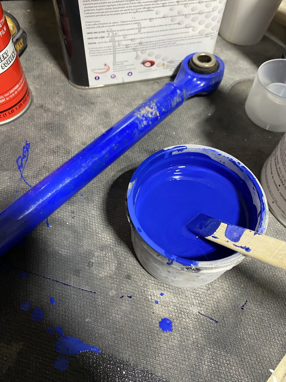

then sealer and paint. Not perfect but got its strength back
8214AF3F 9CD6 43C5 8C48 755FF6FC4C3F
7EC5A852 C385 4037 BBAA 2C77484398C9
57673813 95FE 4AAB 92E6 CE25612DA02A
bent the whole bracket over as well so it took me awhile to get all that heated up and back into position.

Tomorrow I can get the rear trailing arm I. Got all the steel repaired where it tore out of the frame
View attachment 317922View attachment 317921
Bag phone problems. 🤣
pics are up now 👍🏻
You nailed that blue!

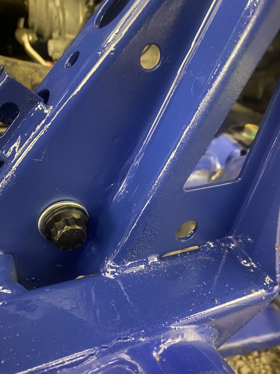

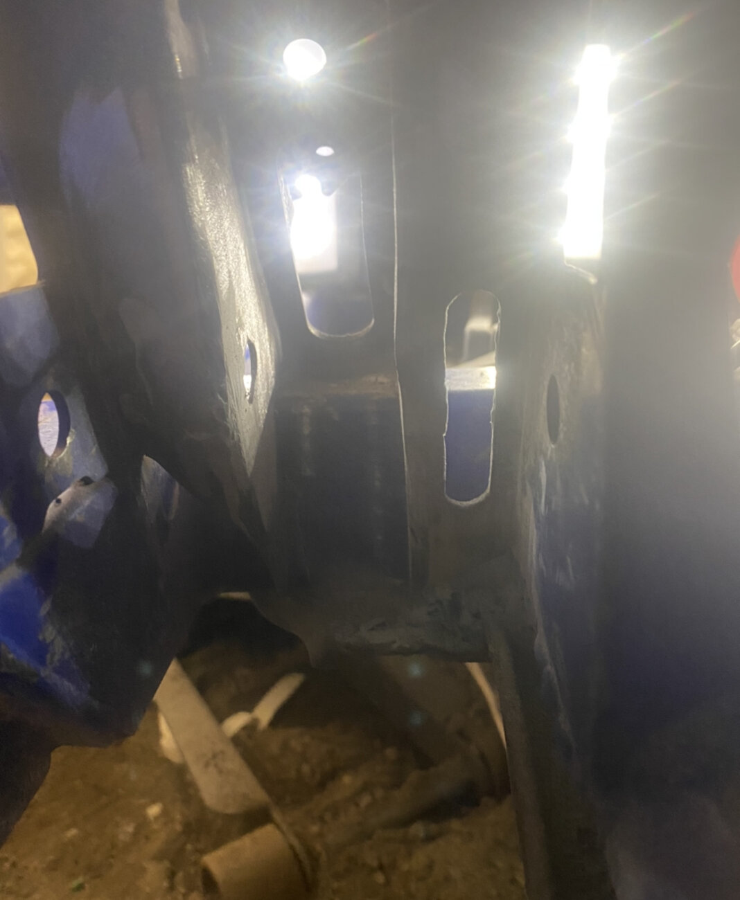

Figured I’d show this too. Probably already good pics but on the website it just showed the trailing arm brackets installed, but they use original arm mount hole then two 2 existing holes fr the new mount. Grabs a lot more surface area.
5767D13B 2A24 4253 AC1E 2C1CF29AD1DA
D8181C76 A910 4272 B878 FE7FE3FC8FFF
