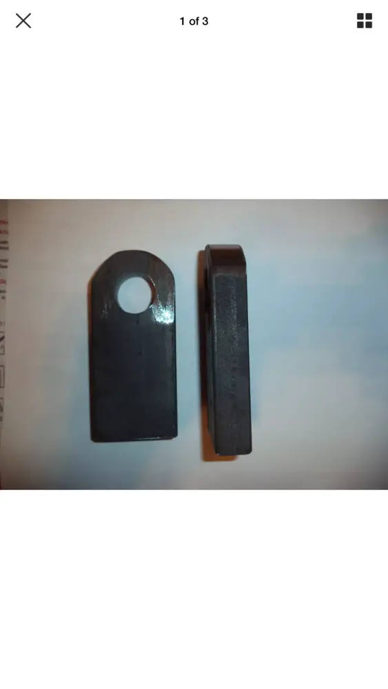

Ok so I decided I wanted a smoothie mount to the bumper without bolts to give a slightly factory look. These are coming.

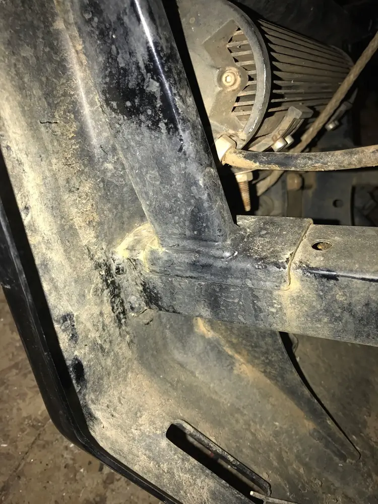

You welding them to the Honda brush bumper? I just wound up going with the D-rings and a plate behind. But then I'm not a body man that can paint either!
No. After examining I noticed there is a major bumper bracket on the back side of the bumper. So I'll cut a rectangle hole in the face of the bumper slide the d-ring mount trough the face and weld to the rear mount as well as the face. It'll be stronger then mounting it to the face 8281311915abd472a97bb29e780827b7
No. After examining I noticed there is a major bumper bracket on the back side of the bumper. So I'll cut a rectangle hole in the face of the bumper slide the d-ring mount trough the face and weld to the rear mount as well as the face. It'll be stronger then mounting it to the face View attachment 30544
That's what I was thinking.. I like it!

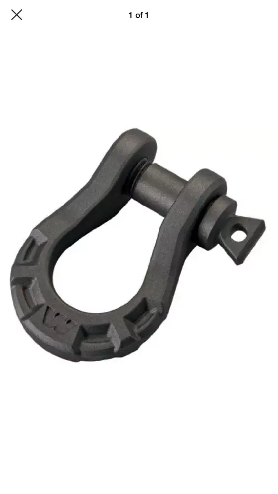

Just found this for the shackle they would look great, match with the hook and everything would be Warn and 18k rated (overkill I know but done with bs) but it's not stainless so decisions. Love the looks! Going to get a set for the tail of the rig too so tough one.
Man even OCD on a hook decision lol.

That's what I'm talking about. A mans gotta have what he wants. That black coating is some kind of anti-rust coating. My stuff hasn't rusted at all and it's be in use for 7 months

That's great information and will seal the deal I'm ordering those I like um. Thank you.
