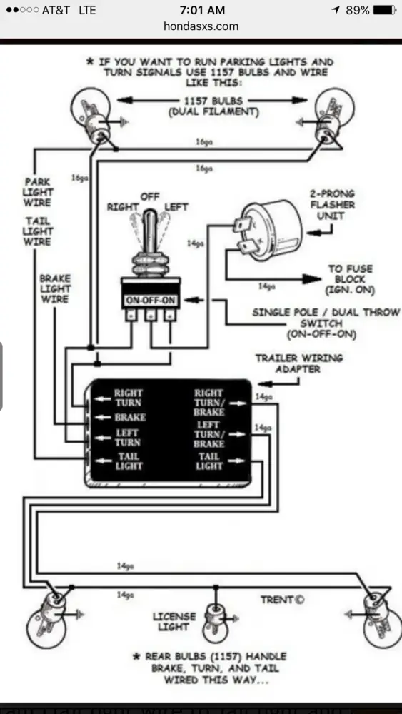

Just the one in my build log. I'll post one of the instructions soon as I get a chance
I looked it up... looks like same number of wires as mine... 5 on the "car" side and 4 on the "trailer" side. should wire up the same.

This is from @LandPioneer (thanks for the great diagram)and shows everything really well. 'This is from a non powered unit but the only difference is adding positive an negative. Definitely cheaper then buying a kit.
Yep I did mine exactly like this and it works perfect... I took a lot of time to make sure I don't have to mess with the wiring again. I put wire loom and electrical tape on everything. It held up great this weekend on an extremely muddy trail ride.
