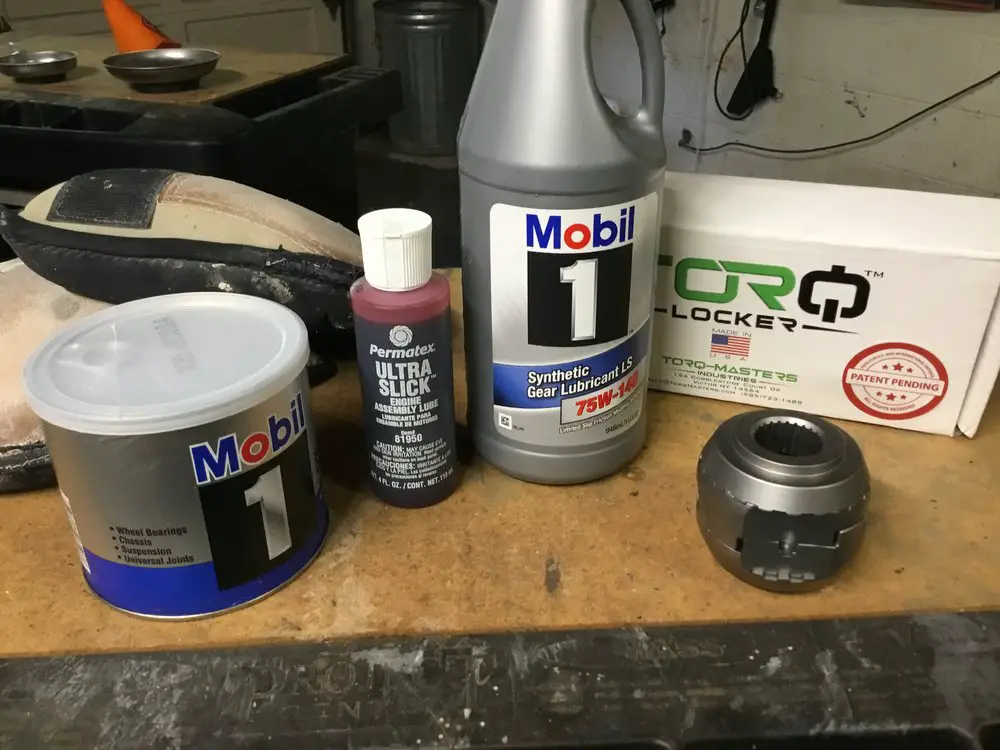

Starting the install, knee pads ready. Question, which would be better... lightly apply synthetic grease to locker..or apply Engine Assembly Lube everywhere during assembly?

View attachment 80310 Starting the install, knee pads ready. Question, which would be better... lightly apply synthetic grease to locker..or apply Engine Assembly Lube everywhere?
I don't recall what the instructions suggest, but I would stick with your gear oil. Anything else you use will change the viscosity of the gear oil once installed.
It's another one that's not too fussy. I definitely noticed 'friendlier' operation with the heavier gear lube.

View attachment 80310 Starting the install, knee pads ready. Question, which would be better... lightly apply synthetic grease to locker..or apply Engine Assembly Lube everywhere during assembly?
The only thing I would mention here, is that Torqmasters made a point of " a very light coat of grease" on the locker components prior to assembly. I didn't do that:oops:, but I've had no issues. Once you fill the diff, it's submerged in gear lube anyways....

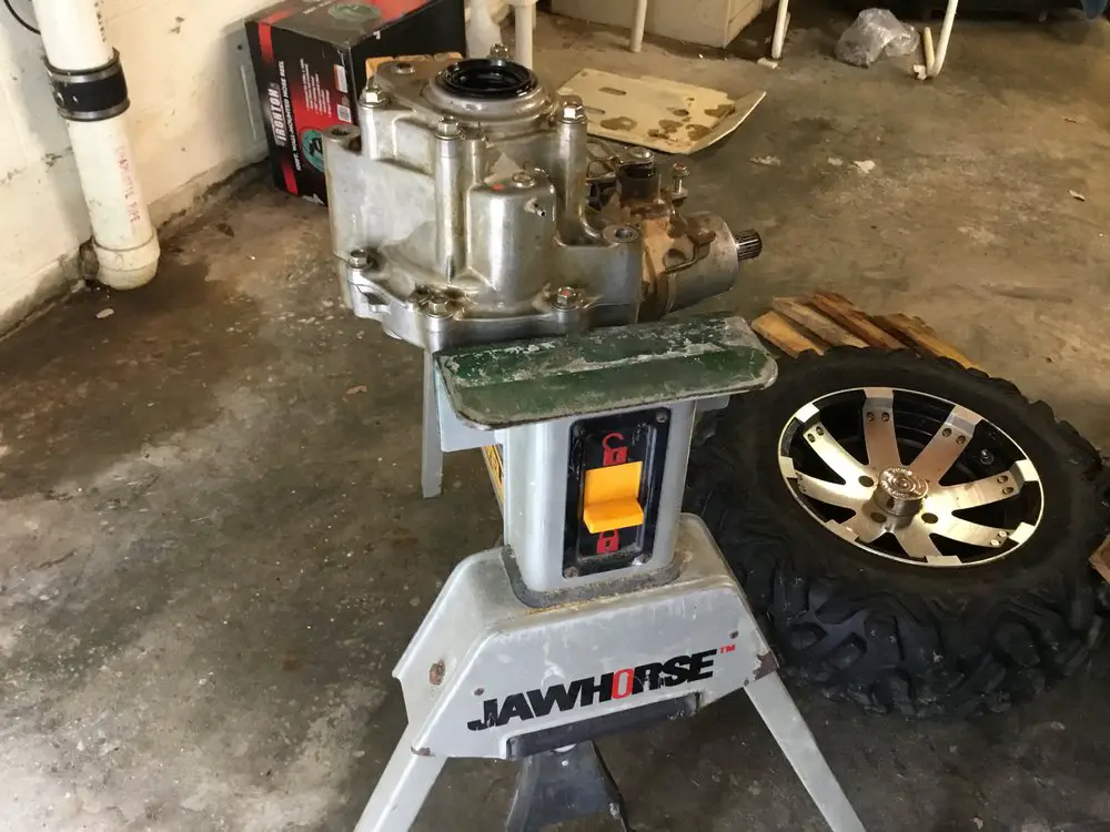

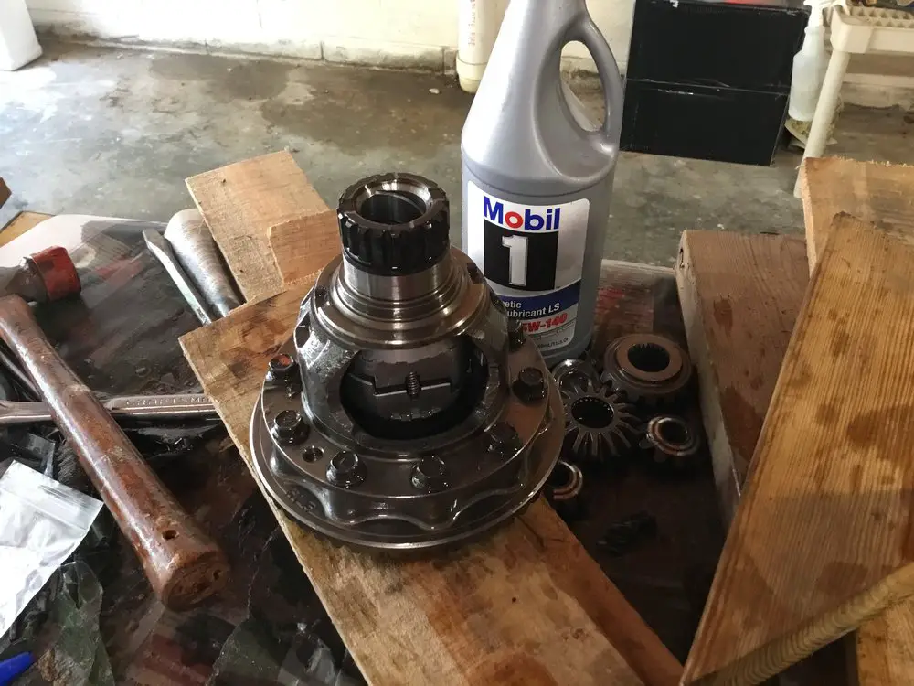

Just unbolted brake line support bolts, Axles came out OK per instructions and zip tied axles around a arms to hold up while working on locker. Steering ball joints untouched.
Locker in, diff. case back together. Had to grind down my larger pin punch for that little retaining pin. Just pre-covered everything on locker with 75-140 gear lube to be used instead of grease,,, kinda messy but nothing dry on start up. Wife came in garage and said “What are you doing, you broke it!!”
Now the fun of putting the P500 back together again...Humpy Dumpty.. Rear drive shaft rubber boot a pita, keeping o-ring in place. Everyones posts here helped greatly doing the job. Honda SxS forum is the best.
ALL DONE! (And yes, found the 4wd cable spring on floor, had to take tire off and fix, uugh!). Like how the 4wd re-centers the power steering. Clicks not audible from cab with heavier oil. Updated Locker status poll to add INSTALLED !

C
Chooglin
Locker in, case together. I just pre-covered everything on locker with 75-140 gear lube to be used, kinda messy but nothing dry on start up. Drive axle separated both ends on diff. removal, good opportunity to clean and grease both ends. Now the fun of putting the P500 back together again...Humpy Dumpty..
