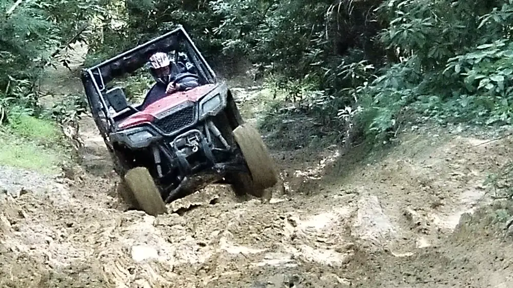

Here's the video the screen shots came from, but first a bit of background story..:)
This is a short video of our ride at Spearhead last wknd. The very first mud hole I drove into, I got us 'high centered' and all four wheels were just paddling water around... so smarty pants (Amy- aka 'the Princess') points the camera at me and says "John got us stuck". So I made her get it un-stuck, while I filmed Miss Smarty-Pants. She did fantastic- first time she ever did anything like that! I couldn't see her face, but I knew she was sweatin bullets doin her best to not screw up! She also did all the filming for the day, holding the camera in one hand, and hangin on for dear life with the other, and never dropped the camera, and got good pictures all day.
We had a blast!
John got us stuck!.mp4

@jay_man81 Jason you did a excellent job with this video. In my opinion, you covered everthing. The only big question now is , how does it truly feel without PS. As some of you without PS install the locker , I am sure we will all have the answer to that question.
Also would like to thank you for mentioning me and @JWB in the video , along with the others that had a big part in this all coming to reality............again , you really did a great job with this video !
You nailed it Choog! My thanks all round!

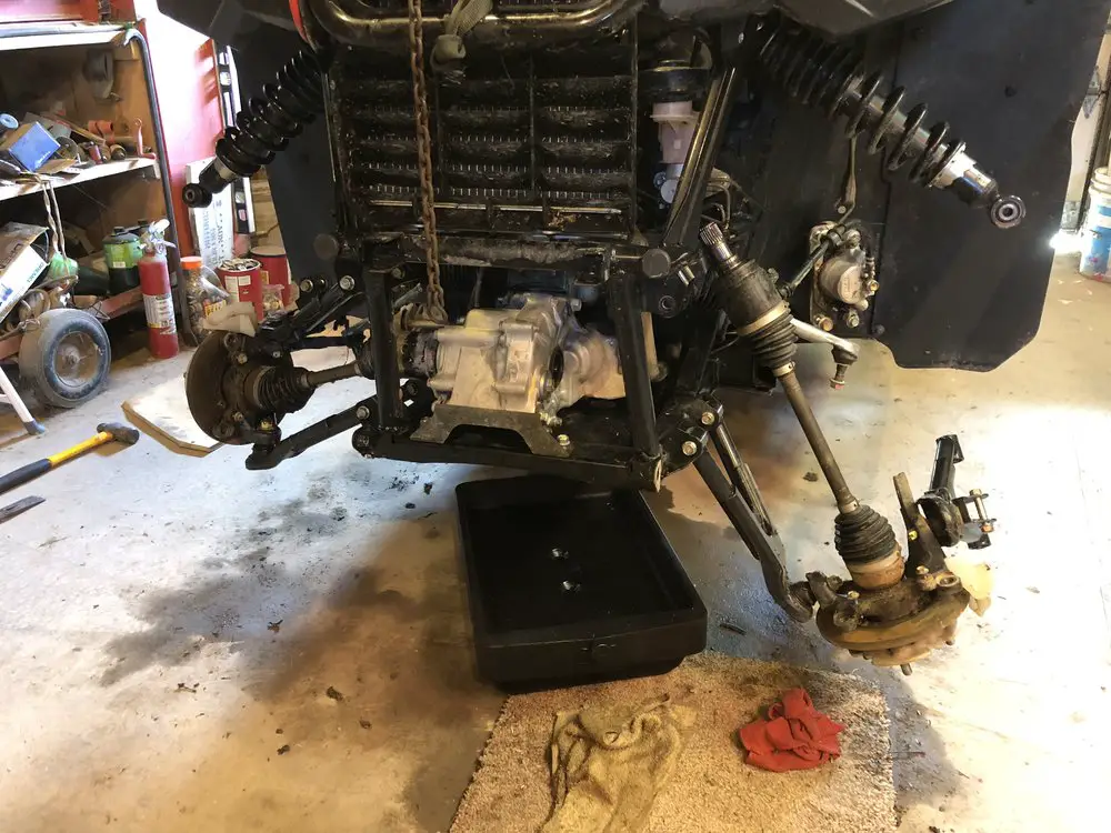

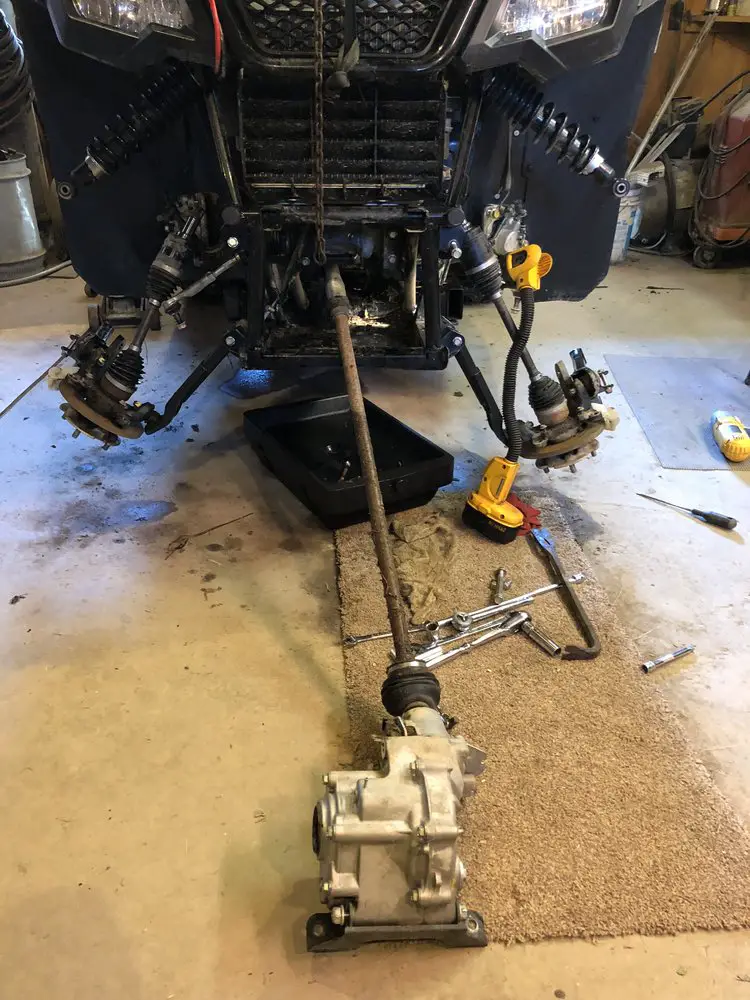

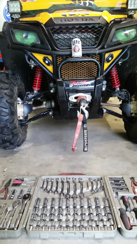

Just a NOTE for those that will be doing this. The bolts holes that I am pointing at in the pics , these 2 nuts are welded to the frame , you should only need to use a socket on the bolts. I used a cheater bar on the nuts and broke the welds. Not really a big deal , but just letting you all know !
20180703 204842 20180703 204903
G
Gassygordo
Oct 16, 2017
302
1,025
Fillmore, NY
View attachment 80165 View attachment 80166
Sorry! I should have mentioned that! Be careful going back in also, easy to crossthread, but you shouldn't have a problem with that. ;-) Also, when you go to set the dif. back in place, I stuffed a shop towel in the end of the shaft so I could keep any crud I missed out of the splines. A little awkward, but had to hold the shaft up until it was in far enough so I could slide the top mounting bolt thru the dif. Then reached down through the seat hole, removed the towel,greased the splines, then gasped the end of the shaft and pushed toward the front. The dif pivots just enough on the top mounting bolt to clear the engine shaft and slid together nicely. No need to disturb the wife. ;-)
