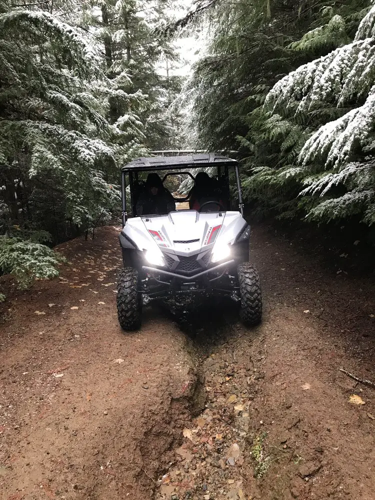

Left your coats at home didn't cha!?!?:cool:
BTW... a roll of saran wrap around the cage would have saved your a$$!!!(Just a layer to block wind and water).
Ya ya. Wasn't going to stop at the store with dealer rig though. Left the house at 6:30 still not feeling great from night before to be at dealer at 8am. Didn't think to bring anything not even helmets for a test drive but it's idaho lol. You know us we'll go anyways, froze our asses off for 3 hours. Ang never b****ed, I appreciate that tough woman, most would've complained especially at 50mph snowing,that was really really bad with not even a deflector!

First drive in a Wolverine x4 and we were allowed to actually run it hard where we normally ride so got a damn good feel. Put 3 hours in it on various terrains from pavement to very tight goat trails. This wasn't some setup test course it was real N. Idaho quad and dirt bike trails.
