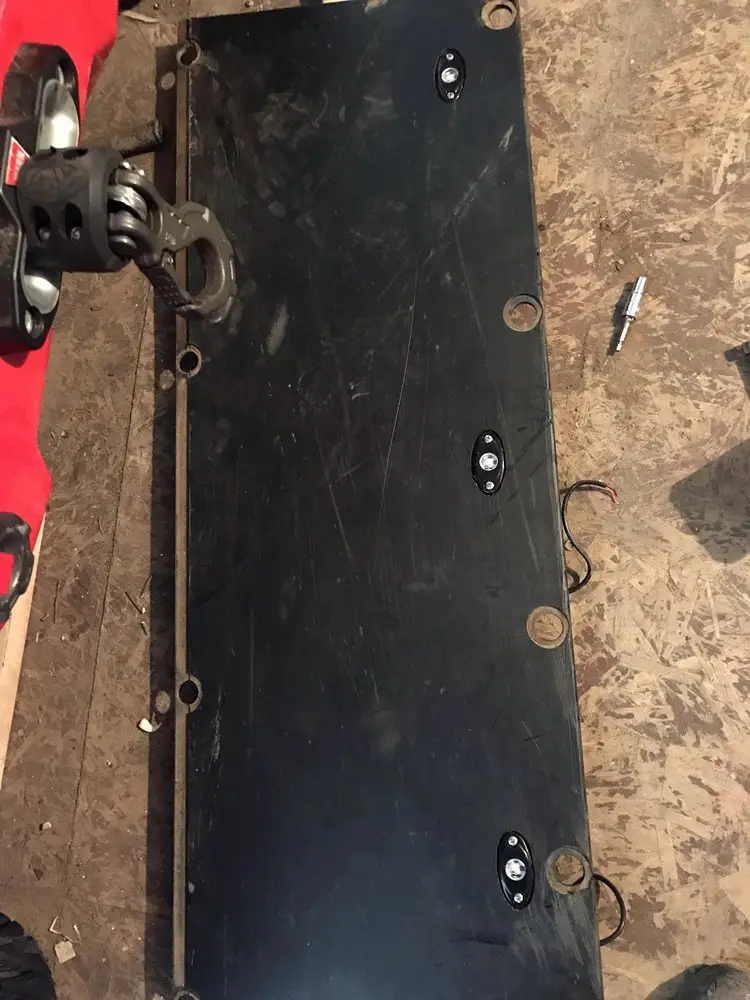

While out decided to finally get in the side blue underglow. Want an even light all the way around this thing. We have a total of 32 blue Cree 9watt rock lights to do this.
Each skid plate gets 3 to make the pattern continue fairly even. But being us and where we ride they can't be just bolted to the bottom because function is number one and fun stuff second. If you simply drilled a hole for light it wouldn't throw flooded light so...here's what we did

Trace the light onto the skid and cut the hole to start

Each light was super tight in the panel afterwards but fits pretty flush inside the skids.
Being in the skid I still want it to take a hit and not come through. There is a reason we bought skids with no drains, I don't want s*** coming through!
I simply bolted the lights to the steel plate then used two part urethane to glue plate down and used 1/2 self tappers. Very solid.

When flipped over you now have rock lights in the skid. But not good enough because sticks and rocks will be hitting these. My rig is no trailer queen! Any edge as issues I like stuff flush otherwise it becomes litter.
So "masked" off the led lens with a penny and pumped 2-part urethane into the gap and across the whole light. I do a quick spray of a wax and grease remover spray after it's spread across to smooth even more.

Alright both side panels done with rock lights inside the material totally encased. Totally flush. These will take a hit! Nothing will enter the cabin because of them and most importantly 6 more rock lights installed only 12 more to go.
