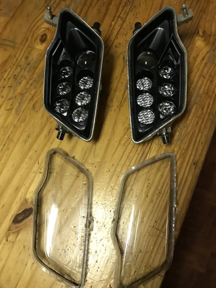

Pulling the covers off takes lots of heat and
IMG 8062
patience
Reactions: Dp5hunter
322,956
C9307a5626e47616a8391106a31ac28c15b61d5bd5e4f429a42fadd257043bc3
Just pulled everything apart to show everything inside. Same urethane that holds the lens in holds the inside cover. It's some tough stuff. @joeymt33 I figured you'd want to see inside. I know you like playing with LED's

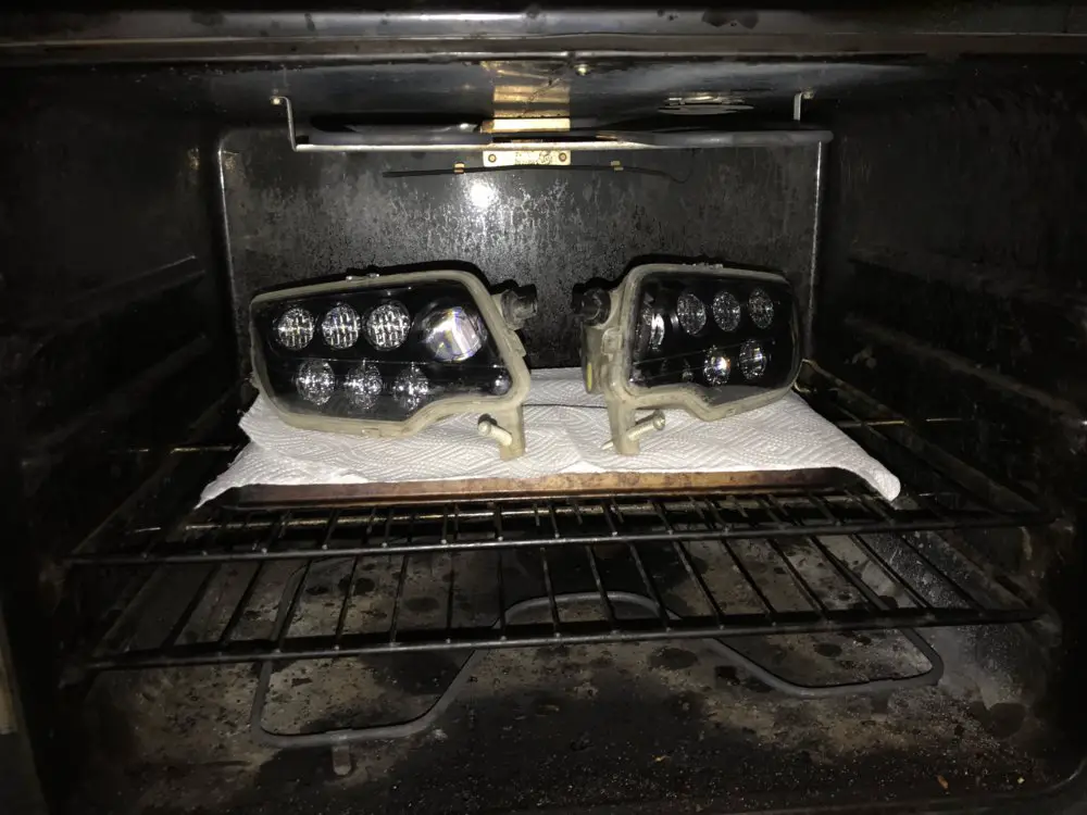

Any higher would it warp or distort?
I think you could possibly go 230 but if the plastics get too soft you couldn't pry against it

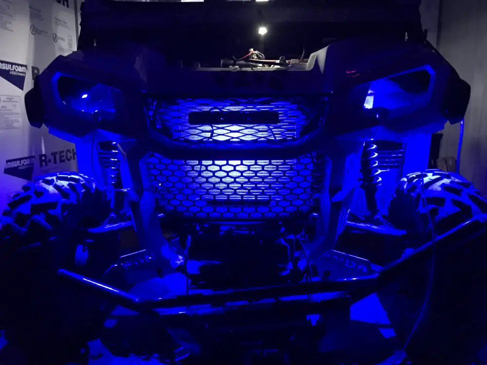

@tigarmark you're going to really like what's going on with the headlights shortly I think it may just knock your socks off. @drfubar may not like "certain " things about them but there's something for him too and there is a "Drf/Lowes theme" coming out of the machine in the next week. I think I can make even this grumpy ol fart smile lol.
Big changes. It's winter here and I've got heat and lights so lots of stuff in the works both senseless acts of indulgence to people who don't appreciate fun (hint hint) and also many creature comforts, protections and abilities on the way.
Minus probably 2-3 weekends I've got 4 months of build before riding starts so cramming lots of ideas at it pretty excited to finally get some work done.
